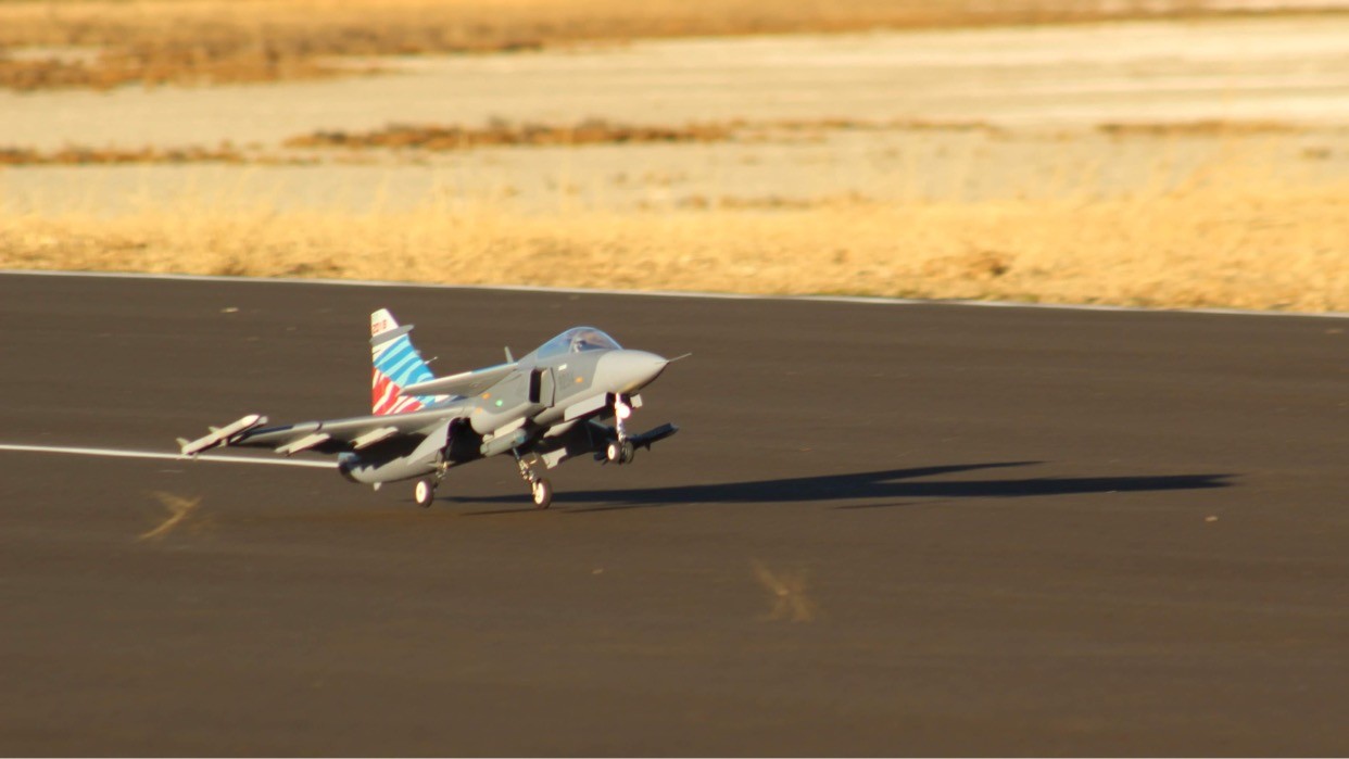

  • Originally posted by kallend View Post
    That doesn't look at all like high alpha. That looks like it's about to land.
    Yes it is a landing mode - ironically to land with less alpha than you otherwise could.

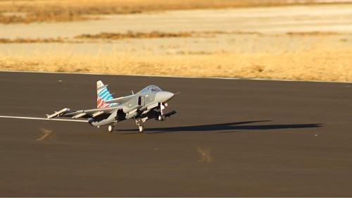

        • Originally posted by JLambCWU View Post
          4th flight LIVE High Alpha/Slow flight demo.
          This is my 4th flight on the model that I did LIVE on FB demonstrating the slow flight/High Alpha capabilities of the model at the stock CG location.
          I also demonstrate the “flap” function I have set up on my canards using only 6 channels.
          With almost 4000 views on FB already, I took the time to upload it to YouTube to be able to share it. UNFORTUNATELY this means there is a pretty low quality/frame rate off the live feed recording.
          This is rocking the 4400mah 70C Roaring Top from RCJetWerx that allow for balancing on the factory CG marks on the jet, while also giving great power into the vertical out of High Alpha passes.
          Specs: Capacity: 4400 mAh Voltage: 6S / 6 Cell / 22.2 V Discharge Rate: 70C Weight (including wire, plug & case): 700 g Dimensions (mm): 45 x 44 x 157 (H x W x L) Balance Plug: JST-XH Discharge Plug: EC5
          Very impressive! That is WITHOUT DOUBT the Definitive high alpha demonstration on the Gripen model. The way you can hold an even height and steady show line in full control. I have not seen a better "low and slow" demo to date. Its very interesting that you did it at the factory CG location. From everything I have seen so far I'd say you clearly nailed the control set up for that type of flying“
                Click image for larger version Name:	CF98BBDF-19C1-462D-9E84-E6937E69990D.jpeg Views:	0 Size:	68.0 KB ID:	289331
                Well being as the MODEL flies VERY well with my setup as shown in my video.
                Being also as the REAL aircraft ALSO lands this way with canards deflected up, I HIGHLY recommend people try my setup with the MODEL.

                      • Well, you are claiming to have made the 'ultimate high alpha demo' which uses a CG setup that is not optimal as the canards need to be pitched up for the jet to hold there.
                        Mine still has that problem too as I couldn't shift CG far aft enough (now that I have a Jetfan, that is going to change).
                        Since you mixed the 'canard pitch-up trim' with the high alpha demo video, I think it is worth addressing so as not to cause confusion. ;)

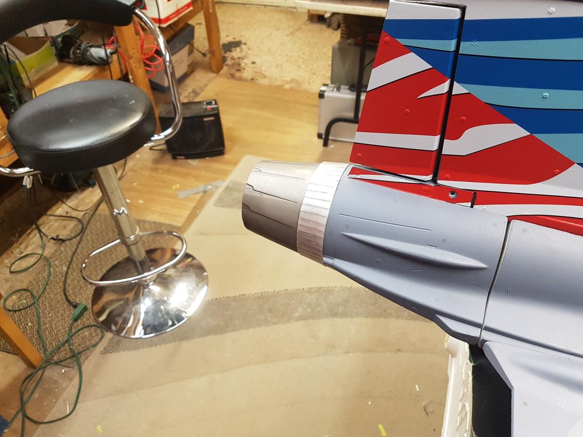

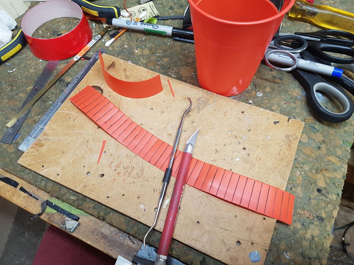

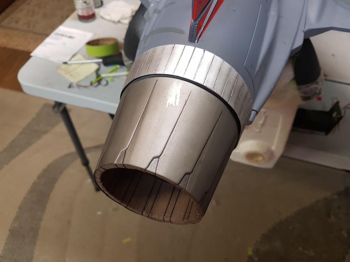

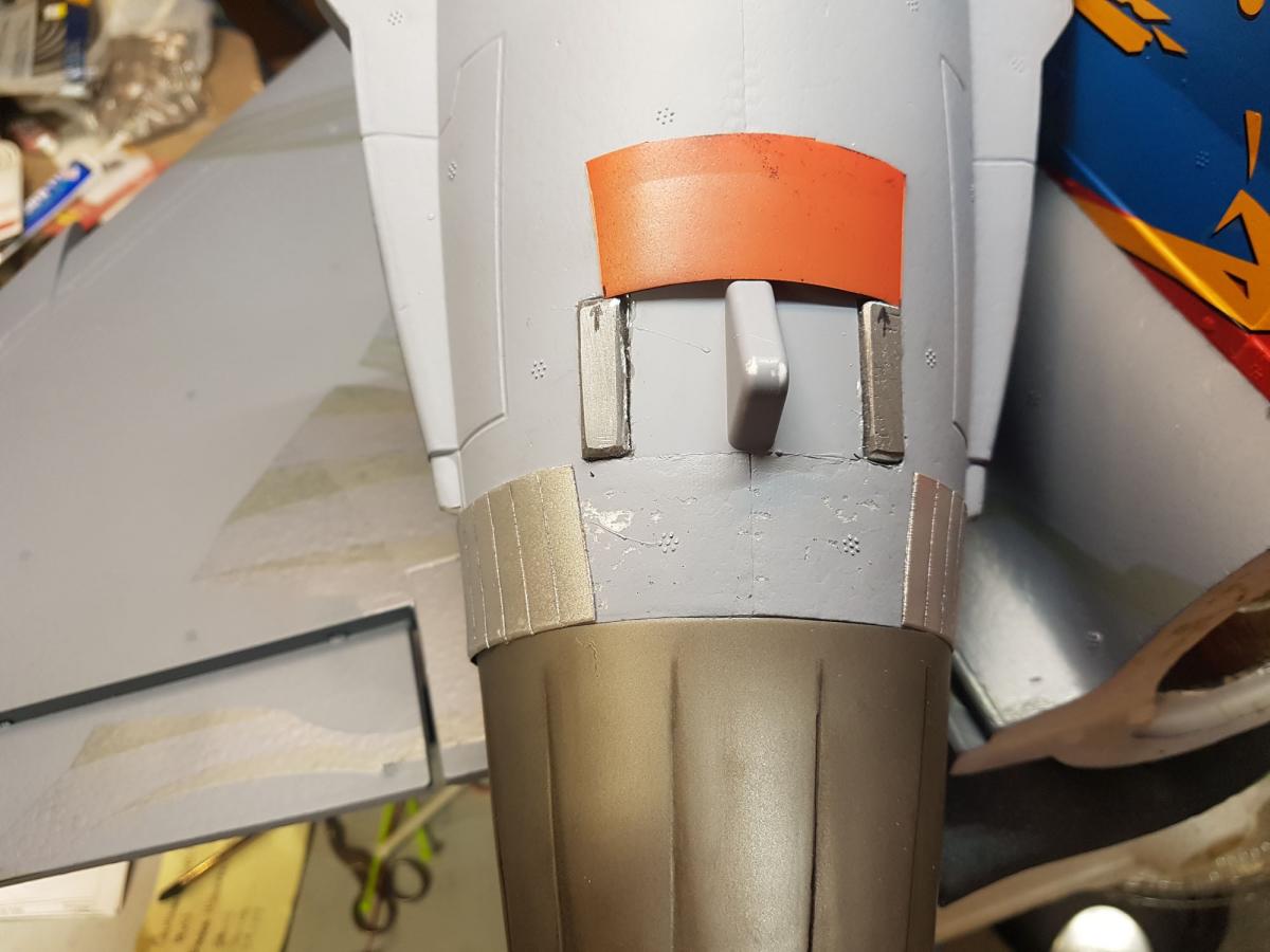

                                • As the ring in front of the exhaust nozzle was omitted by Freewing I made one from a Red Solo Cup (there may be a song). Lines were scribed in the plastic and I sprayed it with a metallic finish although most photos show it the fuselage colour. The circumference was a little small so an additional piece was needed in the bottom. The silver blocks in the photo are the 34 grams of lead I added for the first flights.
                                  Tom
                                  • Originally posted by Pogo View Post
                                    Tom
                                    That looks good. It's amazing what you can do with common materials. My AL-37 is flying around with two margarine containers as fake nozzle extensions. :-)

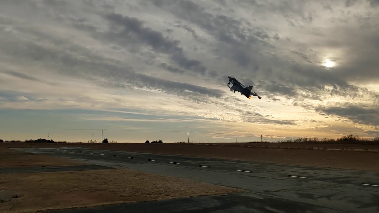

                                    • Full flight at high alpha. Well, pretty much.. This flight was with the gyro switched off because of the light wind this evening. I wanted to see how it did without stabilization. CG at 13 mm behind the factory CG. Gens Ace 5000 45C. This was flight number 42 on the Gripen. My other planes are feeling neglected...
                                      • Originally posted by HaroldAnderson View Post
                                        Great job
                                        • Great job indeed!
                                          Why the landing gear down though?
