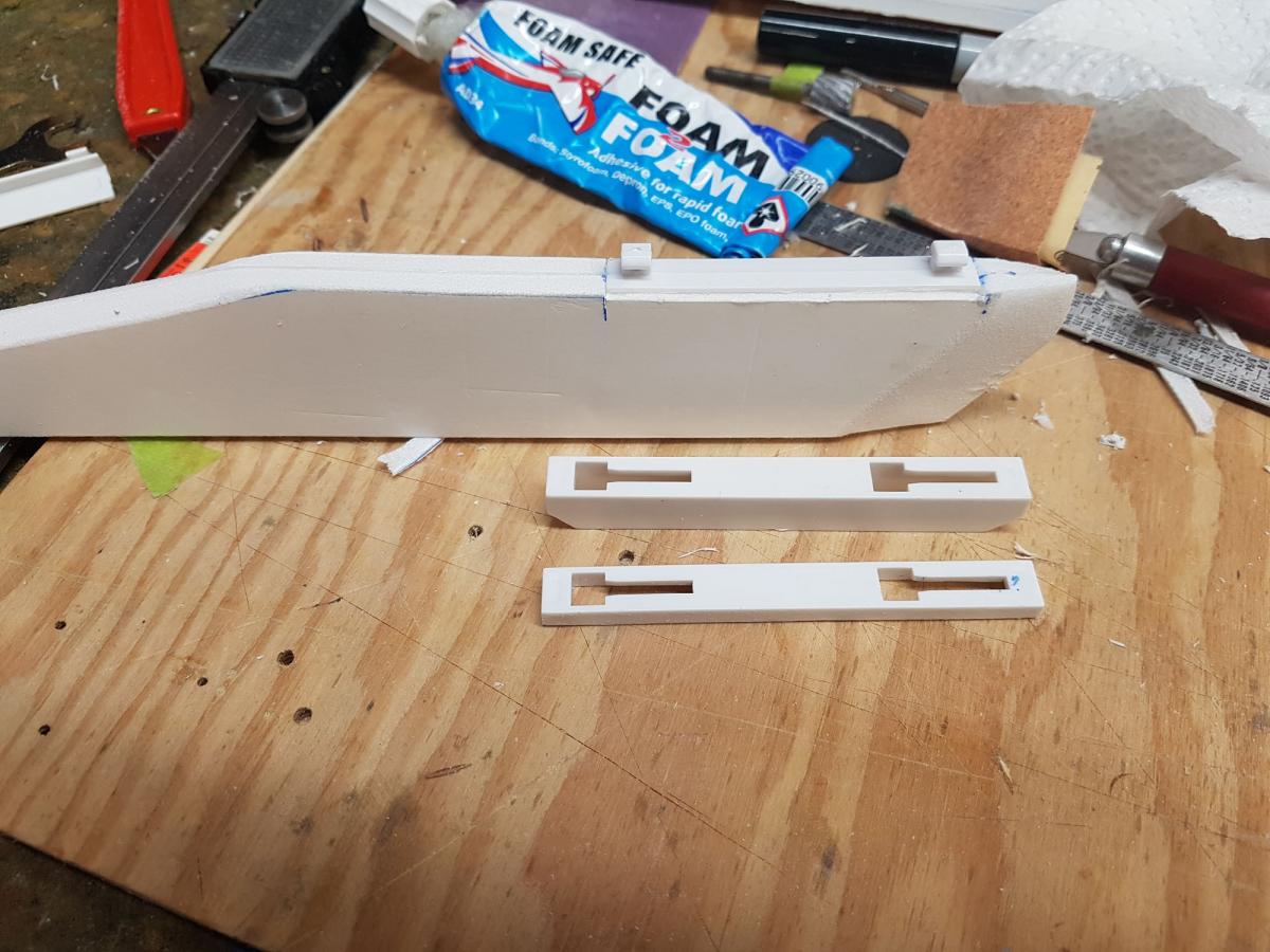

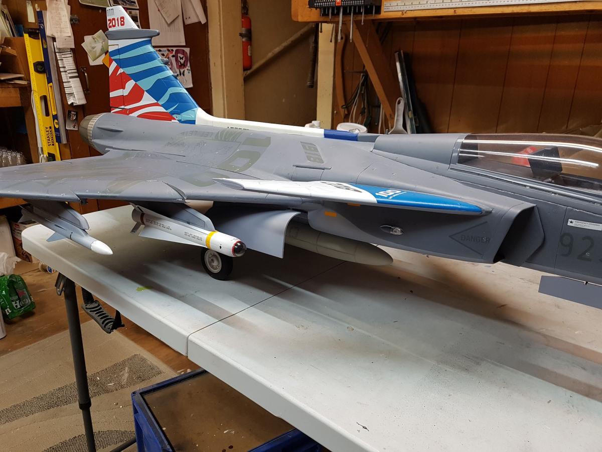

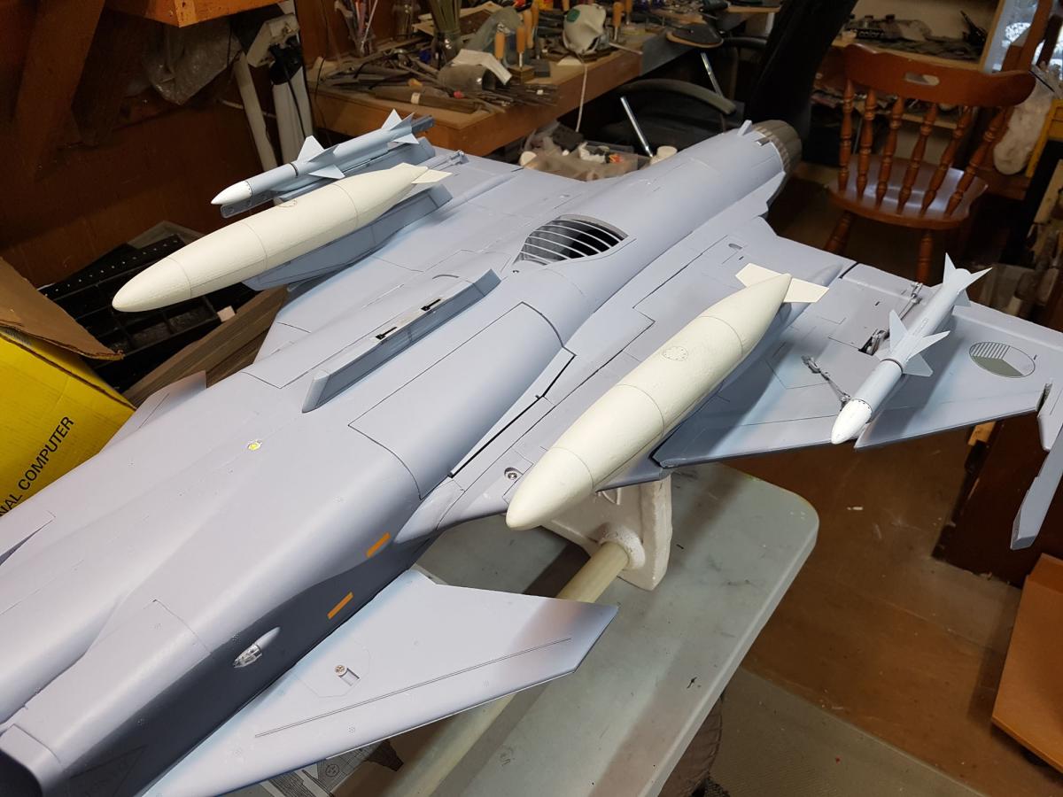

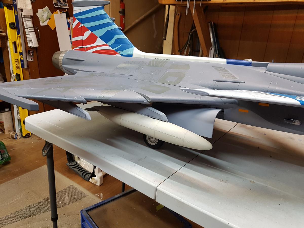

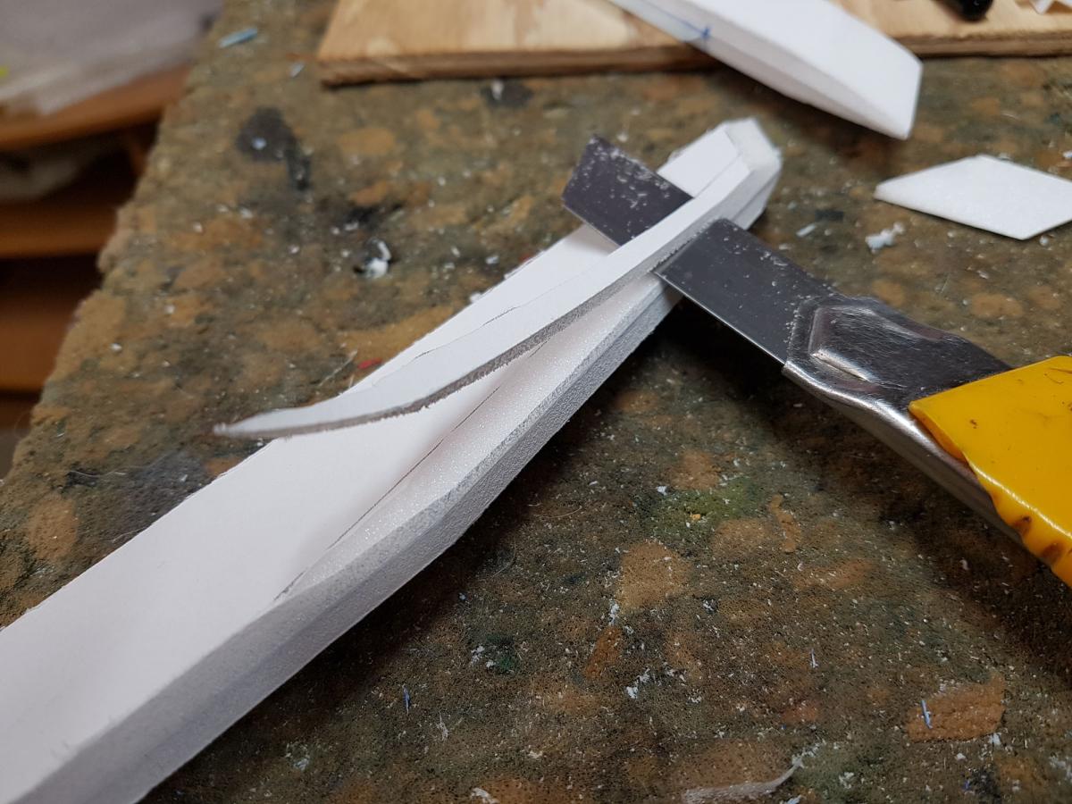

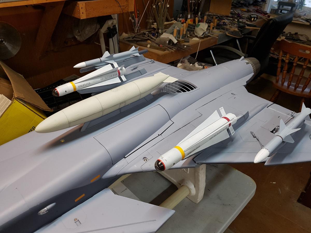

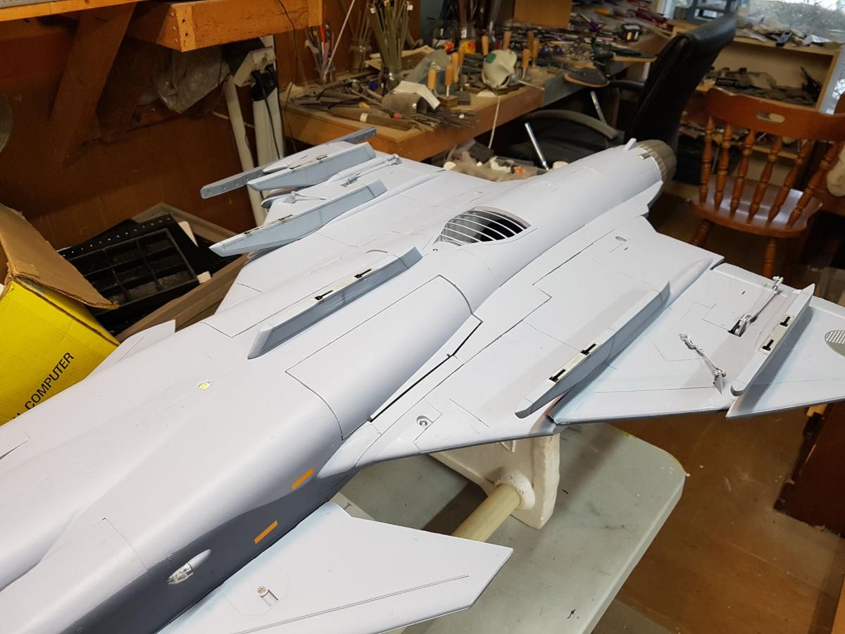

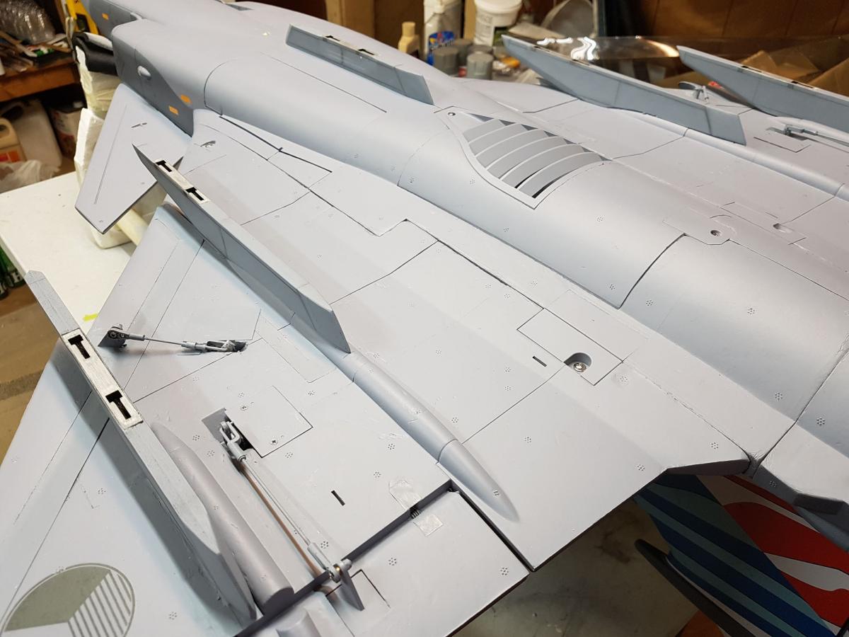

I've added pylons to the Gripen using 5mm paper-covered foam board, doubled up, shaped and then spackled. It's nice to work with and the paper finishes easily. Freewing hardware was used to hang the "stores" and although a bit of a pain to install makes swapping things around in different configurations simple and secure. The fuel tanks are from the L-39, my A-10 is sharing it's Mavericks and the Meteors are from the F-15 weapons set.
One thing though- the outer pylons should be on top of the fairings (like the inner ones) but the LE flap horns were in the way. I wasn't planning far enough ahead, obviously...d'oh!

Cool with weapon. Did you fly with the LE Flap?I've added pylons to the Gripen using 5mm paper-covered foam board, doubled up, shaped and then spackled. It's nice to work with and the paper finishes easily. Freewing hardware was used to hang the "stores" and although a bit of a pain to install makes swapping things around in different configurations simple and secure. The fuel tanks are from the L-39, my A-10 is sharing it's Mavericks and the Meteors are from the F-15 weapons set.
