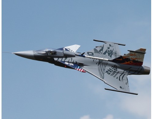

      4 more flights with smoke on the swedish queen, videos coming... soon enough ;)
      I seriously wonder what went wrong at the factory... the jet was supposed to look like this:
      Click image for larger version  Name:	FWJAS39P1-500x390.jpg Views:	8 Size:	25.0 KB ID:	290882
      Instead we got jets that we can't barely tell decal apart from fuselage grey... :'(
                Oh wow!! If mine look liked that I wouldn't be considering painting it.... I guess they got their greys mixed up on the waterslide decals.
