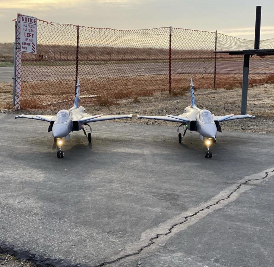

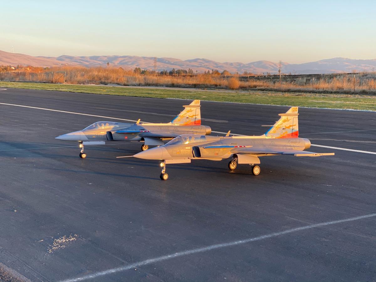

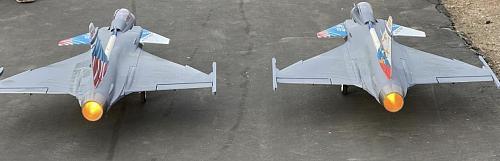

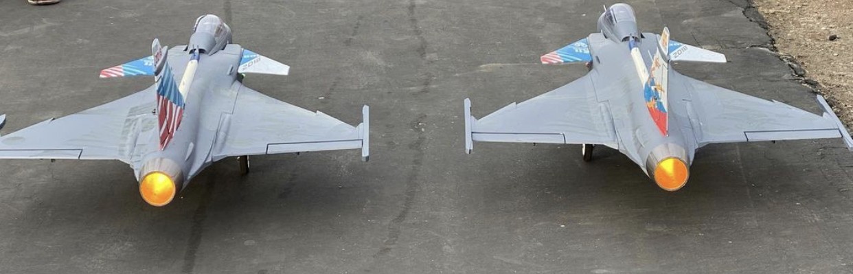

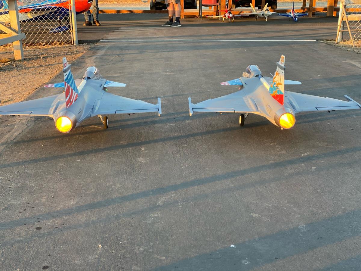

                    I have a handful of flights on mine now and love it! Flown it with 6s 65c 5000 packs and didnt care for how heavy it felt. Switched to 6s 30c 5000 packs and much more to my liking!! Plane is fast stable and a joy to land! Added a little down on canards, evened out and lowered the elevon throws as well. No good video yet but here are some pix!
ID:	290524Click image for larger version
ID:	290525Click image for larger version
ID:	290526Click image for larger version
