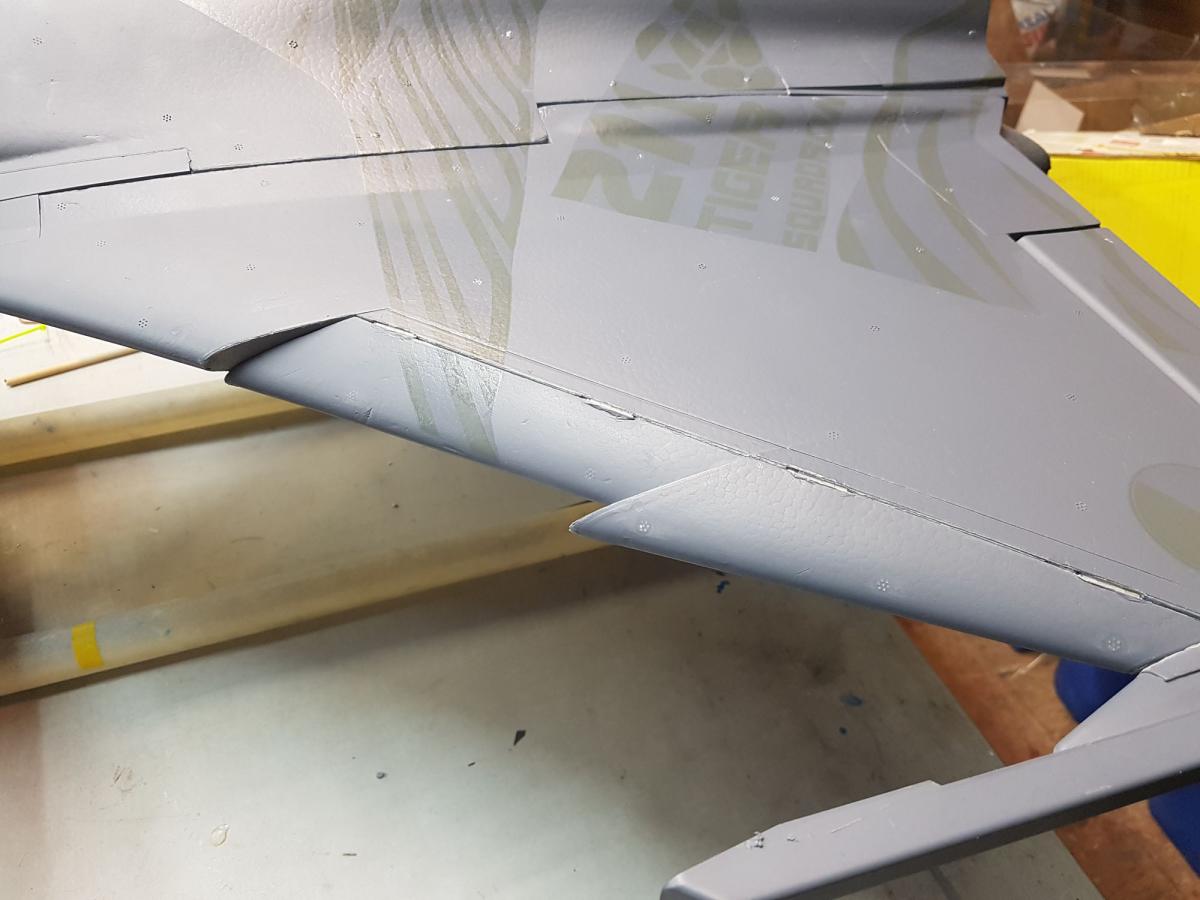

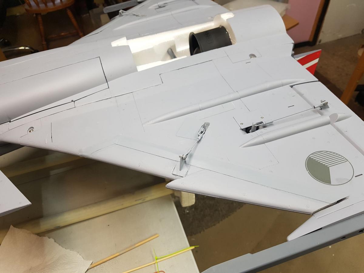

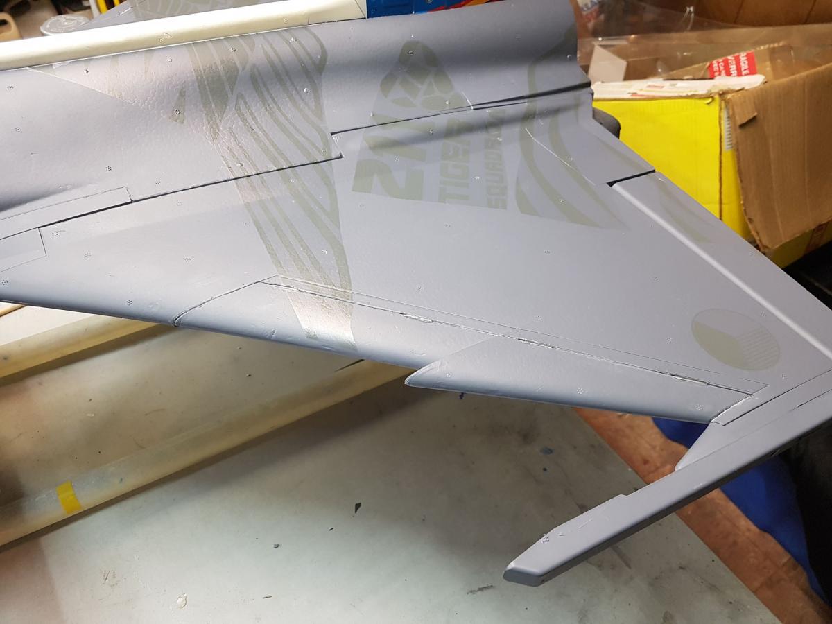

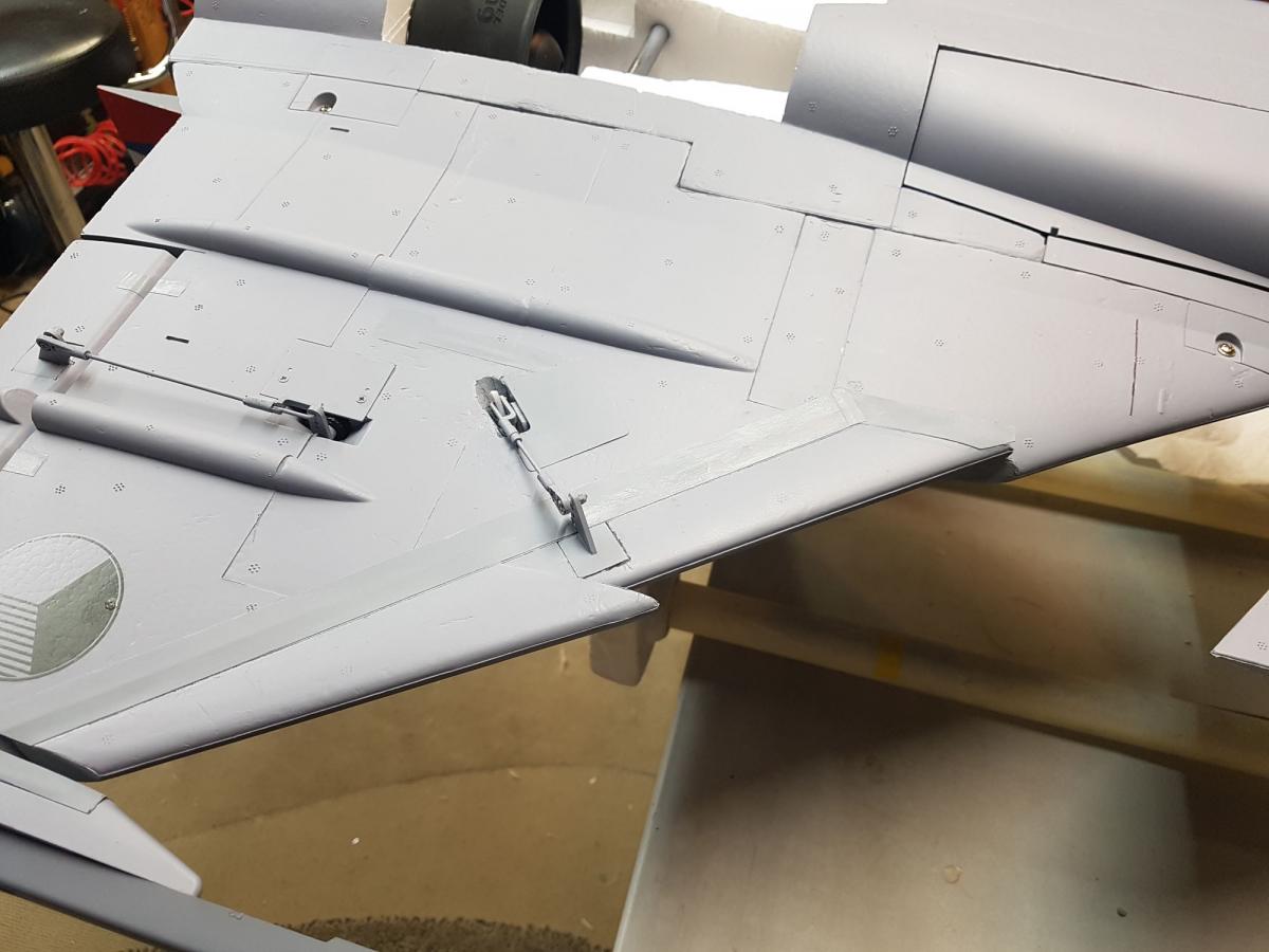

                              Well it took longer than I'd thought (go figure) but the leading edge flaps are done. Thin plastic from a Xmas wrap box was used to cover the bottom wing gaps- these slide back over the wing as the flap comes down. I have them on a 3 position switch and deployment is slowed to 2 seconds- flight modes are also being used, allowing for separate trims in each position (Hugh W. will approve :).
                              Weight gain is about 20 grams per wing- haven't re-checked the CG yet but may be able to remove most of the lead added for the maiden flights.
                              I'm really looking forward to trying the flaps out in flight, but that will probably have to wait 'till spring. Now on to the wing pylons...
                              Merry Christmas all!
                              Tom

                                Looks great, looking forward to hear the results!
