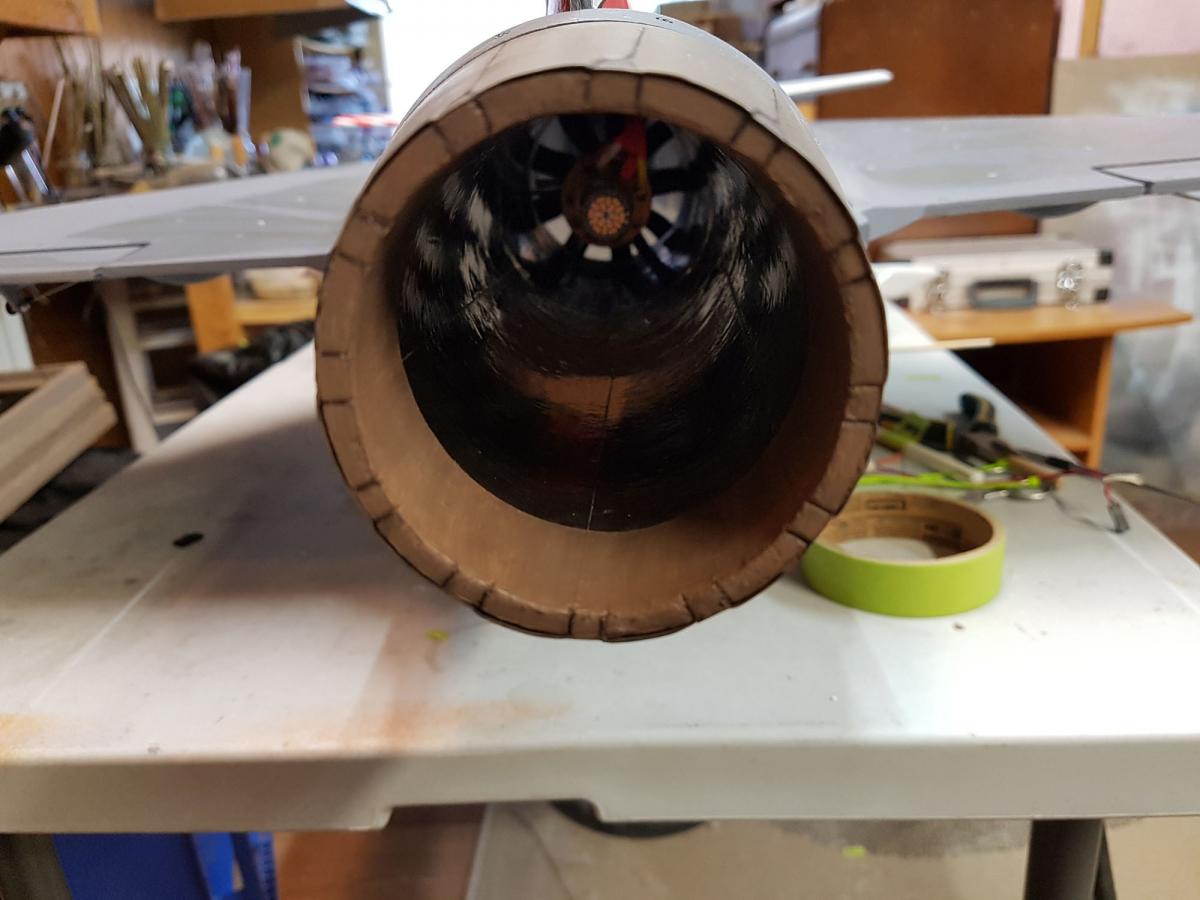

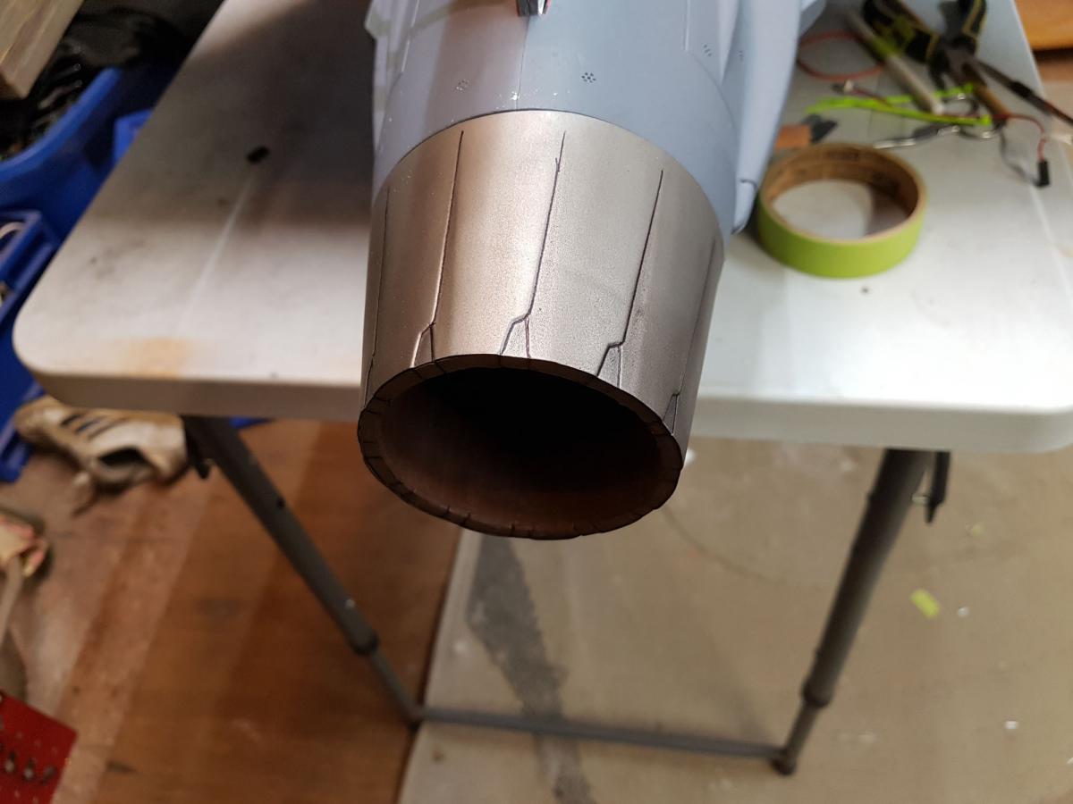

                      A battery placed in the available space adds to nose weight, not tail weight. The bigger the battery, the more nose heavy it is and the more tail weight you'll need to balance it properly.
                      Did you see my heavy nozzle? It's a way of adding tailweight (up to 120g) without affecting the appearance (in fact it probably improves it)
                      This is what "kallend" said.
                          Sorry, missed that reference.

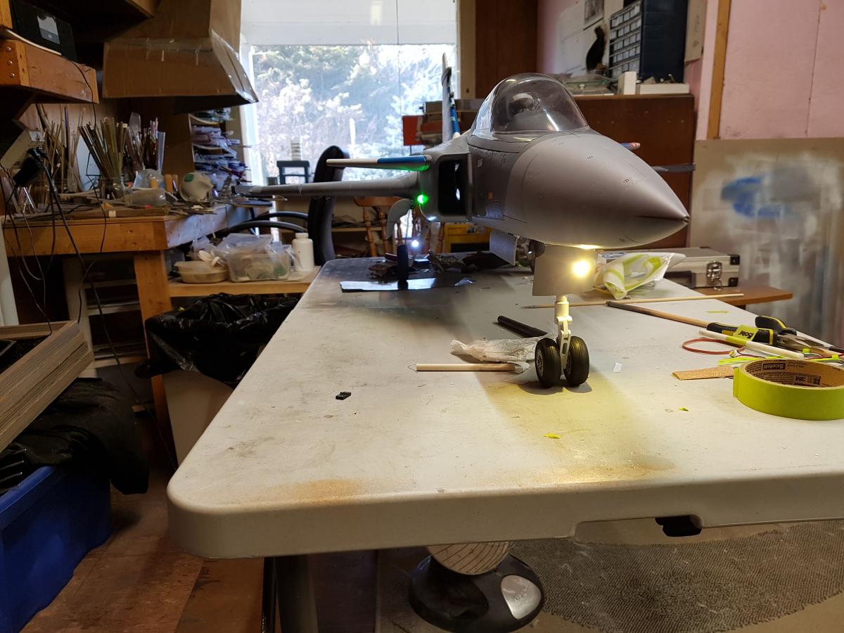

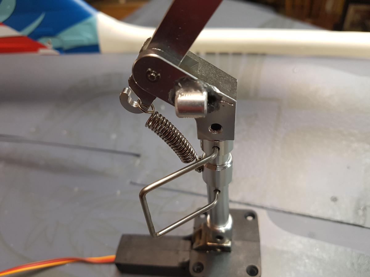

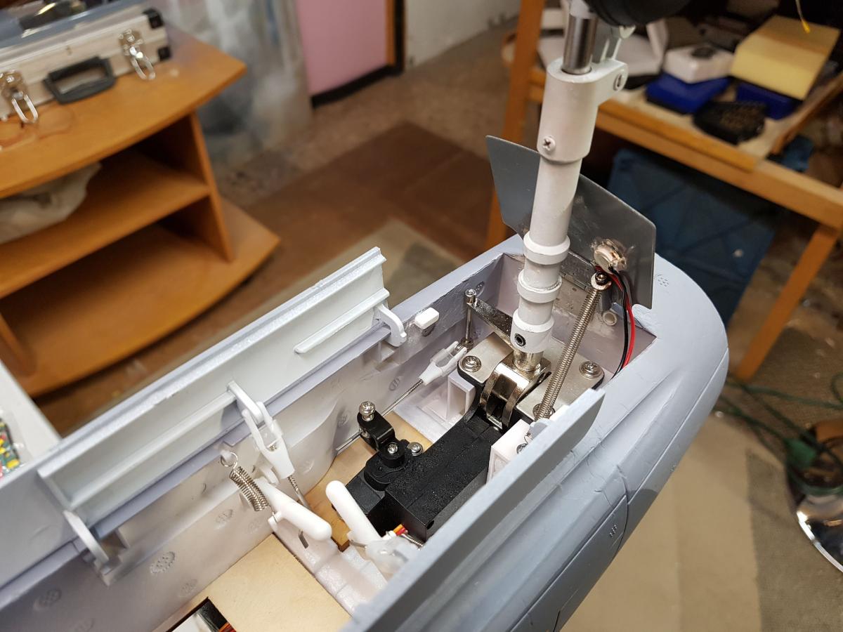

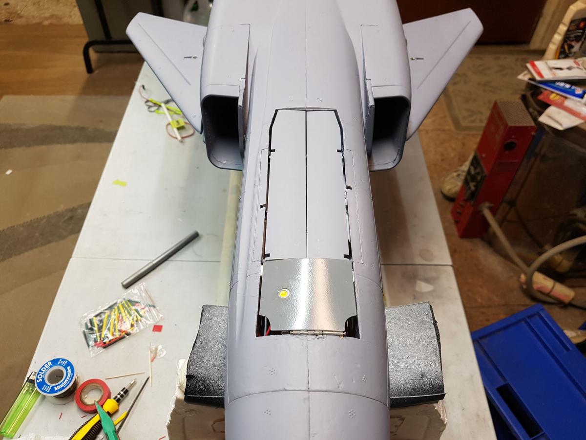

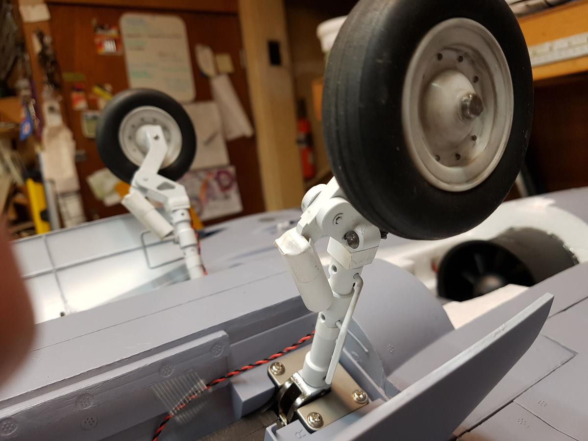

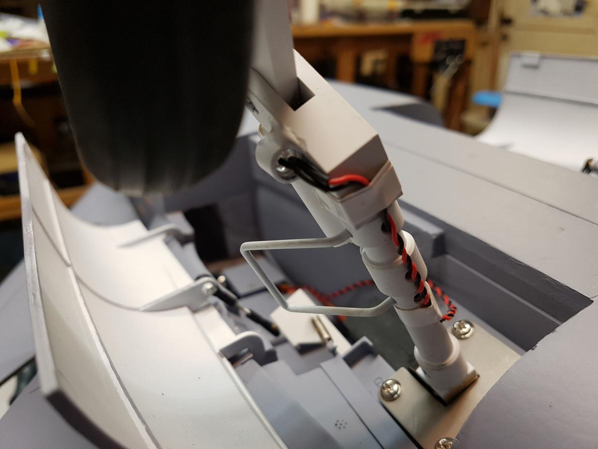

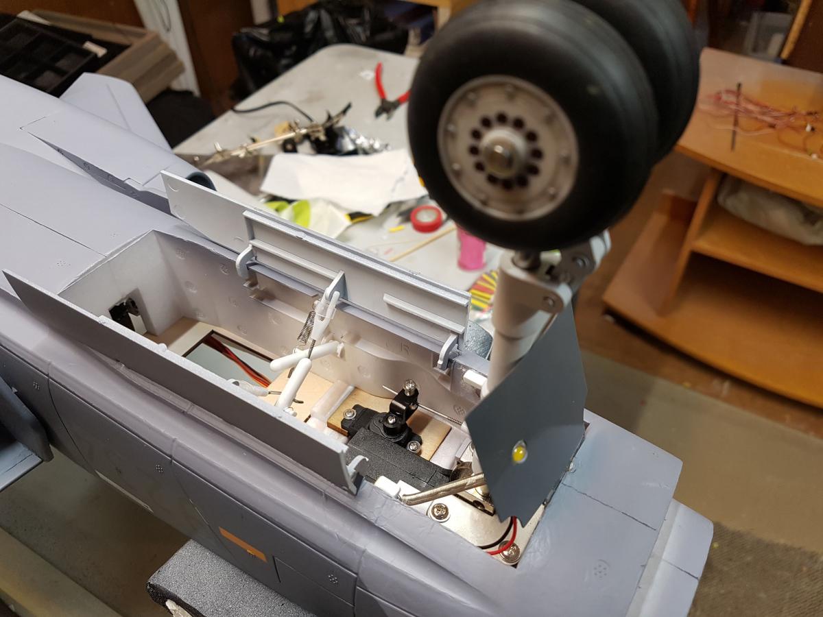

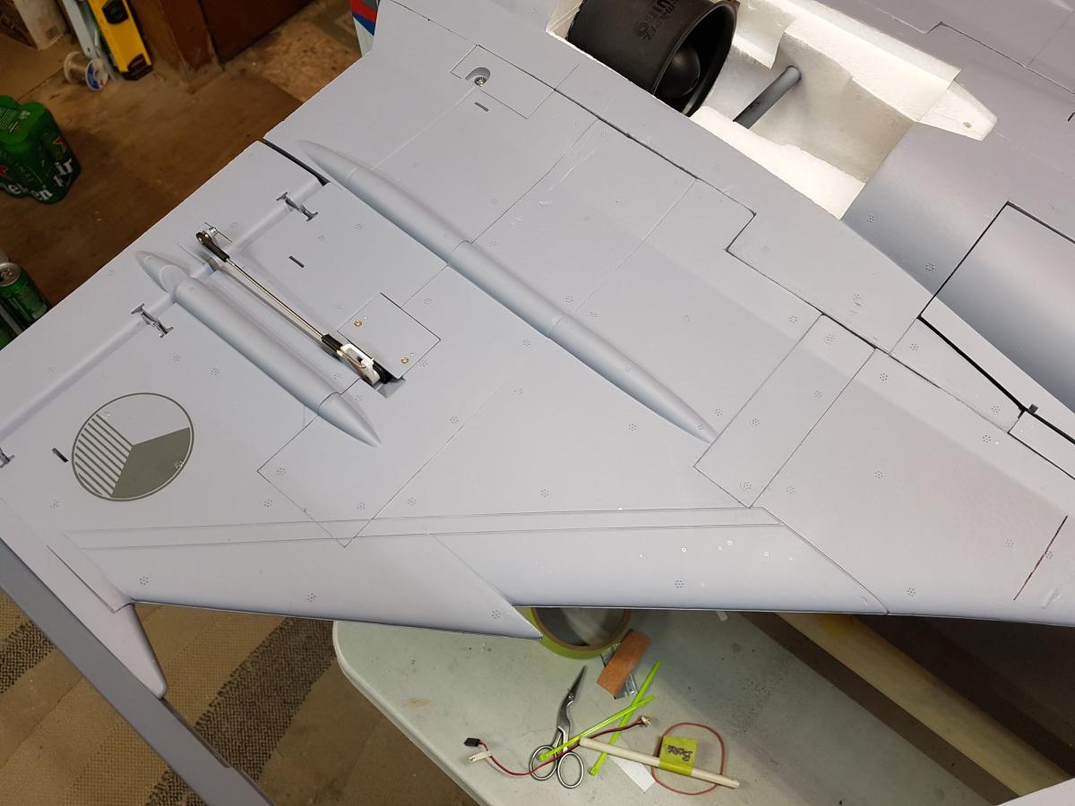

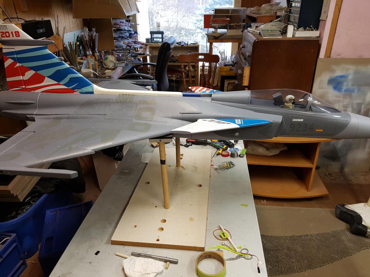

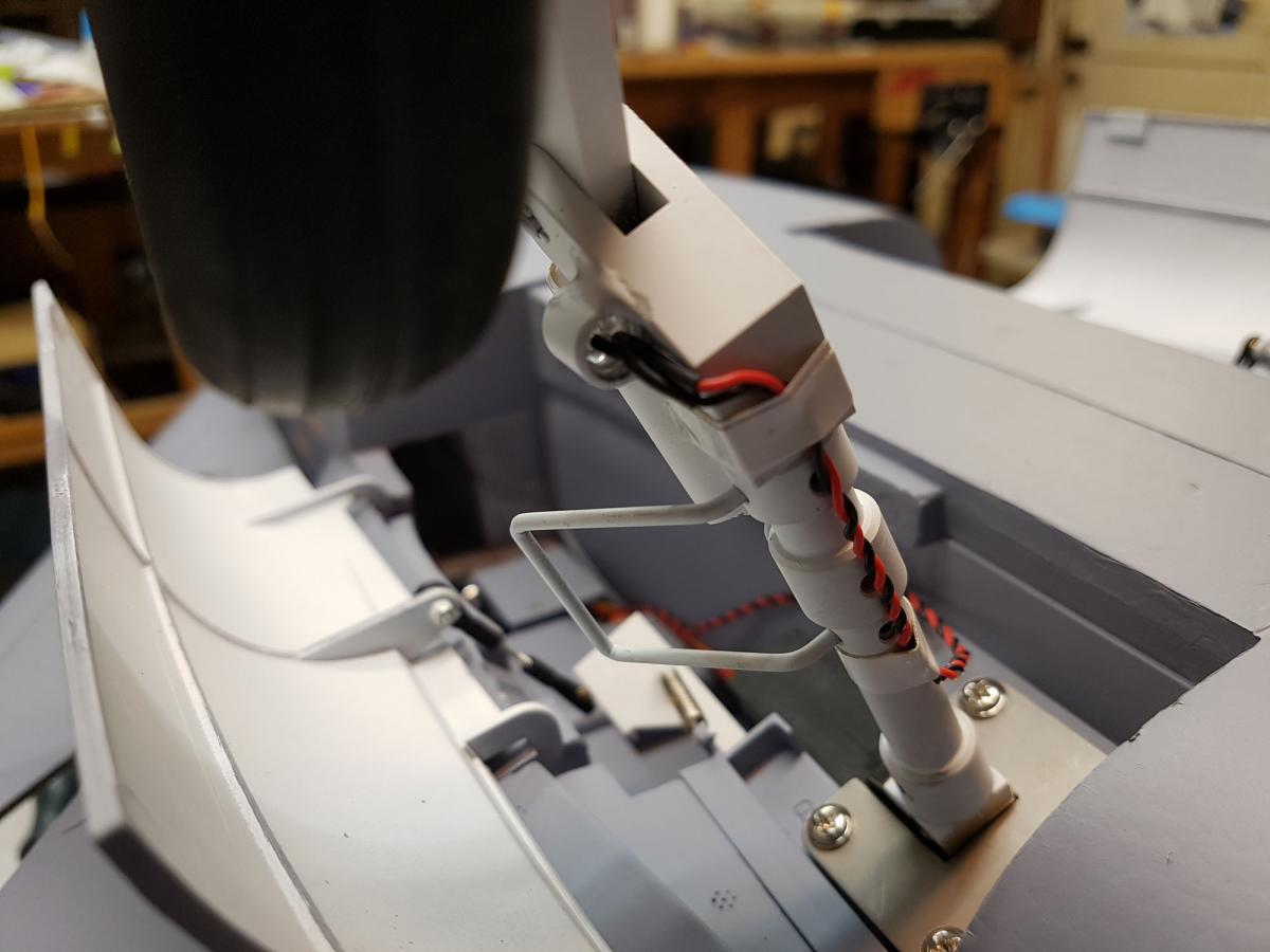

                            I had some time in the shop this weekend and began the planned modifications. Landing lights were added to the main gear (as the full size has) by bonding aluminum tubing to the struts with KB weld into which the LED's slide. Plastic tubing was used to hide the springs.
                            The silly nose light was removed and a bulb fitted to a door made from 'glass sheet to sort of replicate the real Gripen. After some trial and error I used pinned hinges and a spring from the Venom nose door to close it and then cut back the existing doors.
                            The struts and insides of the doors were painted white and the wheels got a bit of detailing, as did the exhaust nozzle with some weathering and a flat coat applied. The inside was covered with aluminum tape to enhance the LED 'afterburner" and the last inch or so painted to simulate a jet pipe. The 'burner is one of Gooniac's (thanks Ray!) and although not installed for the first 2 flights it's in there and working now and I think it's going to look great in flight.

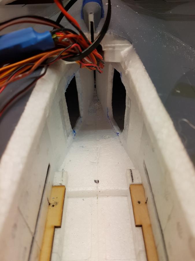

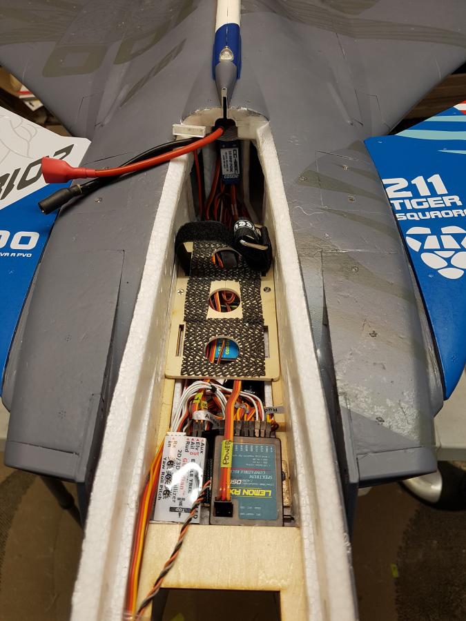

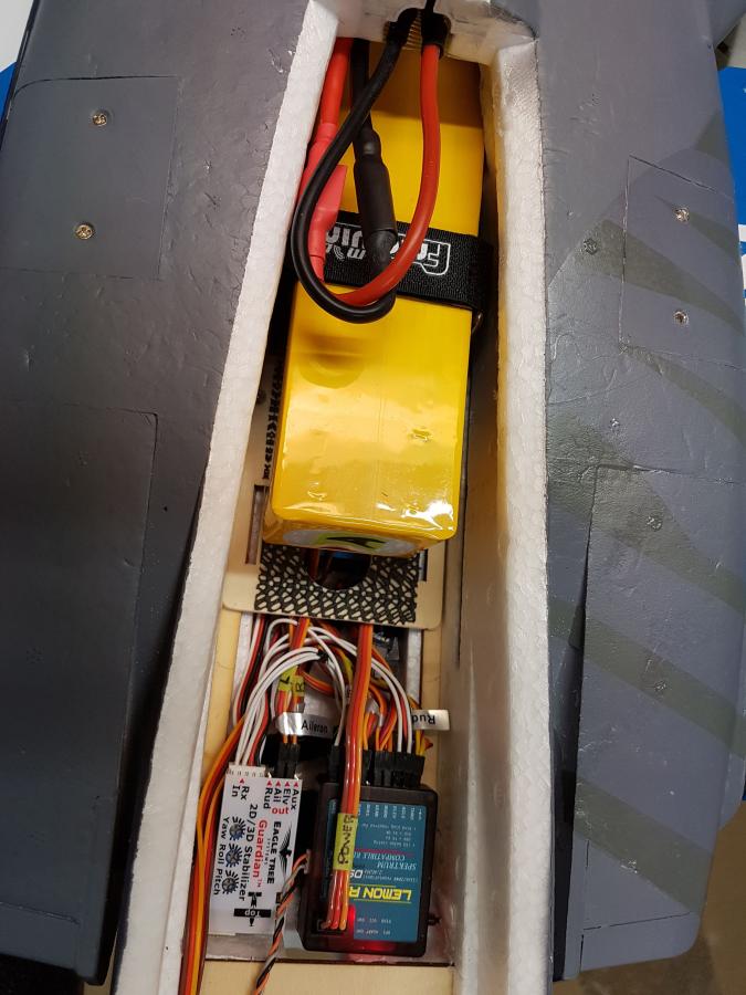

                                  My first 2 flights were flown with the last of my still useable Roaring Top 5000 45 c batteries, weighing 720 grams. The model balanced at 133mm with 34 grams of lead in the tail and seemed to fly well at that CG. I've since replenished my battery supply with 6 Liperior 5000 45c (thanks Richard!) which are heftier (and I hope longer lasting) at 780 grams.
                                  Foam was removed to get the battery as far back as possible and the corners of the battery now protrude just slightly into the intakes- not enough for any ill effects I reckon. Everything else- rx, gyro, light controller, AB controller,10 A BEC and wiring is also to the rear. I was happy to see that the CG is about the same as before so no extra lead required despite the heavier battery.
