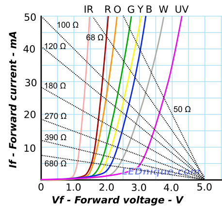

    Spit balling here but the blue LED controller weighs 11g, and is in the nose area. It doesn't do anything on this jet because all 3 lights are static. Why not replace it by a simple 3 way splitter?
    Do you mean you just Y-d the lights into the receiver with a 3-way Y lead to remove the controller?
    That I'd like to try. 8 grams is 8 grams. No big savings to be had, will have to be incremental.
    I did relocate my receiver under the battery tray and moved the light controller back as far as I could to make a small difference in where the weight is located. Perhaps without the light controller I could move the receiver back further.
      My light controller turns the landing light on and off, so that function would be lost. Also I don't know that the position light LEDs have built-in current limiting, or whether that is provided by the controller.
      Removing 11g from the light controller location will move the CG back by just 1.5mm
      I'm leaving mine in place.

        The light controller like the various BB's and MCB's that FreeWing uses all have resistors in them to drop the voltage the LEDs see. Wiring them direct to receiver voltage will destroy them.

          #1084
          Thanks for confirming that, Evan.
          The current through a LED (or any other semiconductor diode) increases exponentially, not linearly, with voltage, so some method of limiting the current is always needed, such as those dropping resistors.
            Thanks for that, luckily I hadn't powered up my new setup. Blue LED box will be going back in 😕
              Yup. Been there done that. I always do servo testing before I assemble a plane. In the early days of lights, I used to "test" them by plugging them into the servo tester, which is the same voltage as what goes in and out of a RX. Instant light destruction.

                An alternative is to add a resistor in line with the LED. Very easy to do but I forget the resistance you need. It's not much and if you have an old blue box you could even remove the resistors from inside it but they are surface mount (very tiny) and not easy to solder for most people.
                    John, the nav lights don't have a built-in current limiting, they are just plain 1w leds. I had to replace on already. It's the FW led controller that has the resistors built-in, providing around 3.3V for each port on that controller

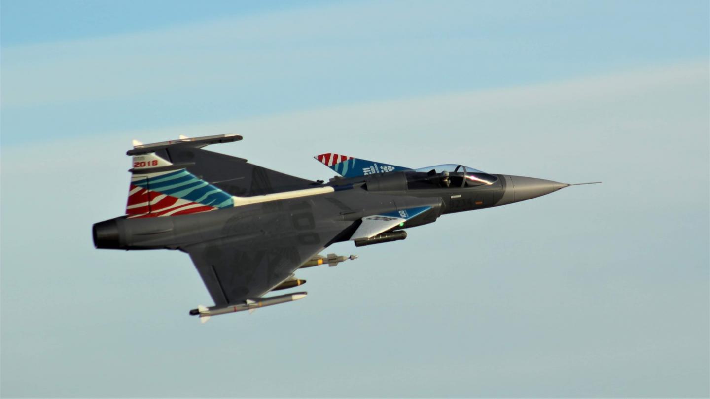

                          Pictures of my Freewing JAS-39 Gripen with weapons and armament.

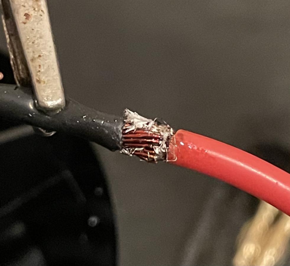

                            Trying to solder extensions to the ends of wires of my new FMS 80mm power unit. I’m using a Hakko at 720F, 63/37 solder, and flux on the joint. I cannot for the life of me get any solder to stick to the copper on the motor side. Any tips?

                              Use a solder heavier tip witch store more heat.
                              I was struggling a lot to I got a bigger professional solder iron.

                                  Motor wires have an enamel coating you have to remove.
