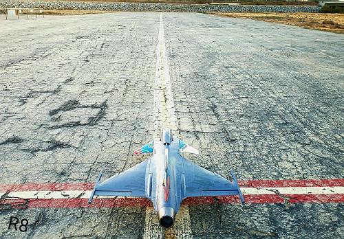

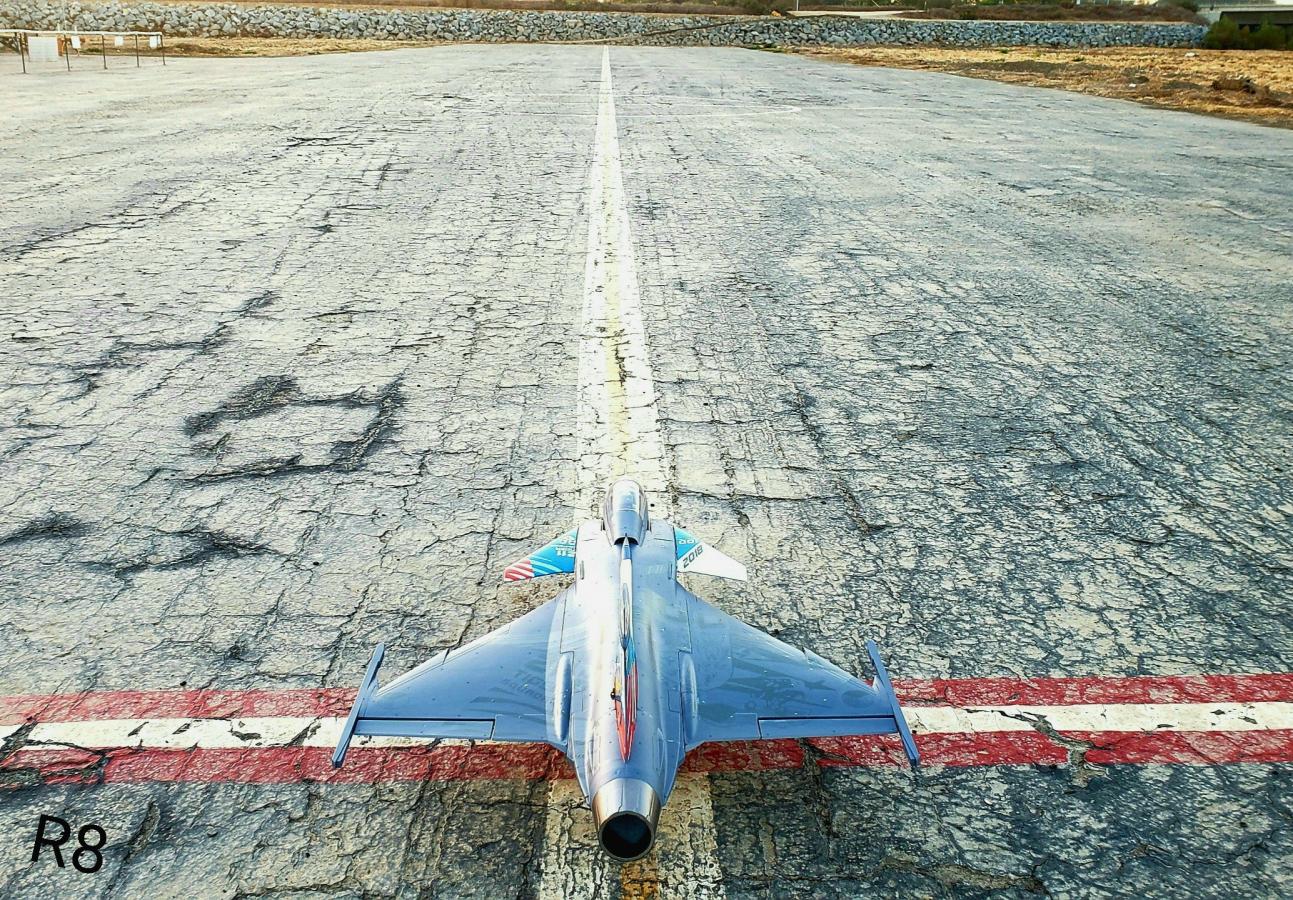

                    Originally posted by Reborn8
                    I received my Gripen last Wednesday and it came in great condition. I assembled it Thursday and did the maiden on Saturday. It flew great with or without the canards activated. Canards activated definitely give her that extra turn and burn ability for sure though. She's a great flying bird with that classic menacing presence in the air that delta wings pull off so well. Thanks for making another winner Freewing and MotionRC!
                    Click image for larger version Name:	20201116_233740.jpg Views:	0 Size:	364.8 KB ID:	286357
                    Is that a stone wall right at the end of your runway?
                    (Looks like the runway could do with some TLC).
                    • sschenck75
                      • 2

                          #912
                          True. The runway is a long 250ft but it does need some TLC but it is so wide people have plenty of room to land. We were supposed to get it resurfaced this year but Covid put the damper on that. There is a rock embankment that goes up at the end but like I said with a 250ft runway only a serious error would cause one to go into it. It has happened though 😊
