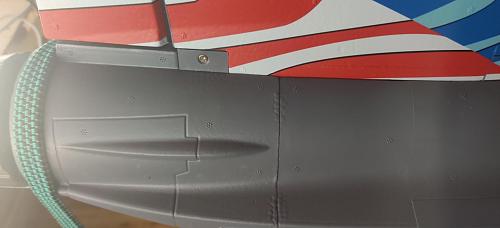

But, that said, for anyone with any intention of eventually upgrading to the TV unit, you 100% do not have to glue in the back part of the fuselage to the point where you'll never get it apart. The back part of the fuse which the TV unit will replace is just foam and 2 long carbon tubes. And the beauty is that half the vertical stab gets screwed to that section. See below.
That the Gripen I have with the TV unit installed. Justin and I just put 4 nice dabs of foam tac on the flat parts of the foam that meet, none on the carbon spars or on any little crevices and that's how we flew it for the video and how it remains right now. I can easily slip a razor blade through the seem and swap from the TV back to the original if I want to. So between the foam tac, the carbon spars and the screw there is plenty of security.

Just to be a bit clearer, here is the stock back fuse. I marked the spots (in gold marker) and general size of the foam tac I applied to the TV unit version that I installed on a Gripen. With foam tac there, the 2 spars and the screw into the Vertical, she's not going to go anywhere and can be easily removed with a hobby blade for when you want to try the TV later.

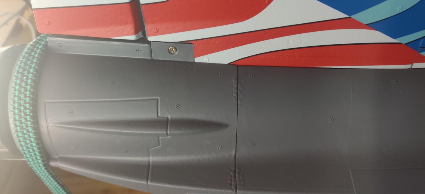

Here you go, it's split in the horizontal plane.Originally posted by Airguardian View PostI like the vane you made for the spar to reduce drag... any chance you share the STL? :D
- Likes 3
Thanks!Originally posted by Radar-Guy View Post
Here you go, it's split in the horizontal plane.Freewing A-10 turbine conversion: http://fb.me/FreewingA10TurbineConversion

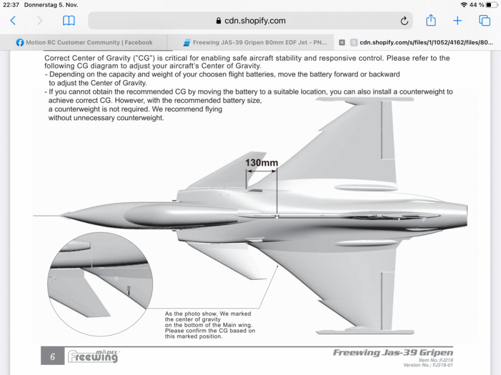

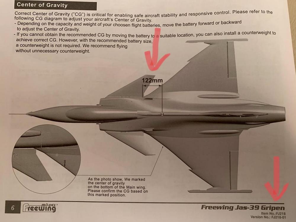

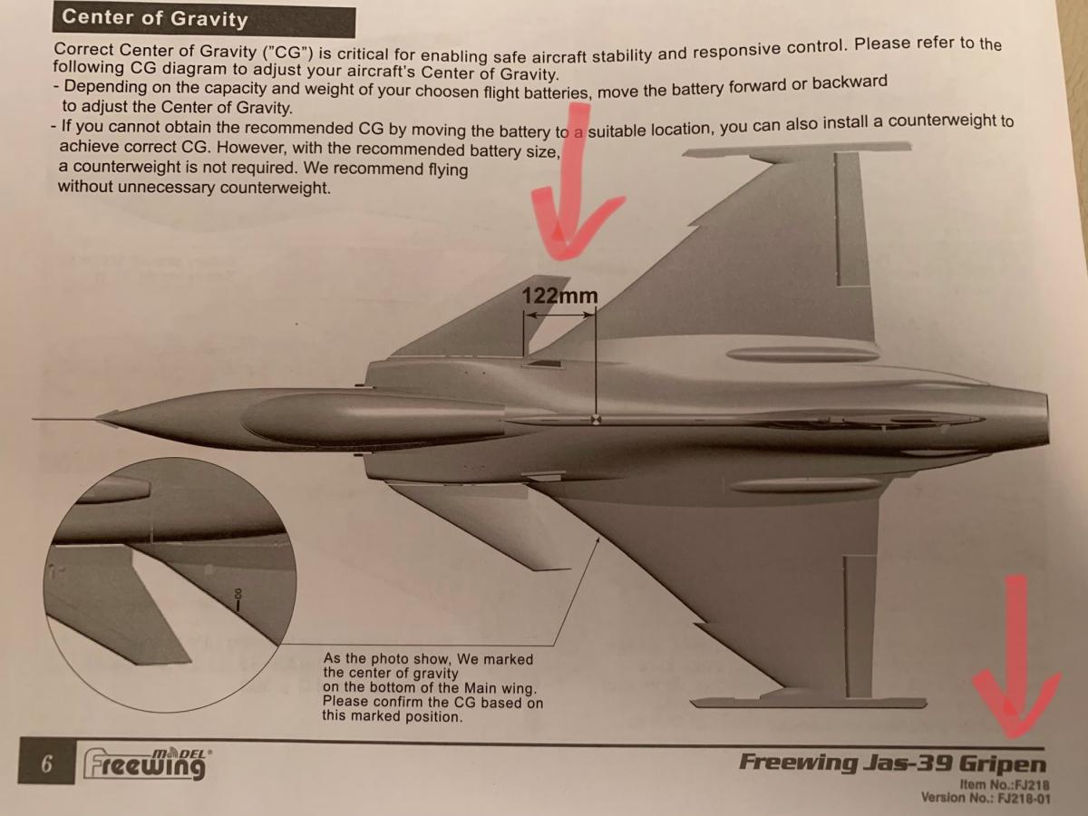

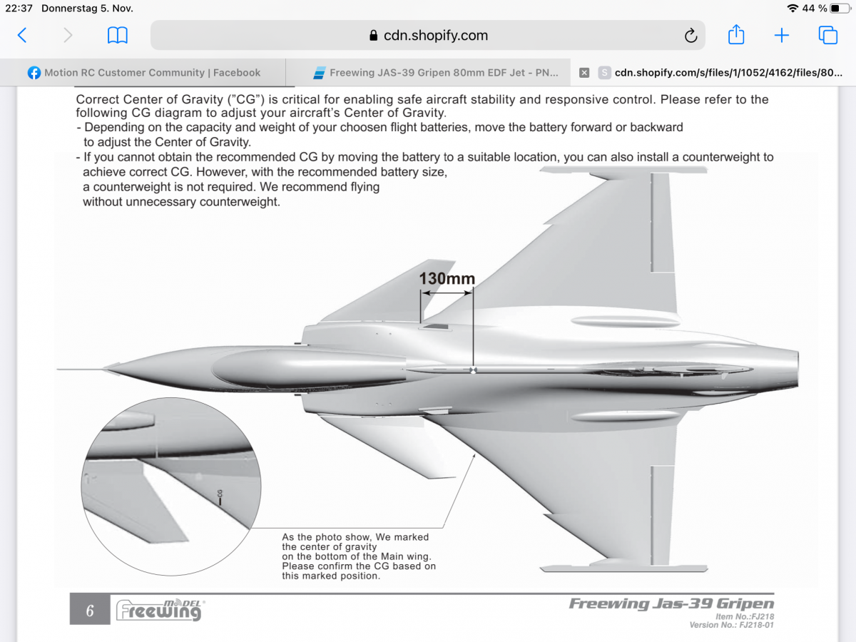

Now this is interesting: The printed manual that came with my kit shows the CG at 122mm while the current online manual has it at 130mm. Both manuals show the same (!) Version No. !
Would MRC please comment?
I checked my model, the moulded marking is at 122mm. Will we get free replacement wings with the revised CG marking? 😁
- Likes 1
Finished installing the afterburner module (by Eberhard Funk). The control box nicely fits under the battery tray. Now I need to figure out how to get this plane to balance properly, I need to hide 85g somewhere in the back ...

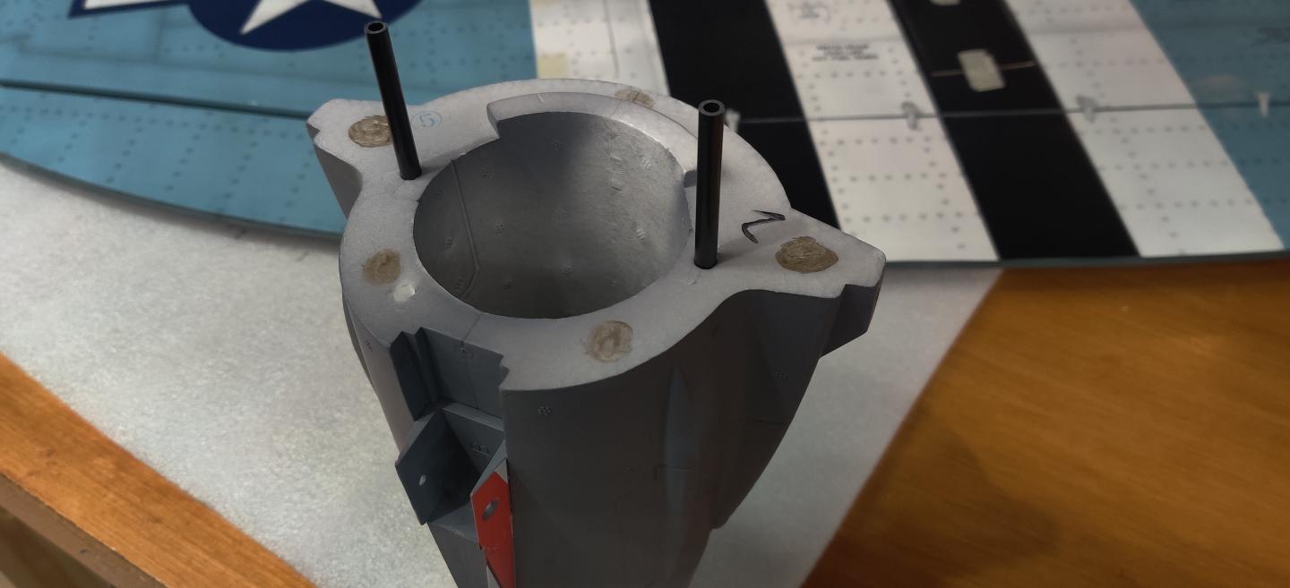

@Radar-Guy your printed nozzle might be a nice place to hide balast, would you share that aswell?5 Photos
- Likes 1
I hid some steel 'square pieces' that I was keeping for ballast purpose in the stock nozzle on the inside, carved a bit of foam, and epoxied them in.
This was not enough though so I also added a large steel rod in the vertical fin and a couple steel sheets in the fuselage foam right underneath the rudder.
Glued them in so they won't mess rudder operation if they came loose.
