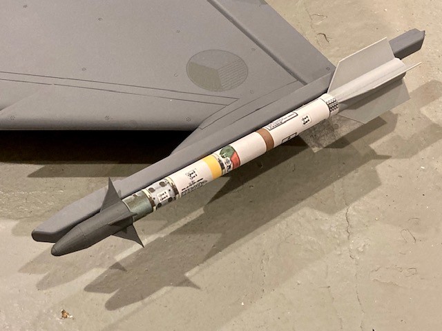

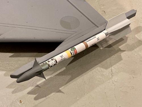

      Sidewinders to fit the wingtip rails. It's in 4 parts for ease of printing on smaller printers.
      Sidewinder at 1/9 scale for Freewing Gripen. Lug fits the keyhole in the wingtip rail.The mid section has breakaway support at the base to stabilize during upright printing. They look like fins with pads at the base. They can easily be removed after printing.Suggest printing lug solid for strength, 15% infill for the rest.
      You're welcome.

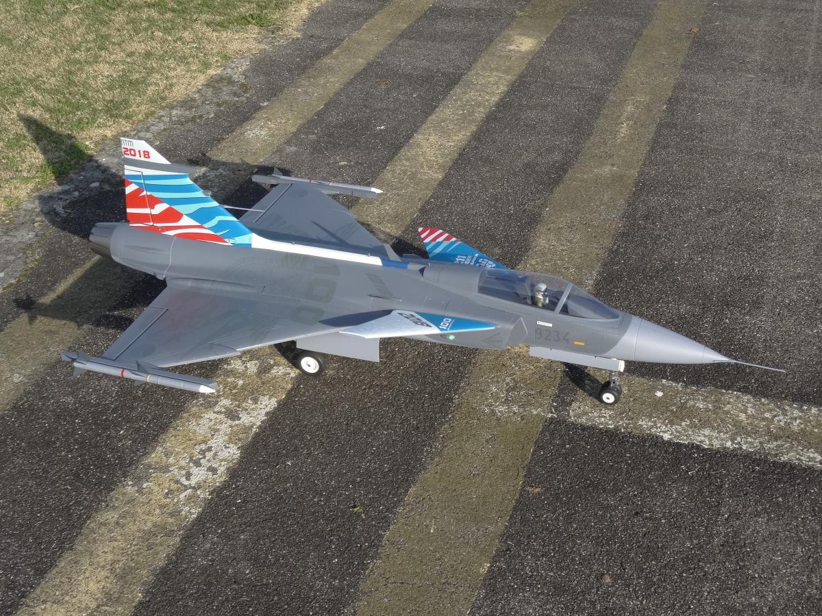

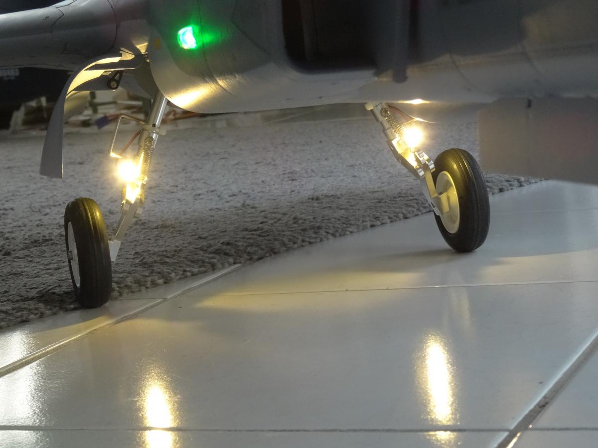

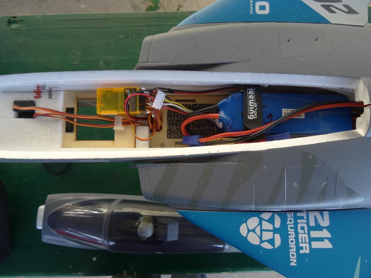

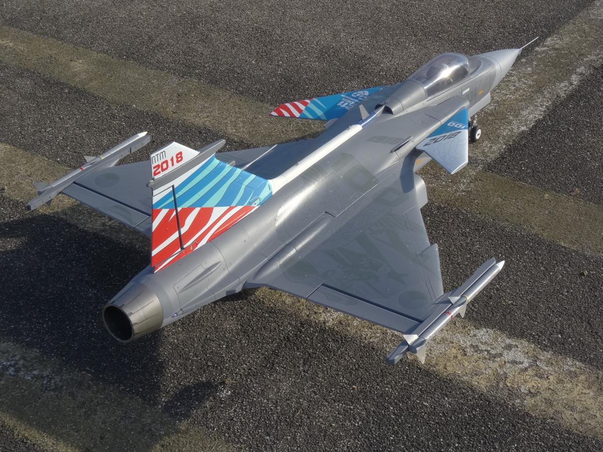

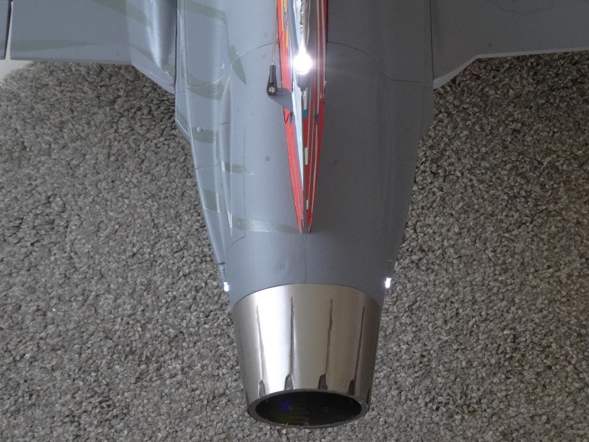

          Click image for larger version  Name:	DSC01502.JPG Views:	30 Size:	148.3 KB ID:	285884Click image for larger version  Name:	DSC01504.JPG Views:	27 Size:	86.9 KB ID:	285885Click image for larger version  Name:	DSC01516.JPG Views:	27 Size:	101.1 KB ID:	285886Click image for larger version  Name:	DSC01514.JPG Views:	27 Size:	276.1 KB ID:	285887Click image for larger version  Name:	DSC01515.JPG Views:	27 Size:	254.1 KB ID:	285888 Maiden Flight today!
          The Gripen flies nice without any problems setting by the book (low rates) and the CG at 130mm. No gyro. Battery: TURNIGY 6s 4.000mAh 60C Heavy Duty with 685g / no additional weight needed / as far back as possible. I f you want to fly a bigger battery trim weight will be needed in the back.
          I´ve added an ACL flash and white position lights in the back, landing lights on the main landing gear and an LED-Centerburner from "the lightburner". Looks cool!!! :-)
            You're welcome.

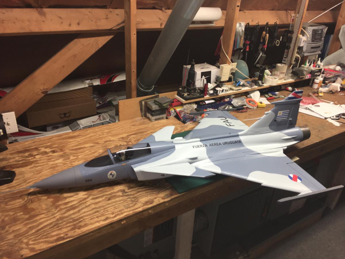

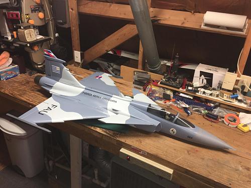

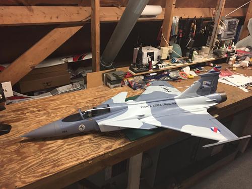

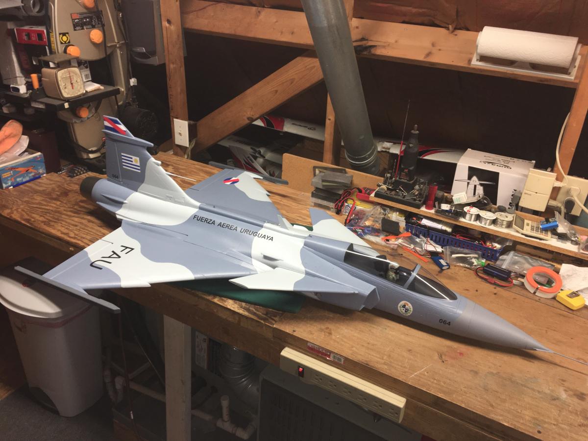

ID:	286087Click image for larger version
ID:	286086 Graphics on. After yesterday’s flights I added another 30g in the tail for a total of 80g.
                      *Please don’t use those numbers for your own builds since mine is very non stock.

                          I maidened two yesterday. Both JF/ HET. Mine with the HK Plush 120HV his with a CC. Mine with 6+2 Hobby Star 5200 45C (850g), his with a Powerhobby 8S 5000 100C (765g). Mine with a Orange 12ch (using 10ch now waiting for the TVs), his with a Spektrum 9ch with AS3X off. Slightly different programing.
                          I got a maiden +2 more on mine. 2 clicks of aileron and flew absolutely great. Balanced on the wing marks (took 50g) felt nose heavy. Two other flights were flawless. Only thing to note was I have the canards doing both pitch and roll. Interesting with the canards off for roll the roll rate is the same, good roll rate on high rates.
                          First flight of his needed a lot of roll and a lot of pitch trim. He had added weight to balance at 130-133, I forget which. On the ground looking at surfaces the first thing I saw was he had canards trimming with the elevons, we turned that off and centered them. We re subtrimmed the elevons straight. Second flight he took it off and it immediately hung a right over the pilots stations. Trying to retrimmed while flying he kept losing orientation especially away from the sun, it was inverted more than right side up. I took over and got it trimmed and flew the rest of the pack. I have to say I have excellent eye sight and spatial awareness and was having a hard time away from the sun. I have zero problems with any other plane but the stock colors on this are difficult, my repaint wasn't at all... After the flight comparing trim and throws we couldn't see anything that would cause the panes to fly differently. My only thought is balance but I can't think 122 vs 130-133 would make that much of a difference. I seemed like AS3X was messing with the flight but he is sure it's both off and not set up.
                          Along with getting my graphics done today I added 30g under the vertical to balance at 132. That makes 80g total added to the tail which I assume will be close to the TV tail section.
