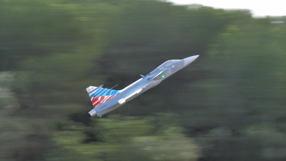

    On another note, bit of a rookie mistake here... it turns out I have been a bit dumb with my Gripen setup (NO, not regarding the CG!).
    This is my first jet running an S8R stabilized receiver and I didn't properly set up the endpoints, so I was getting quite limited rudder/elevon throws.
    Now that I have setup the endpoints right on the gyro, that's a lot of extra elevon/rudder authority that I was missing.
    Already made three flights (not today's video) and the jet behaves more to my liking. Already achieved 45º sustained and controlled high alpha just 50cm from the ground.
    This will further improve when I get CG more aft.
    #hype

        I have just changed my setup for a better one... will do some more fine-tuning and share that 'improved' setup instead! ;)
        But overall, I must be aproximately around 132mm CG and 3cm up/down elevon throw, 3,5cm for canards.
        Basically I have the maximum mechanical throws that the stock servos will allow and big doses of expo to deal with them (like 60% on pitch and 70% on roll).
        Will do a more comprehensive setup write-down soon enough... bare with me! :)

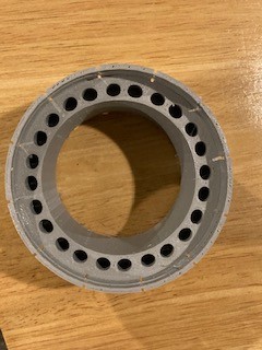

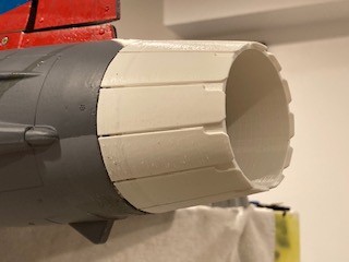

          Heavy nozzle for CG adjustment. It has internal pockets for up to 60g of small lead weights.
            Hello
            do you have a stl??

                Yes I do. Do a search on Thingiverse.

                  The Gripen needs weight in the tail to achieve an acceptable CG position. This nozzle has accommodation for up to 60g of small lead weights, in addition to weighing over 60 grams itself. Print wide-side down, with supports.You will need to peel off the plastic outer of the stock nozzle, and trim back the foam to leave a stub 13mm long to which you glue the new nozzle. I suggest taping the join on the inside to ensure smooth airflow,

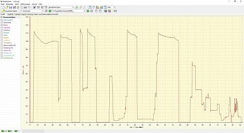

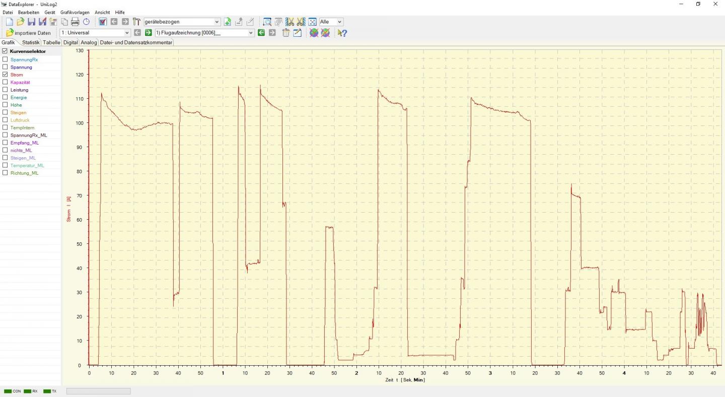

                    Originally posted by Radar-Guy
                    Here is the graph showing the Amp draw of that flight.
Name:	Gripen 2nd flight graph_ I only_ 2020-11-10.jpg
                    Thank you. I'd never seen peak voltage for the Wemo, just 22.2V. Glad to see I can use a 120A ESC with that fan as I have a couple of those that are good for 8S.

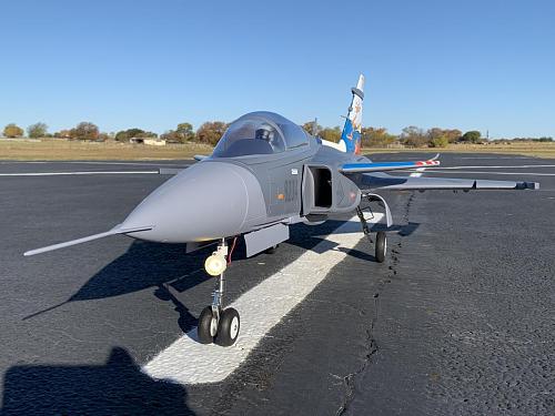

ID:	285409Click image for larger version

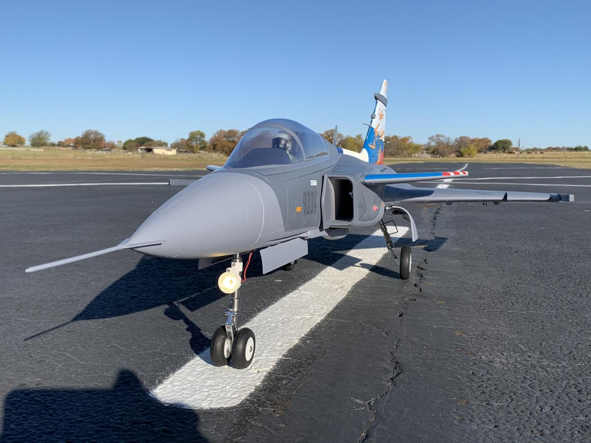

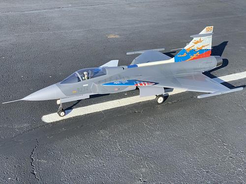

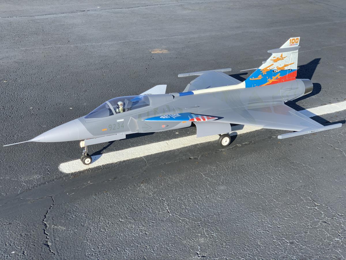

ID:	285408 Did maiden + 3 more flights today. Super nose heavy on 5000s as already stated. Make sure you check your grub screws on the gear! One came loose on landing rollout causing quite an interesting ground loop. Fixed with some locktite. I really wish those would have locktite on them from the factory.
                      She sure is pretty!

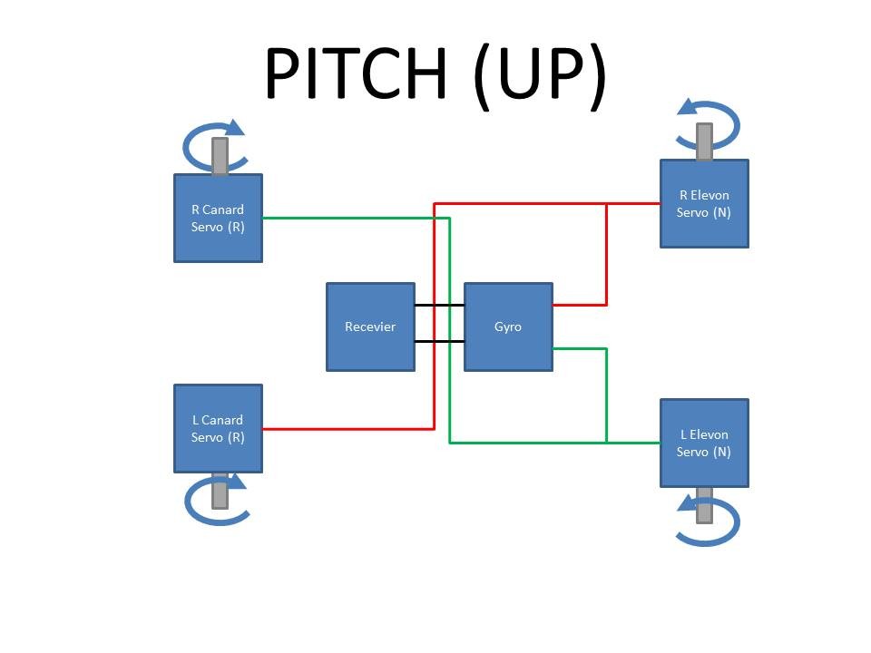

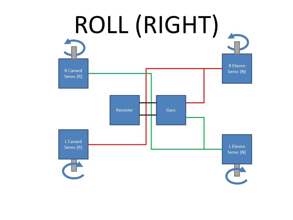

                          Single-gyro scheme for elevons & canards - does it make sense?
                          Mine's expected to arrive Thursday.
                              Perfect! I've been drilling holes in the foam in the tail and gluing in lead but it is very slow. Thanks.

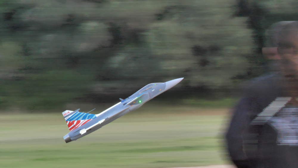

                                    Here are a few pics from today's high alpha... :)
                                      Hey Fred, which Gyro are you going to use? I used a blue Eagle AL-3 in the delta setup and it doesn't control the canards even with the mix. Are you going to try to Y-Lead opposite Elevon to Canard?
                                      I have thought about attempting to try the A3 Super 3 as with that one you can have 2 aileron and 2 elevator ports. That might work, but my brain is confused trying to think about it at the moment
                                        I know Frode tried with the black hobby eagle, but had trouble getting all the mixes to work correctly from both the sticks and the gyro compensation. Pretty sure it's doable, but not quite sure what he did and didn't try.
