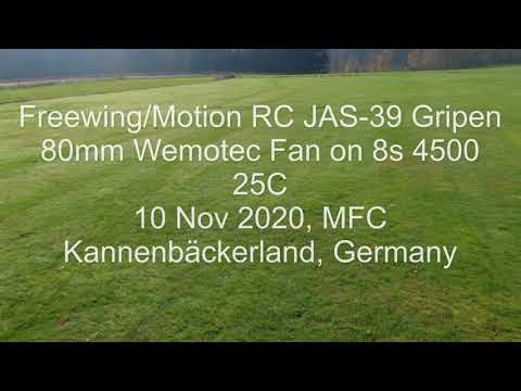

                                #795
                                A video showing the second flight of my Gripen, powered by an 8s Wemotec Midi Fan Evo 80mm, HET 700-60-1865kV motor, 120A ESC, 2x 4s 4500mAh 25C Lipos (800g in total). 3d printed nozzle with 65mm exit diameter, 80g tail ballast.
                                Sorry for the poor quality, Headcam video. Conditions: 8 deg C, wet and sticky grass...
                                  Frank
                                  Hello Frank,
                                  your Gripen sounds very good and is really fast. Congratulations!!! Nice clip!!!
                                    Very nice!
                                    Packs a punch compared to stock setup... have a spare 80mm WeMo lying around, may as well mimic your setup, hehehe!
                                    Great flight time too!

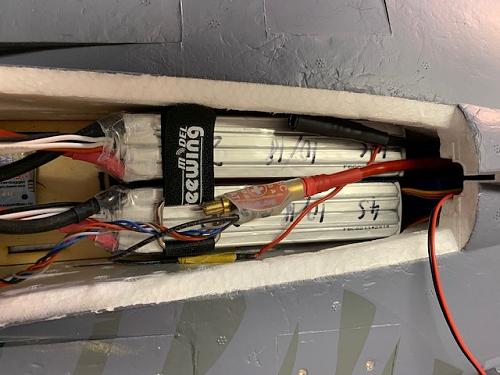

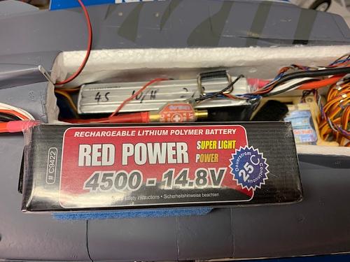

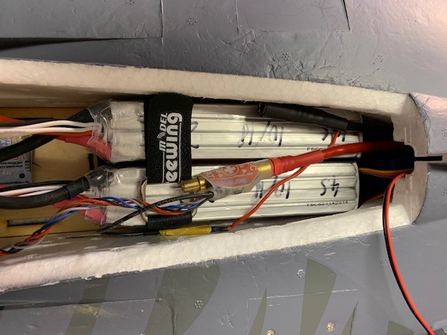

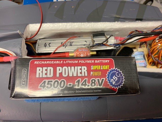

                                    Could you please post pictures of your battery placement?
                                    What's your CG with this setup?

                                      • Radar-Guy
                                        AirBorn Jetworkx
                                        • 364
                                        #799
                                        Very nice!
                                        Thanks! Will the older Wemotec housing fit into the Gripen without foam shaving? The new one is a perfect replacement.
                                        The CG is around 132mm.
