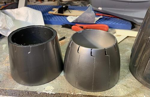

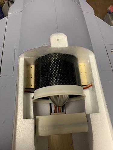

            Originally posted by janmb
            I think freewing is overdoing the conservative recommendations to the point of the design being difficult to cope with anymore. Always foam removal / tail weight needed, and that is so unnecessary.
            So maybe it’s a good thing that my 3DP nozzle came out a bit heavy...
                    Is that your original design?

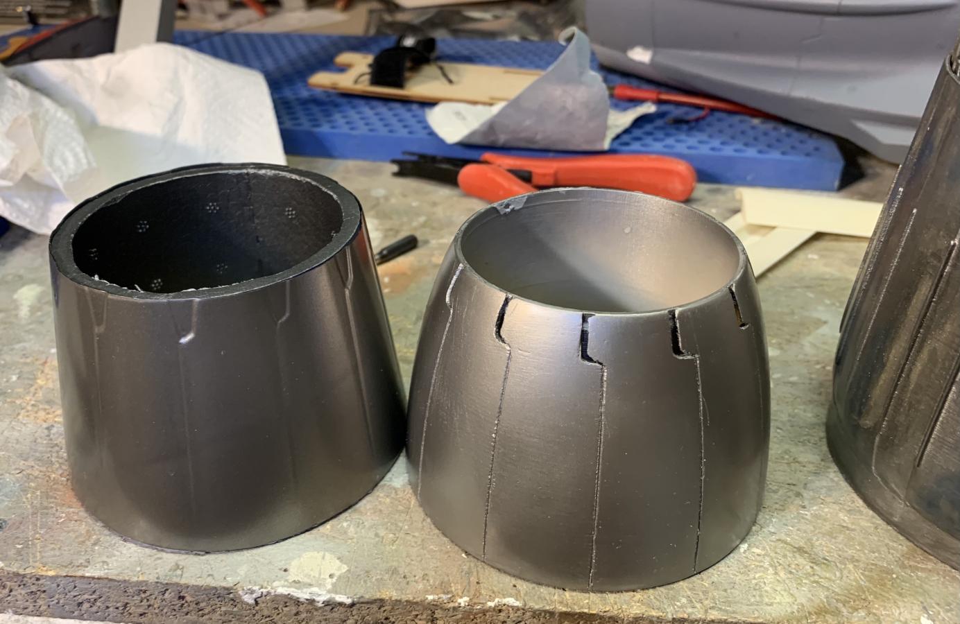

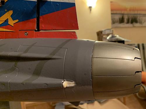

                        Yes, it is. Exhaust diameter is 65mm (stock 67mm) as recommended for the Wemotec fan.

                                  Nice.
                                    I like the vane you made for the spar to reduce drag... any chance you share the STL? :D

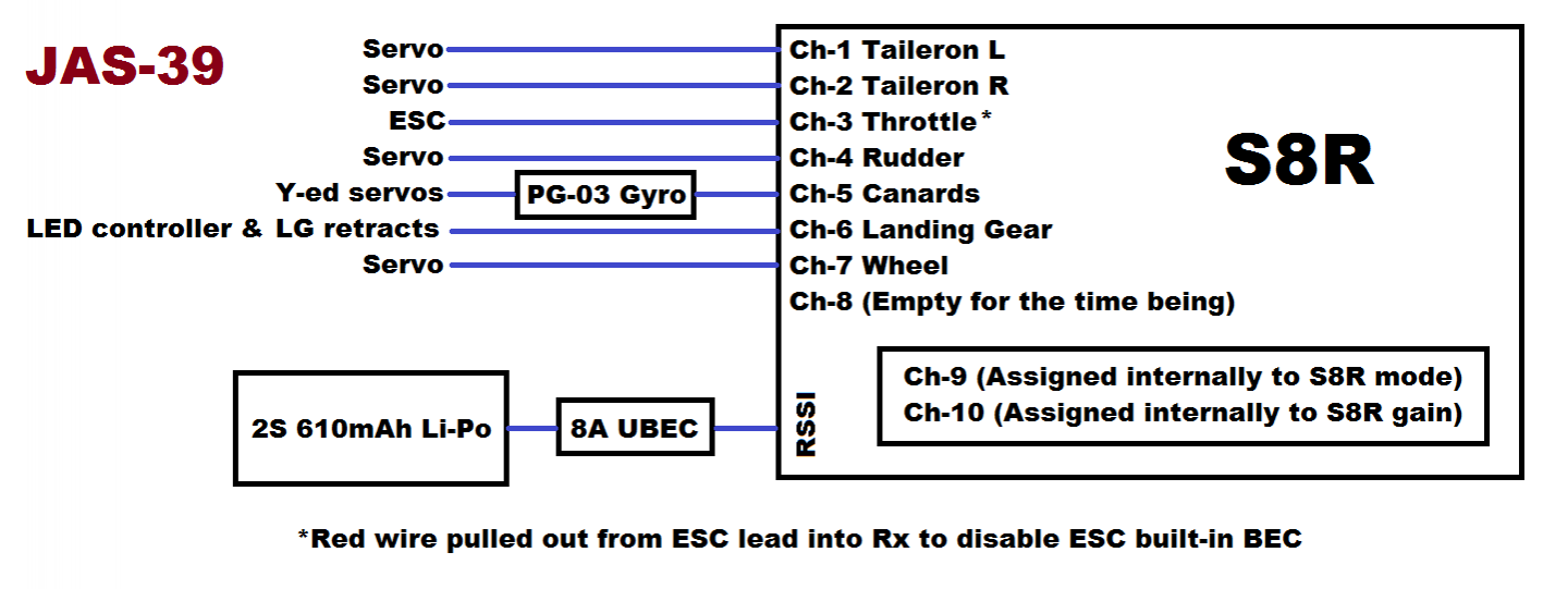

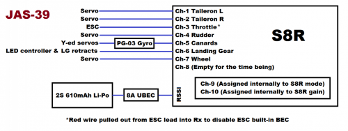

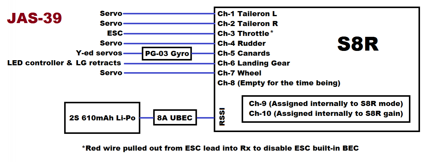

                                    Originally posted by slumi
                                    Hi Airguardian,
                                    how did you wire your S8R gyro stabilized receiver ?
                                    I am especially interested in the wiring of the canards and mixing from the transmitter.
                                    Sure, it's pretty straightforward, find diagram attached:
                                    Canards are mixed for pitch only as if the gyro was not in there, simple! ;)
Name:	S8R JAS-39.png
                                    • slumi
                                      • Apr 2020
                                      • 54
                                      • Luxembourg
                                      #718
                                      Thanks Airguardian for your quick reply.
                                      So only one channel for the canards, that simplifies a lot.
                                      I guess you use elevon mixing in the S8R gyro-receiver for Taileron L and Taileron R.
                                      For the canards you use directly elevator.
                                      Not clear for me is the function of PG-03 gyro, what for ?
                                      • RudyD54
                                        • Aug 2020
