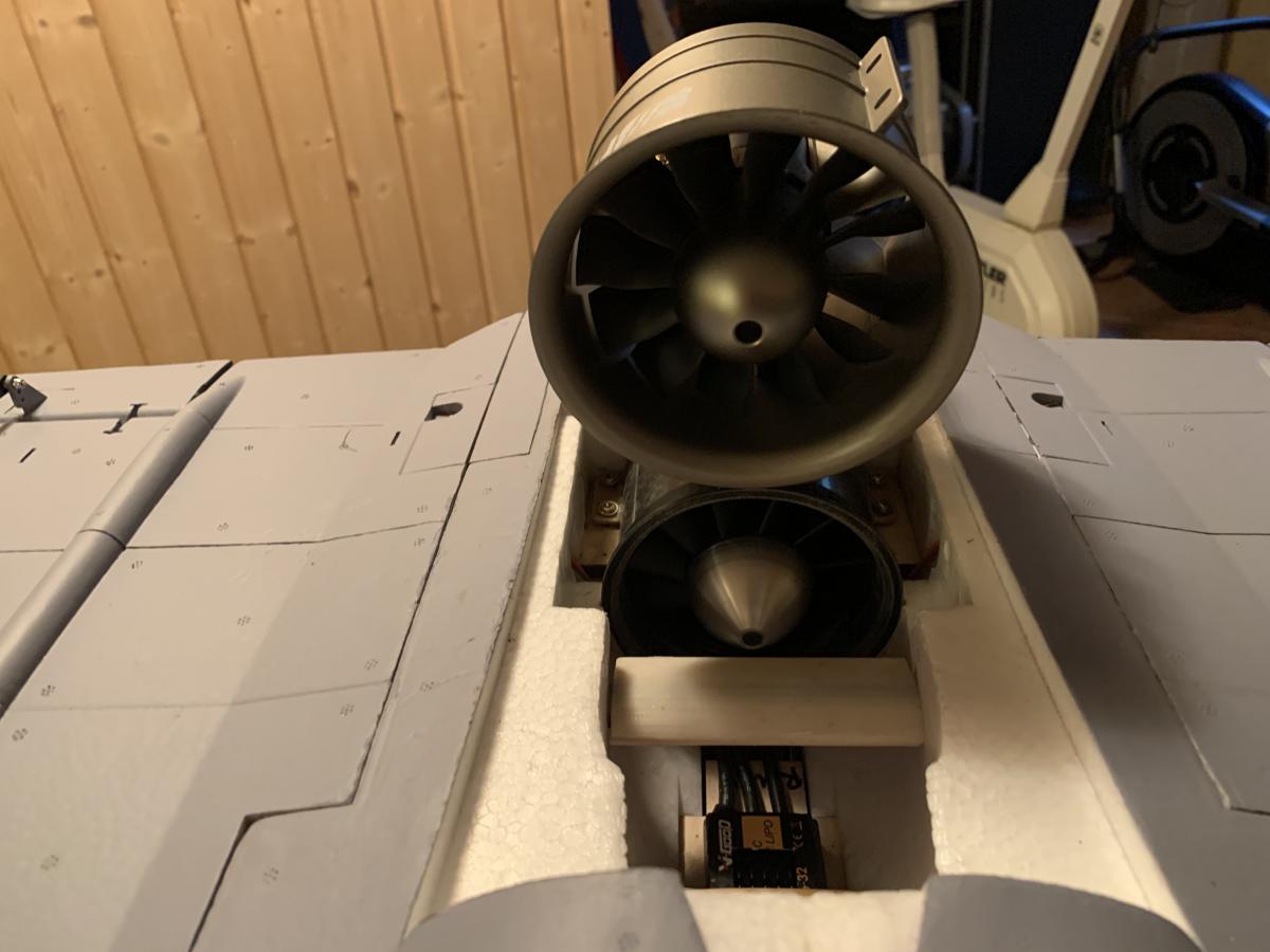

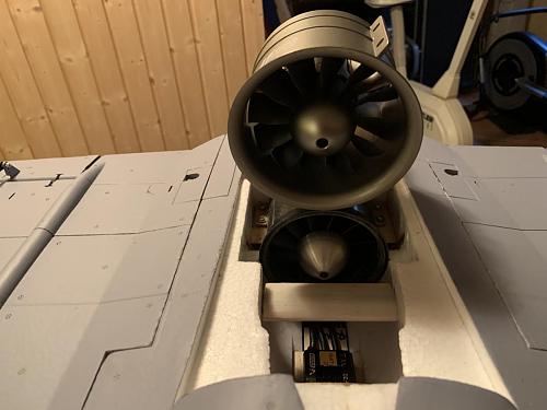

    • Geez. That looks like a 105mm stacked on top of that Gripen!! 😲
      Originally posted by Radar-Guy View Post
      TangoVector I don’t think that it’s such a good idea to consider the FMS 90mm fan for the Gripen...

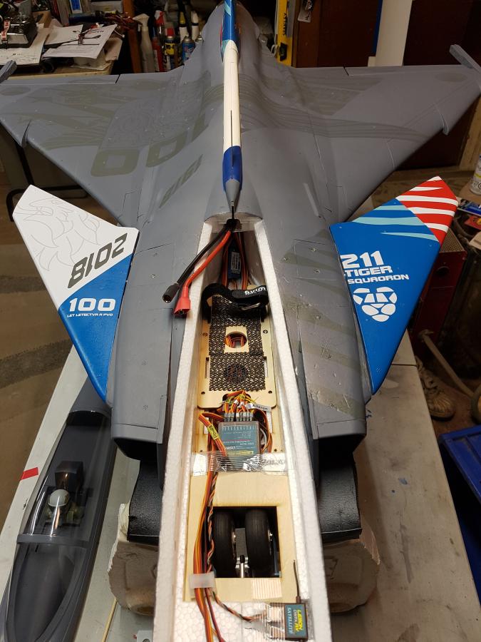

                                  • Well, I finally got around to completing the setup on my Gripen. I went with a Spektrum AR637T, an RC Light Systems channel expander, and an SMC 6S 4000 battery. All flight surfaces are on channels 2-6 and the gear and nosewheel are on 7 and 8 through the expander. Thanks to @evand and kallend for sending me your radio files, they helped me understand the elevon setup. I was able to figure out how to setup the receiver to stabilize all the flight surfaces including the canards which I setup for pitch only. The only downside is I can’t trim the canards separately from the elevons but that’s no big deal. I’ll adjust them back to the neutral position after the maiden via the linkages. Once the vector unit is available I plan on upgrading to the AR8360T receiver which will give me two additional stabilized outputs for the pitch and yaw servos, and then I’ll just setup a couple of flight modes for the gain.
                                    I was able to get the CG back to 130mm using the SMC 4000 which weighs 593 grams with no trimming of foam or extra weight. I’m going to see how I like it there before I make any modifications or add weight to the tail. I was curious so I temporarily added 80 grams of weight in the tail to simulate the addition of the vectoring unit and it brought the CG to 145mm. That’s probably further than I’ll personally be comfortable with but it’s nice to know I can get it there. My total ready to fly weight comes out to 2,999 grams and I measured my peak thrust on a full pack to be 2700 grams at around 2500 watts. It settles out around 2650 grams after a few seconds. I had previously measured 2400 grams of thrust but I realized I measured incorrectly. Oops... Those numbers would put me at .9 thrust to weight ratio. (Feel free to check my math).
