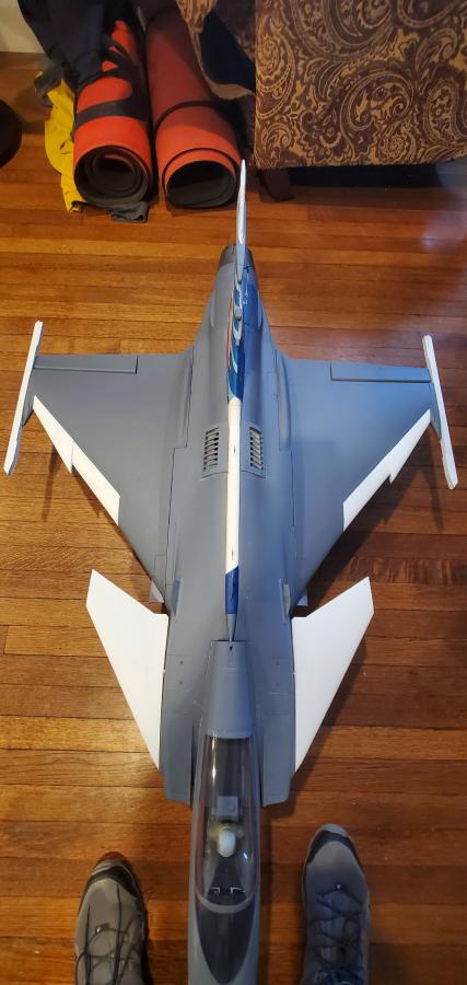

            So like some others I added some additional intake vents along the top. slightly modified F 16 vents. Took it out today for testing. My observation is that top speed is virtually unchanged. That doesn't matter much to me because its pretty darn fast now anyway with my jetfan 1738kv setup. 3.45 flight time. Two things did change 1. the sound, ok so what.... 2. The throttle response, yes! No more delayed power build up, it just gives you what its got and goes. That makes the flight a little more predictable and easier to manage coming out of low speed maneuvers.
            This Jet has been an evolution of modifications for me and considering the look and what I have to fly today I am very happy with it. GLTA
                      Two questions:
                      1. What is the weight of your 5Ah/8S batterypack?
                      2. I looked up the GLTA acronym online... What does the Gay & Lesbian Tennis Alliance has to do with all of this?
                        Ok, now that's encouraging!
                        I would hate to add top-cheaters but at least it seems that they work, thanks for the feedback :)

                          Answers:
                          1. My 2 x 4s HRB = 1000 grams a little carve out in the battery bay.

                              Well yes I did not want to add the top cheaters either, and I already had some additional bottom cheater. But it was only missing throttle response and I wanted to know would it make the difference. I personally am glad I did but others may better enjoy the clean look.

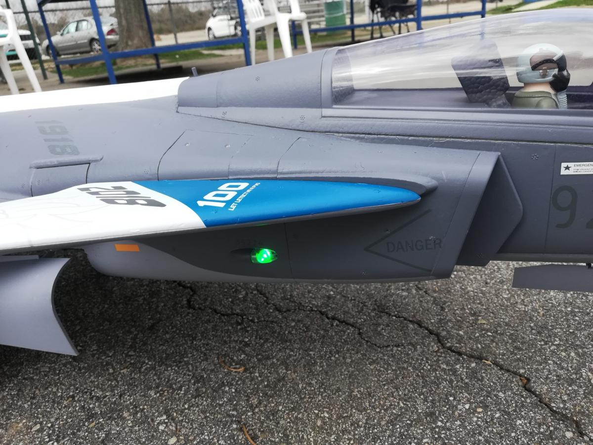

                                    Added Virtual Flaps Setting on TX ...
                                    Hi guys, I am still adjusting to optimize, and added a virtual flap setting for landings only to my tx flap switch that adds down canards, see pic, offsets the nose up from the gear doors and makes for a lower nose and better landings. My virtual flap setting also adds in a few percent of up elevator to the elevons to add a touch of washout and more stability on landings. Before these changes I was having occasional scary wing stalls on landing. All good now however might be worth trying a virtual half flap setting for take offs to reduce the steep climb out angle. Happy and safe flying!! ... Michael

                                      That's not a 'flap' setting.
                                      Flap would be elevons pitch down, and compensating with the canards with up trim.
                                      Not that I'm recommending that (although the fullscale jet does it), just pointing it out for the sake of being technically accurate ;)
                                      As for pitch-down trim offset on the canards as you show on the pic, I'd use that for the entire flight, not just landing.
                                      Been discussed already in the forum. There go my 2 cents yet again! :)

                                        Hi Airgaurdian - thanks for your technical comment. I always enjoy your posts and flight vids, keep them coming! I call it virtual flaps since I use it for landing and it is on my otherwise unused (for Gripen) flaps switch on my TX. BTW, I think elevons up is the way to go to get some washout and stability at high AOA, which really helps, so that is why I did it this way with canards down, really works to offset the nose up from the gear doors while adding stability. I had some nasty wing stalls at high AOA on landing especially with any gusts or cross winds, so the washout was needed. With a stabilizer doing the elevon mixing it was very easy to just add in some up elevator to get the desired washout effect on landing. Anyway, just being practical and so I call it virtual flaps.

                                          BTW, I forgot to mention that I do have some down canard during flight, about 5 mm, I read about that in this forum, so thank you for that. the 5 mm canard down during normal flight I agree is very helpful too, and it increased speed a bit. My flap position in the pic I think is too much for normal flight since it would push the nose down in flight. As shown in the pic, it is just right to offset the nose up due to the gear doors during landing.
