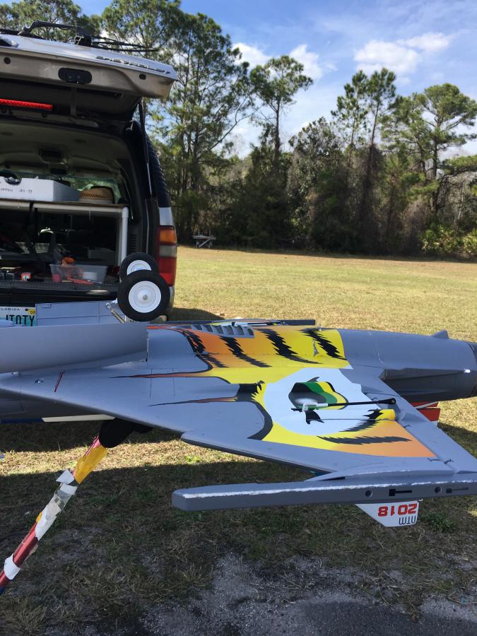

          Click image for larger version  Name:	DE7EFFE9-0FAE-474F-8930-F328561B3889.jpeg Views:	0 Size:	115.3 KB ID:	297153 The Careful when landing specially too heavy load.
          Last edited by Mtpisgah99; Jan 31, 2021, 04:31 AM. Reason: https://www.youtube.com/watch?v=zsSB42_56NY

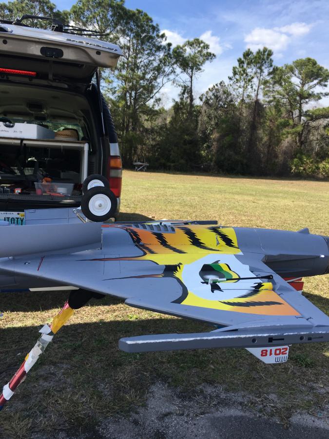

                Click image for larger version Name:	DE7EFFE9-0FAE-474F-8930-F328561B3889.jpeg Views:	0 Size:	115.3 KB ID:	297153 Careful when landing specially too heavy load.

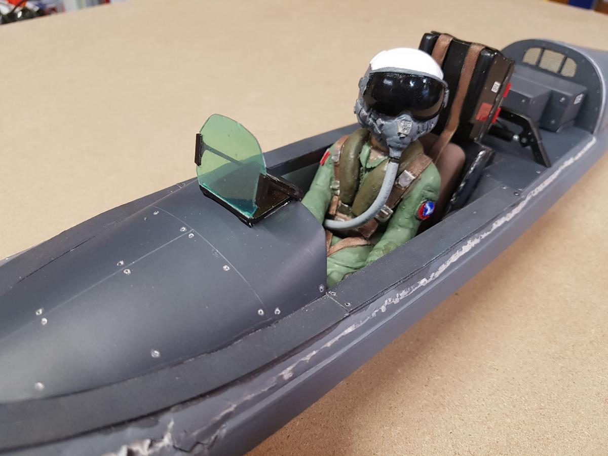

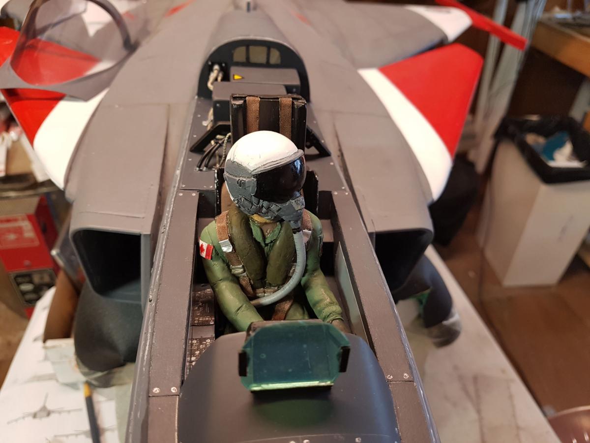

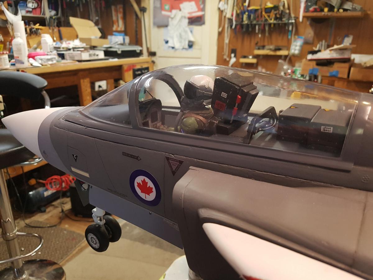

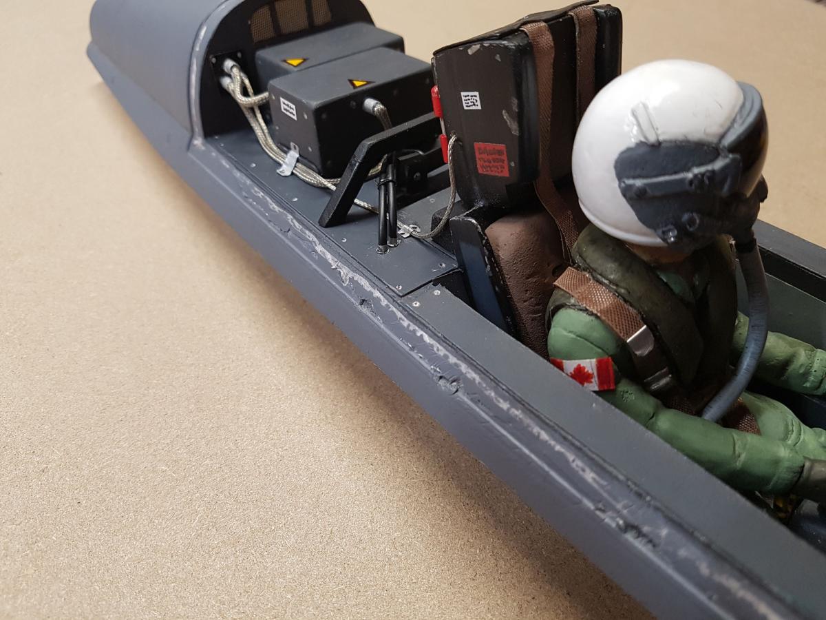

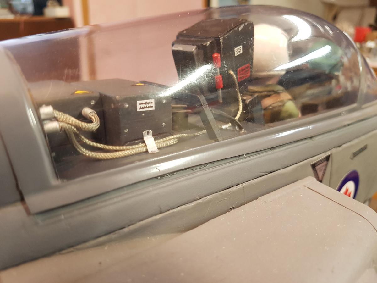

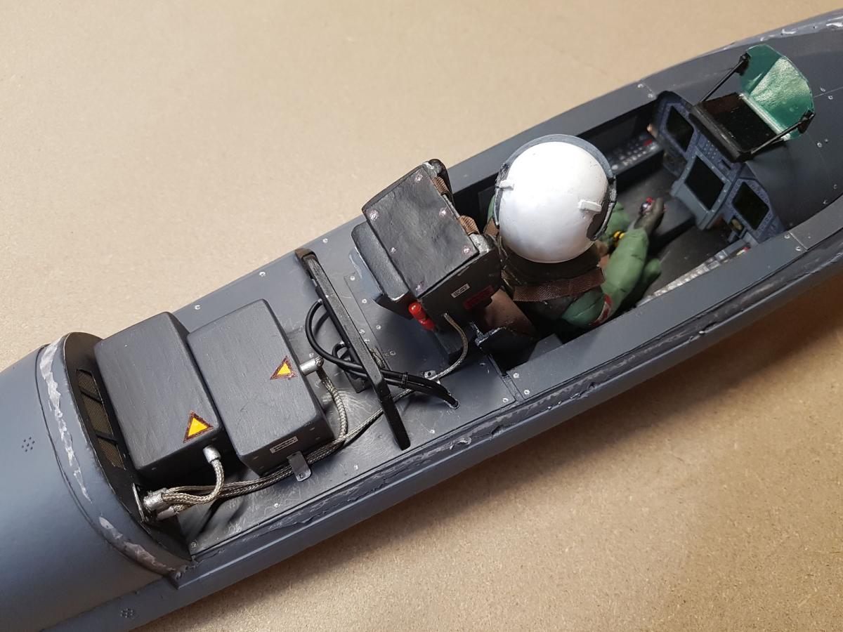

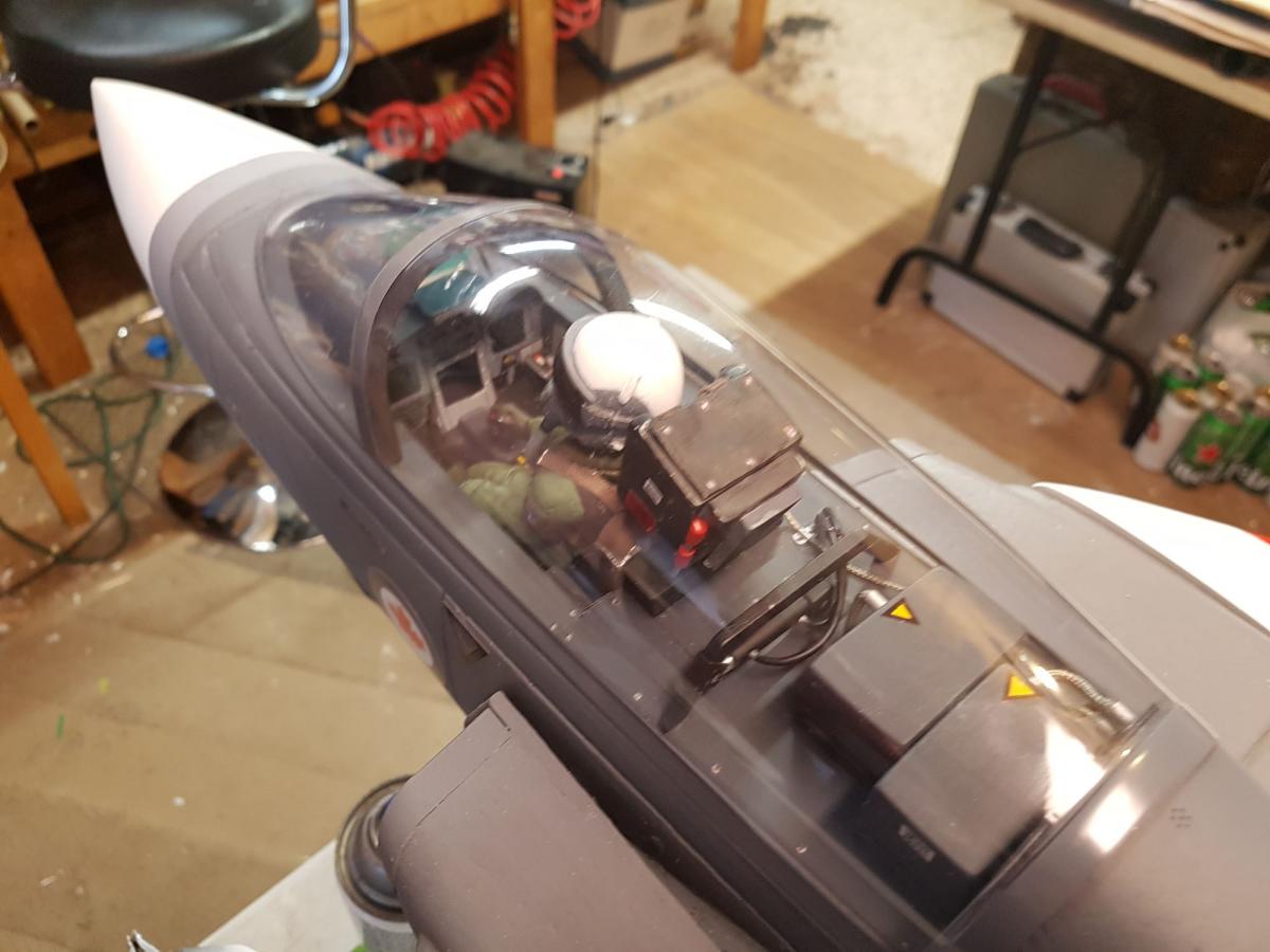

                  It's amazing how long a cockpit can take with all the fiddly details- lots of compromises with scale too but here it is. It was hard to find good photos of the rear deck equipment so it's very much an approximation but I guess the main aim is to maker it believable.
                  The pilot is a JHH 1/10 figure (not sure if they're still in business) and the canopy frame was made with "lightweight foam clay" from Michaels. Weight gain over stock is 35 grams- not so bad but of course this jet doesn't need more weight in the nose.
                  Just a couple of rear view mirrors to add and I'll call it done and glue the canopy back on.
