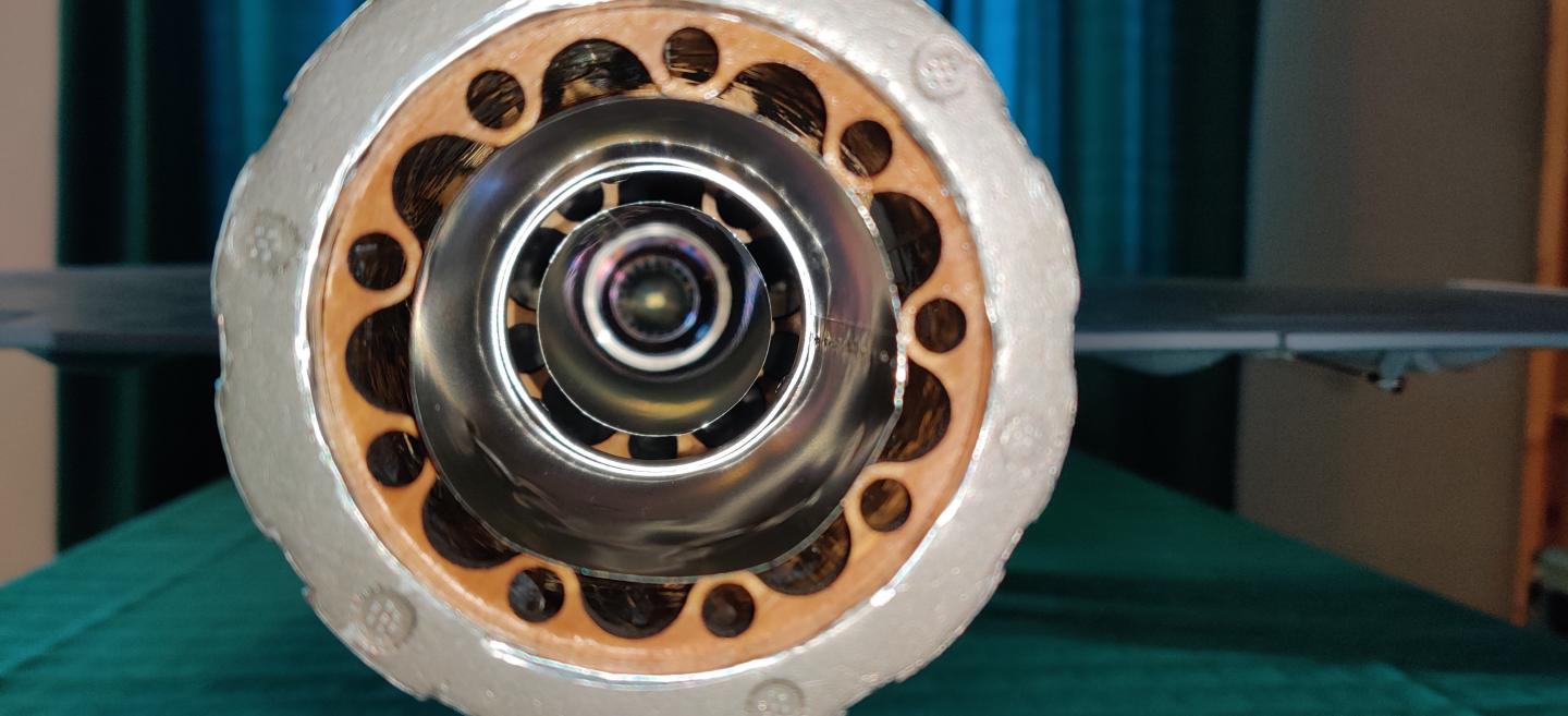

          Tested the Jetfan today. The plane still flew fine with CG 24mm aft from factory marks on the wings. The jet clearly had more power but I also noticed that closing the cheater with the net made the gain not as significant as it could be.
          The bad news is that I crashed, as I drained the battery in bare 3min of use. I didn't even push the jet hard through the flight as I was testing it, so clearly, the 8S 3Ah packs are kinda limited for this setup, despite being perfectly fine on the Eurofighter running a 90mm fan. Cells came down at 3.2V, my bad.
          The good news is that I kinda managed to drop the jet on top of some bushes and the damage was minimal.

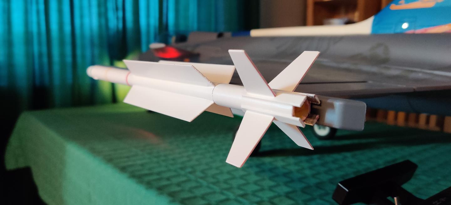

                        Did you check Thingiverse? There are several 1:9 scale missiles on there (I have posted Sidewinder and IRIS-T, and someone else posted a Meteor.
                        Sidewinder at 1/9 scale for Freewing Gripen. Lug fits the keyhole in the wingtip rail.The mid section has breakaway support at the base to stabilize during upright printing. They look like fins with pads at the base. They can easily be removed after printing.Suggest printing lug solid for strength, 15% infill for the rest.
                        1:9 scale IRIS-T missile with lug to fit Freewing Gripen wingtip rail.The nose section has some breakaway parts that look like fins to support it upright while printing. These are not part of the missile - remove after printing.Will need supports.Underwing pylons at https://www.thingiverse.com/thing:4713773
                        There are also underwing pylons posted.
                        These are a modified versions of the missile pylons by Bettsmums. These have their own mounting hardware. The lug and socket are the same as the Freewing standard. and should be printed separately with high infill for strength. The main body needs to be light - I used 10% infill. A socket is also placed under the wing so the rail can be removed. Depending on the accuracy of the printer, the lug and socket may need to be trimmed to make a good but not loose sliding fit.Be aware that there are small differences between the inner and outer pylons. They go immediately ahead of the bulges on the underside of the wing.Bettsmums' original is at https://www.thingiverse.com/thing:4708956

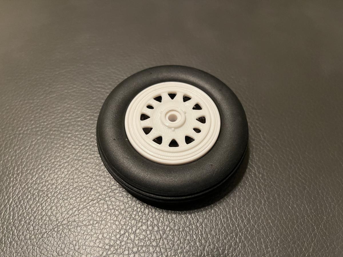

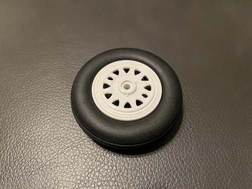

                                    Hi All. I uploaded a STL file for Freewing JAS 39 Gripen main wheel covers on my Thingiverse page and is now available for download. Hope this helps your modding ventures .

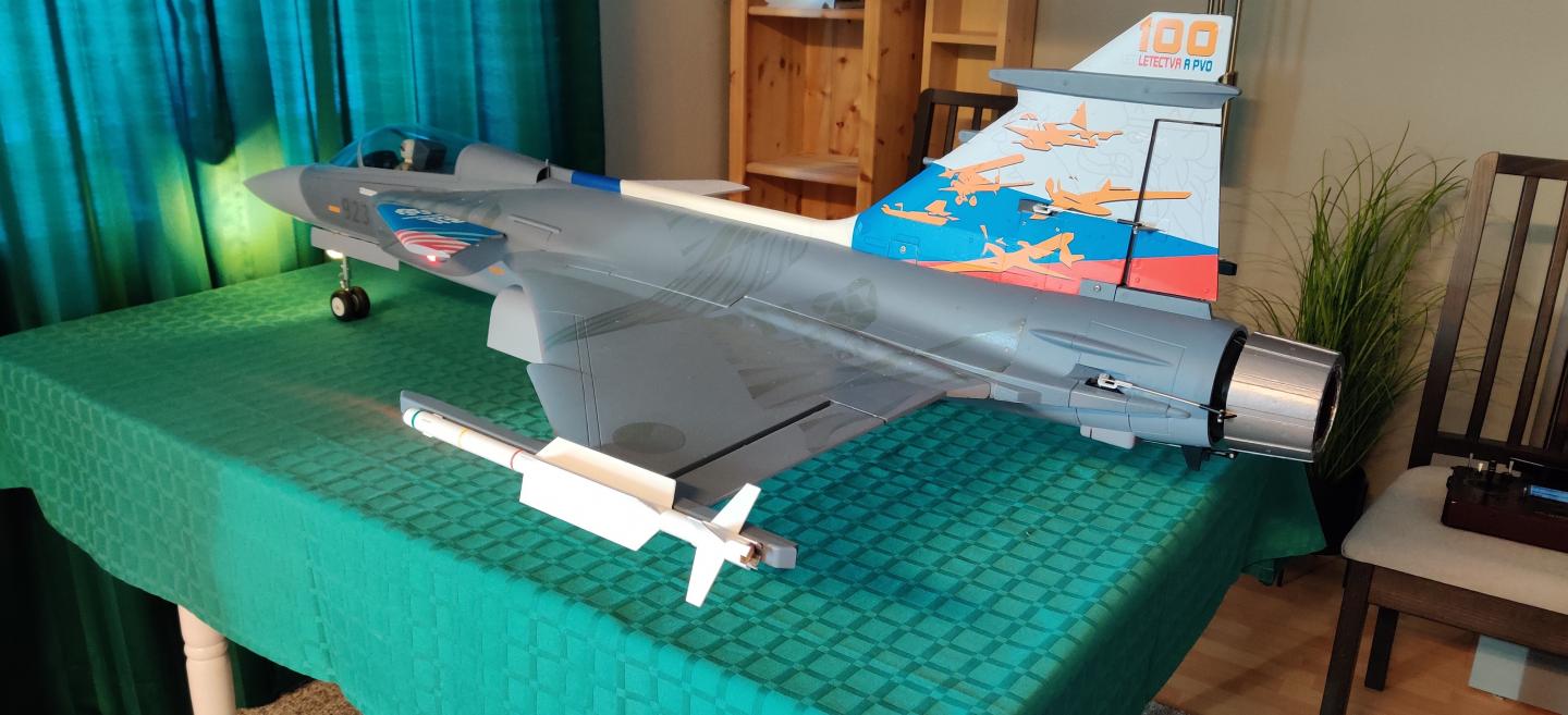

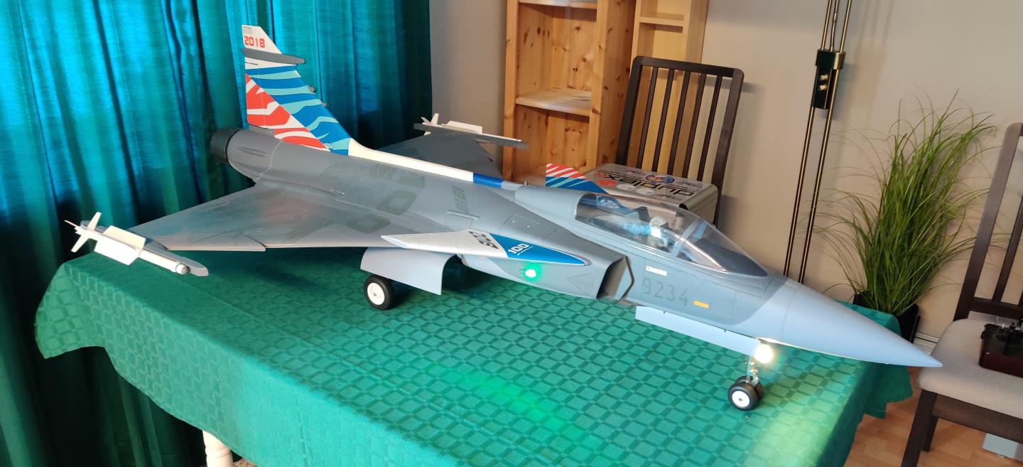

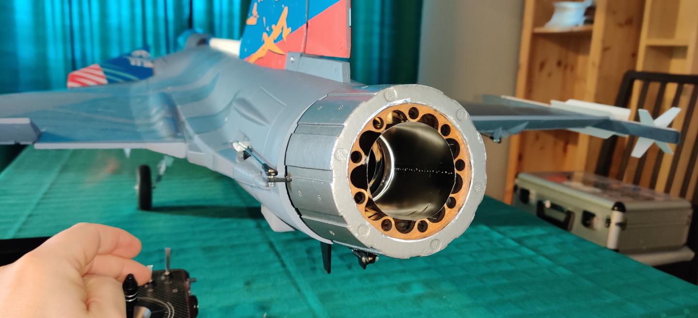

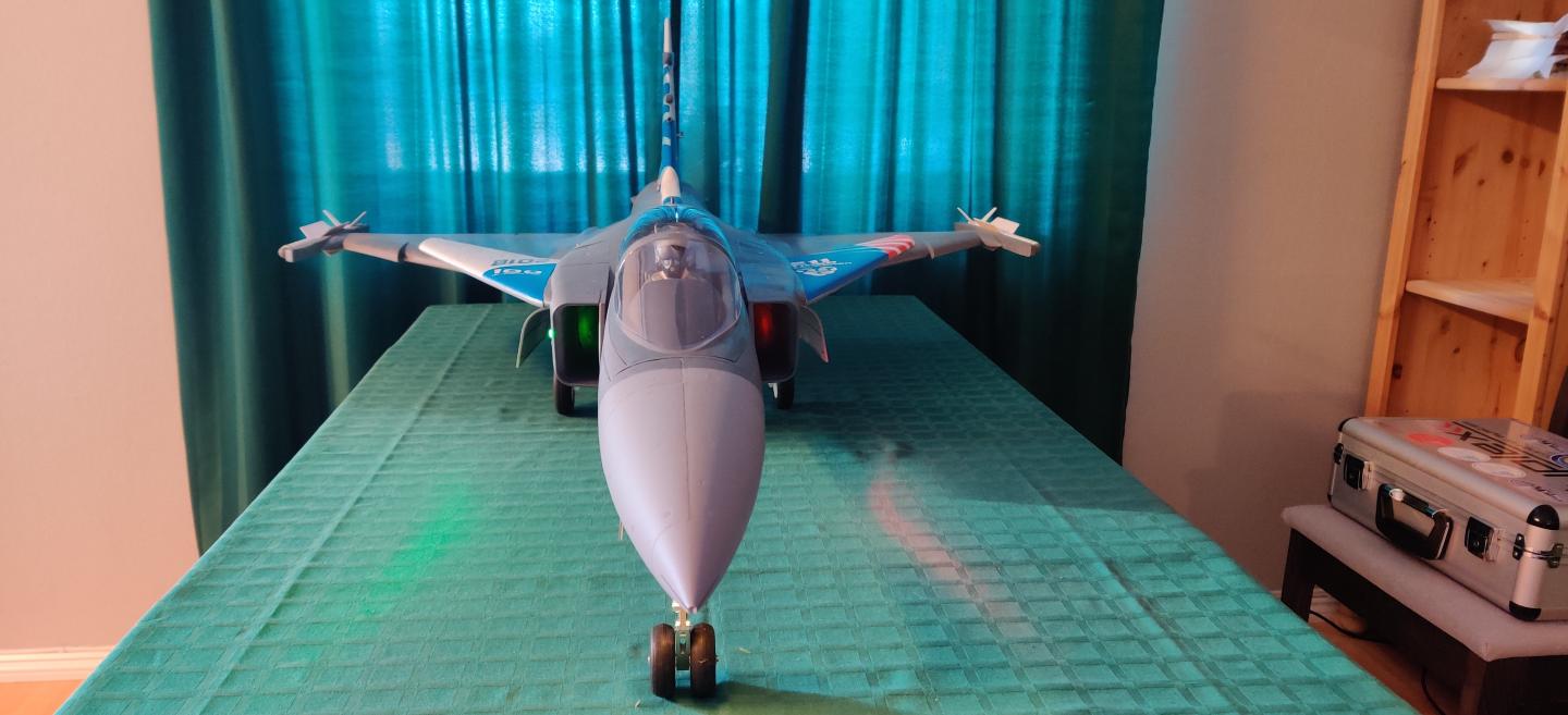

                                        All set for maiden tomorrow :D Click image for larger version

                                          Damn, so what you are saying is that the Gripen is more hungry than the EF? That is certainly not what I would expect.
