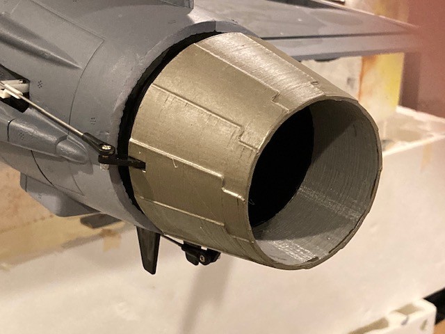

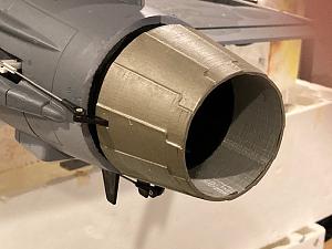

        #1683
        3DP VT nozzle.

          #1684
          Awesome!!!

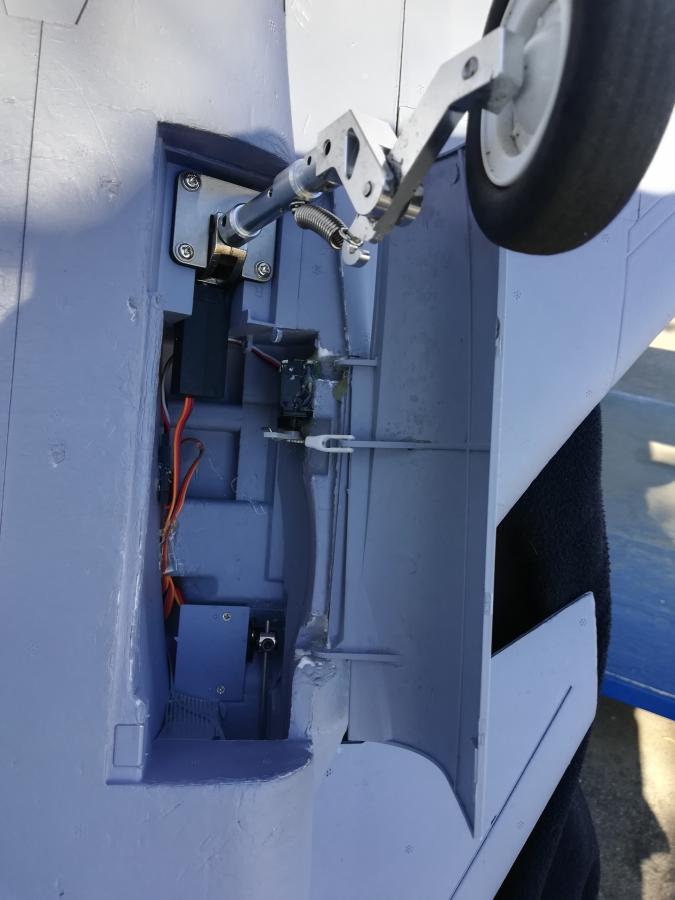

                                  #1696

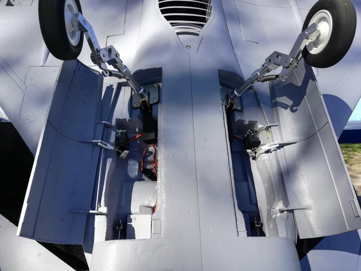

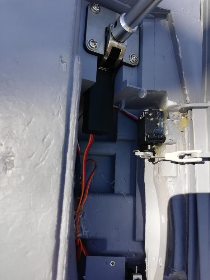

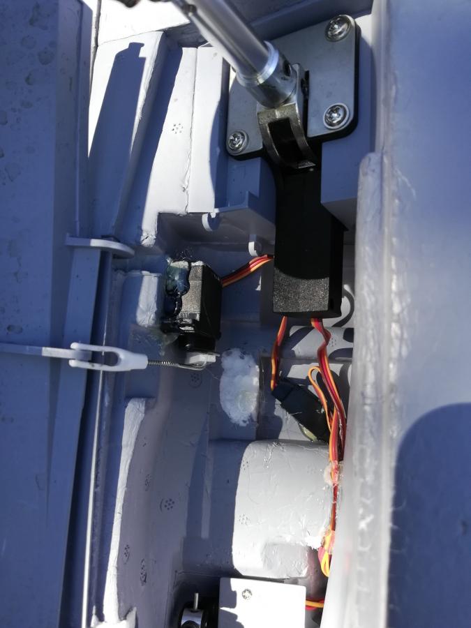

                                  Solved - Gear Doors Stay Open in Flight, Added Servos
                                  I found the problem to be air pressure in flight stalling retracts before fully closed, started after about 10 flights. I removed all the mechanical door links, springs, push rods, etc. and replaced them with added servos and links from EF2000 Eurofighter gear doors and a sequencer just for the servos to get max throw and added a 5 second down delay to the gear channel in the TX to allow the main doors to fully open. Now that the doors close reliably, my Gripen flights are back to normal fun and much better. See pics.

                                      #1698
                                      Yeah, mine do that too and stall out before fully closing. I upped the BEC voltage to 5.5V without effect on the gear.
                                      My solution has been to take off, gain some speed, flip the gear switch then pull into the vertical. The reduction in speed as it climbs reduces the air pressure and allows the doors to close fully.

                                        #1699
                                        Thats what I do also. seems to work well.
