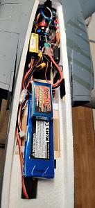

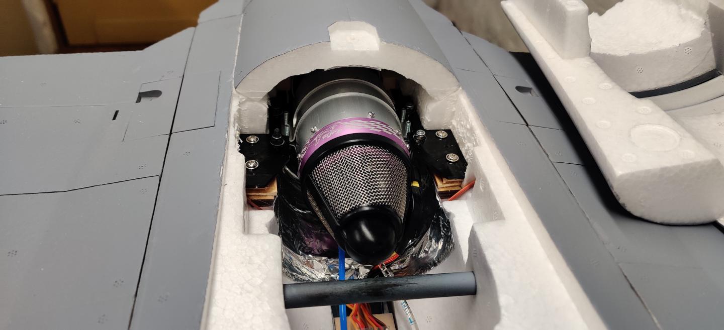

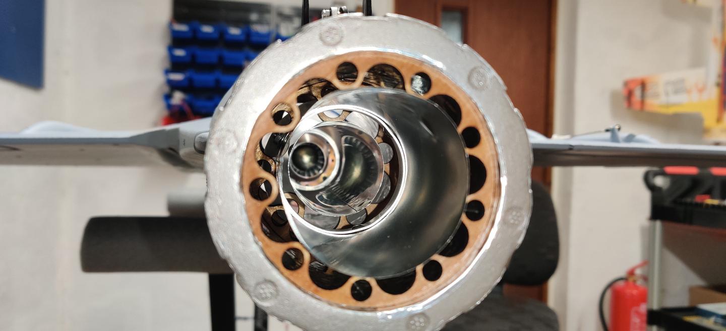

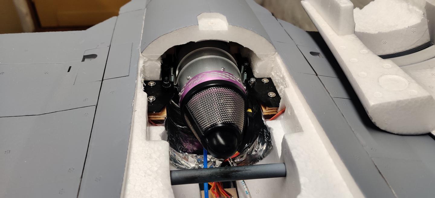

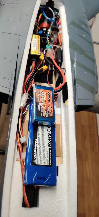

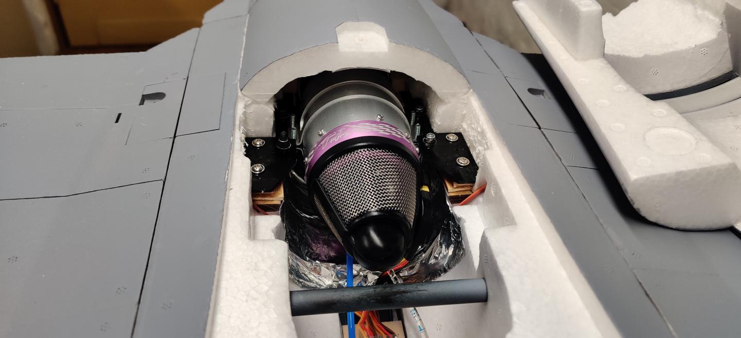

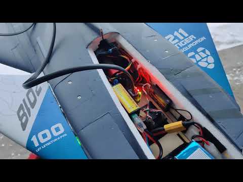

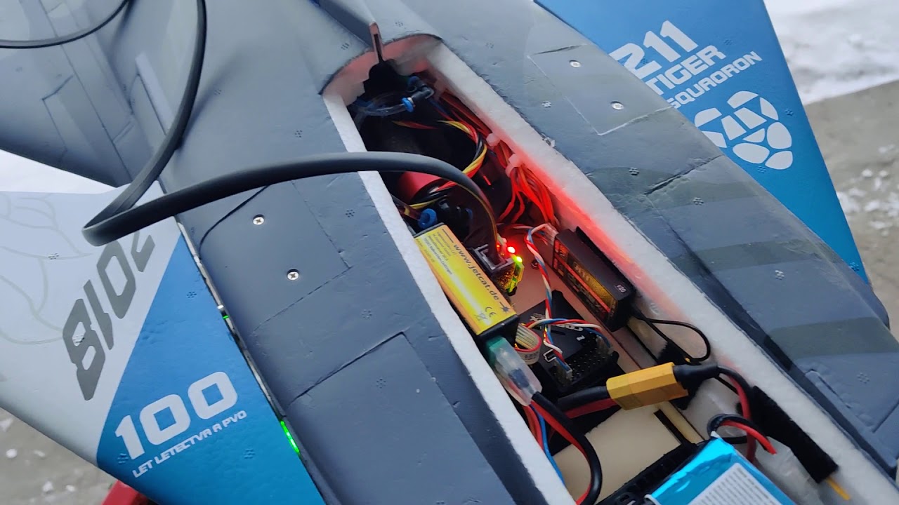

        • Conversion to Jet Cat P20SX finally done :D
          As far as I know, this is the first turbine converted foamie to feature thrust vectoring :P
          (video is loud!)
          Click image for larger version  Name:	IMG_20210119_133805.jpg Views:	0 Size:	88.9 KB ID:	295203Click image for larger version  Name:	IMG_20210117_220334.jpg Views:	0 Size:	57.0 KB ID:	295204Click image for larger version  Name:	IMG_20210114_000832.jpg Views:	0 Size:	88.5 KB ID:	295202
          • I hope this shows up on RC Tommy's YouTube Channel janmb. That looks great and clean.

              Thanks James, I'm sure it will!
