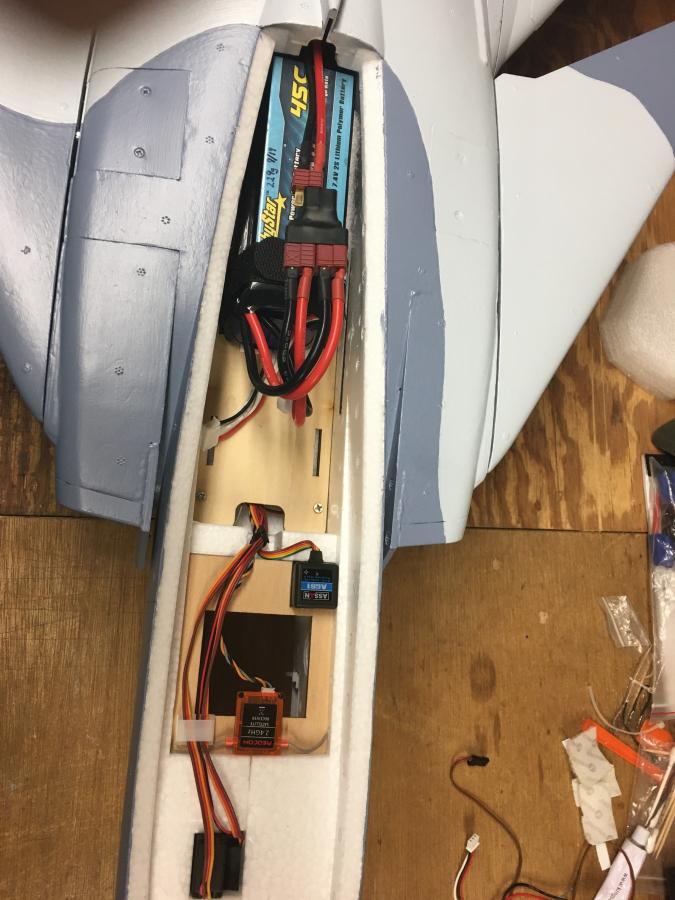

        • I am using a 6S plus a 2S. They are one atop the other. I'll find a picture. I post more in RCG than here and have more information and pictures there.
          There is a balance mark molded in the foam under the wing that I use as a reference. I am 15-18mm behind the mark.

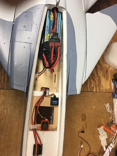

            Is your EDF a lot heavier than the 6s one? I can't get my battery as far back as yours without cutting into the foam that separates the internal compartment from the air intake plenum. I'm using the Gens Ace 5000. I don't want to cut into the foam to get the battery further back so I've added some tail weight and that only achieves balance at the marks (and that's with the VT nozzle installed). I see you've got the Assan steering gyro. How does that work for you? I also have one on mine but some say it's not required. I can't maiden till spring.
            • The picture was taken before the TVs. I would say it's average weight. The JF is about the same as the stock fan and shroud. The HET may be a little more than the stock inrunner but not much. I have a Turnigy 120HV ESC about the same weight as the stock 100A HW. My batteries and series adapter are 880g. Paint added a little, maybe more paint aft of the balance point??? I think I added 75-80g of lead in the stock rear fuselage to balance it at 15-18mm behind the mark. The TV rear part is 13g heavier than the old rear with lead. My batteries are 48mm wide so maybe I am able to push them back a bit more?

              • My Gens are 45C, 725g, 45mm X 45mm X 155mm. It's shoved right back to where the foam angles inward. I didn't weigh the weight, just kept adding till it balanced at the marks. It already looked like a lot so I didn't add any more to get the balance aft of the marks. Will fly it first (carefully) and see if I like it that way. It just seems like a terrible thing to have to add so much weight.

                • How much weight did you add?
                  • I never weighed it and now their stuck onto the plane. I used thin lead sheets that we used to use for radioisotope shielding when I worked in medical research. The sheets are about 2mm thick and I cut out what I estimate to be a strip about 3/4" wide and 12" long, cut into 3 pieces, 2 of which was doubled over. Weighing a similar strip of lead, it was 65g.
                    You can see the 2 double thickness strips on the bottom. There is one more single layer strip on top.

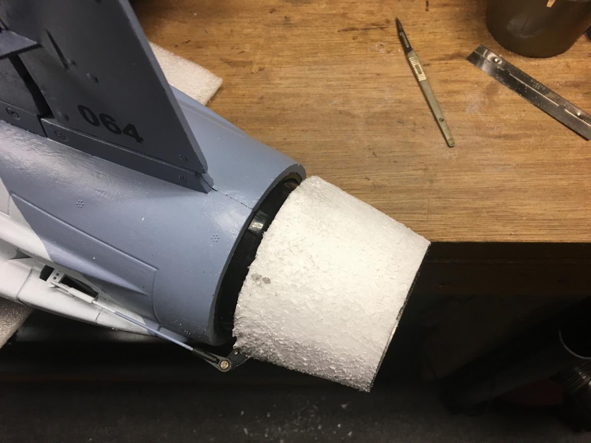

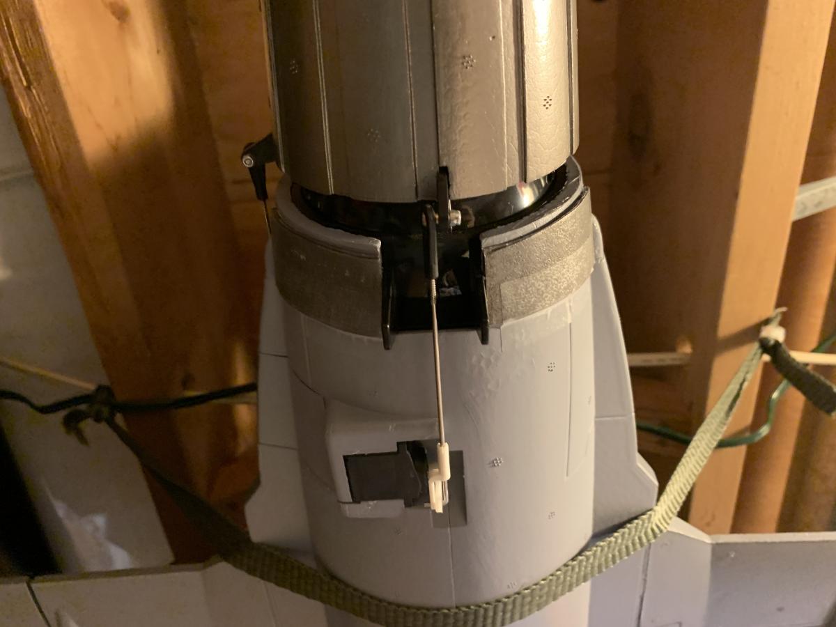

                    • That is very surprising. I would have never guessed you'd need that. Maybe when John makes a 3D printed exhaust it'll let you remove the lead.

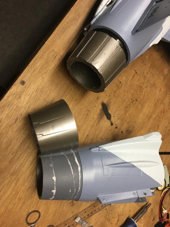

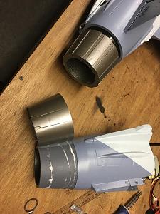

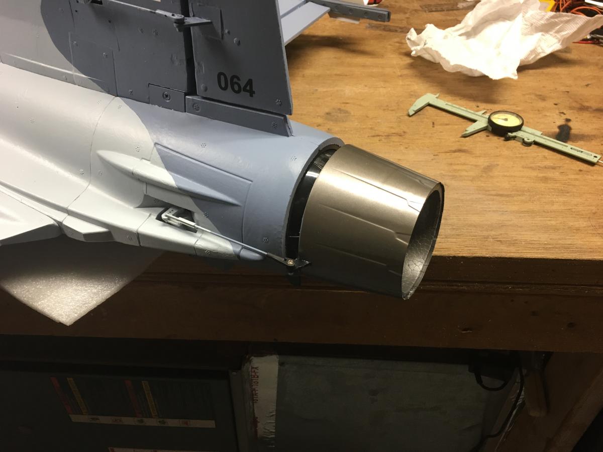

                      Not liking the foam nozzle I put the plastic from my old one on the TV nozzle today...

                      • One the one hand, 65g isn't a huge amount of weight. It just looks like a lot and it's awkward. I suppose when it's flying, they aren't that noticeable.
