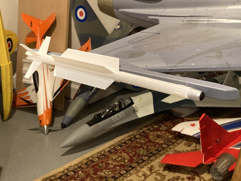

              Quite likely - I couldn't find a 3-view or definitive dimensions for the vanes so I guesstimated.
              Try now! (Pretty easy to clip them off with an STL editor if you still think they're too long.)

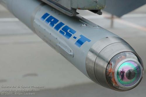

                Having replicated things for my work, I know proportions and dimensions can be tough. Especially when working with limited resource, like not having the true dimensions. I actually reproduced the aft end of a JDAM to true scale on a wood lathe for a subcontractor doing some systems design and development for the navy. The navy liaison actually called to find out where the heck we got the JDAM tail section. Anyway, I was using photos and scaling it up with known dimensions of other objects in the photos. The object was to impress the navy so the company that hired me didn't want to ask for dimensions. I ramble, I apologize. Maybe it's more interesting than bickering but who knows.
                I wish I had a 3d printer, it is in my future for sure..To be able to produce scale objects for planes seems very fun and rewarding.

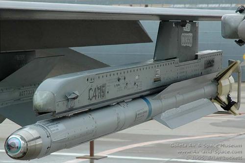

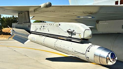

                Here are a couple of photos that maybe will help see the proportions. Different angles and lighting helps. With the IRIS it's hard to see the fins when the missile is mounted with the fins at a 45. I've been trying to find a view of it with the fins in the vertical position. But no luck, I hope this helps. Thanks kallend I know once I dive into purchasing and using a 3d printer the existing designs out there will be much appreciated, just saying thanks in advance. Click image for larger version

                    Thanks. I finally got a good dimension for the long lateral fins. The narrow chord ones at the tail are still a bit of a guess. Updated the Thingi files.

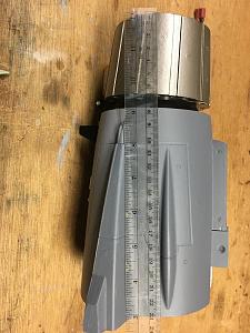

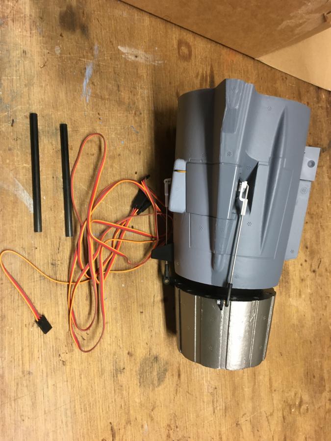

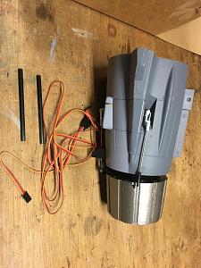

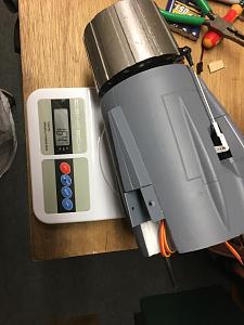

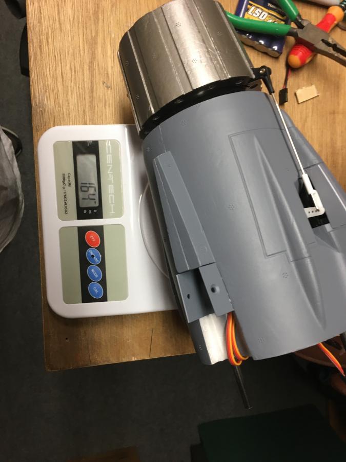

                      Just finished installing the VT nozzle and setting it up in the TX. The actual butt end swap took 15 minutes. Hooked up the ELE servo to AUX2 and mixed it. The rudder servo is just "Y'd" to the rudder channel. No reverser was necessary. As mentioned before, the color of the VT section doesn't match the color of the fuse it grafts onto. The nozzle is much lighter in color. Doesn't bother me but for some, this will be very irritating. It won't see any air time till spring, unless the dreaded climate change warms everything up and clears the runways.
                                  Here is the revised version. Same Thingiverse location.

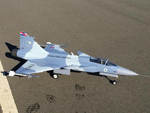

ID:	293089Click image for larger version  Name:	89950730-0AF0-4884-A702-5D16CEA822F1.jpeg Views:	0 Size:	195.9 KB ID:	293087

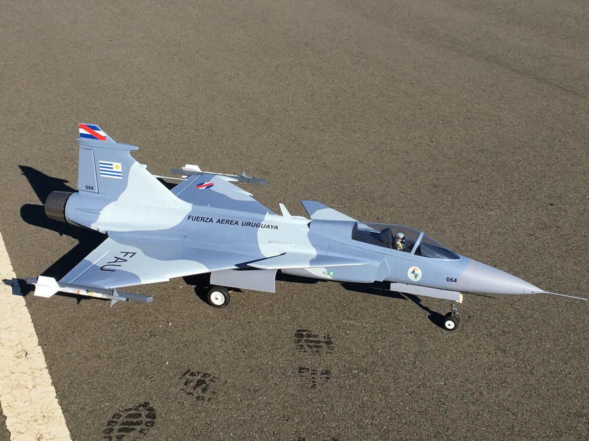

                                      On the plane in the picture above. Flew a bunch of flights with it and like it. I put more info about my set up and numbers on RCG.
