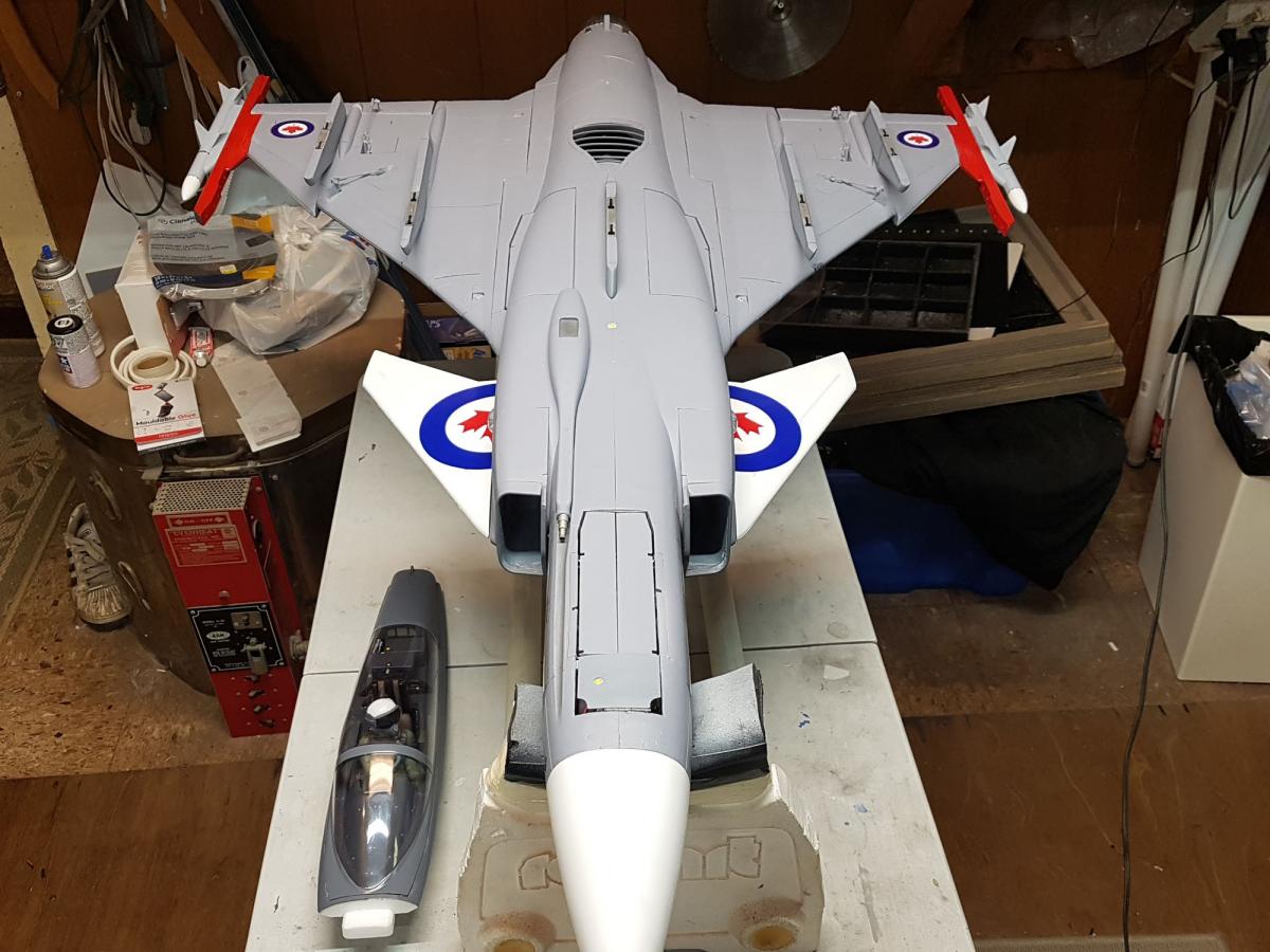

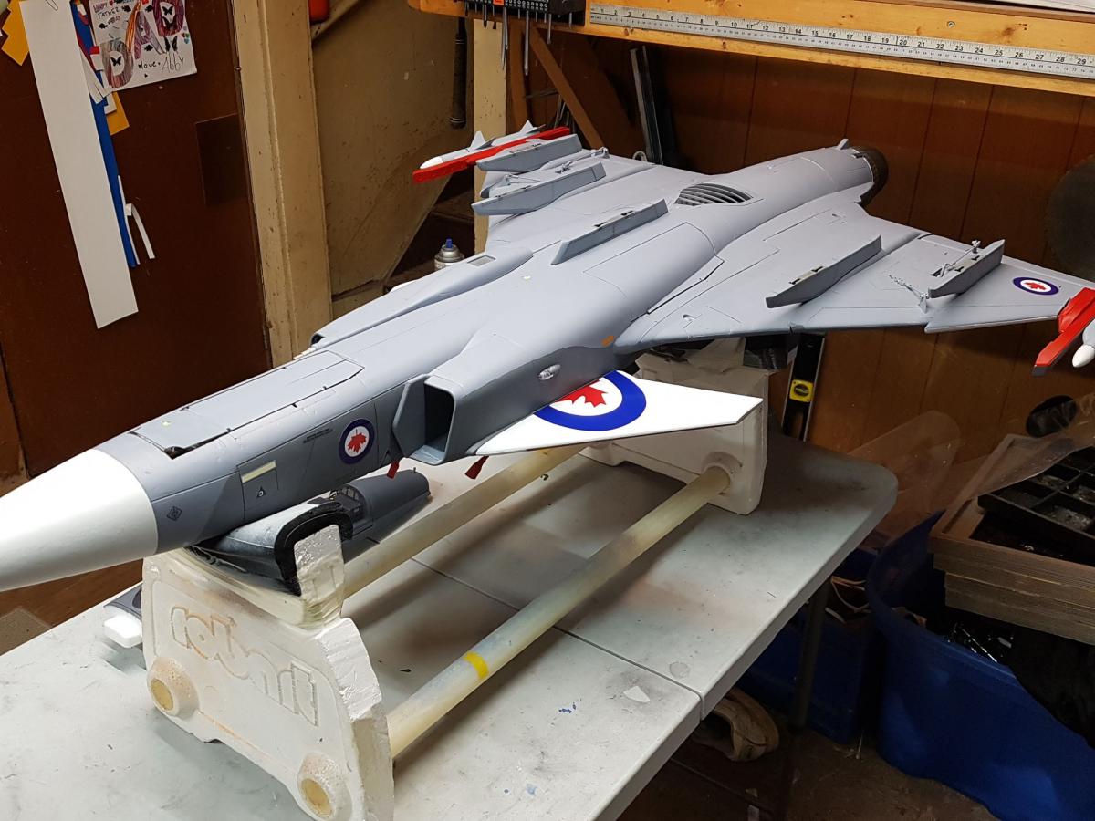

                The nice thing about a fictional demo scheme is it can keep evolving. I added rondels to the bottom of the canards today, vinyl from somewhere I've had for years in the stash.
                Tom

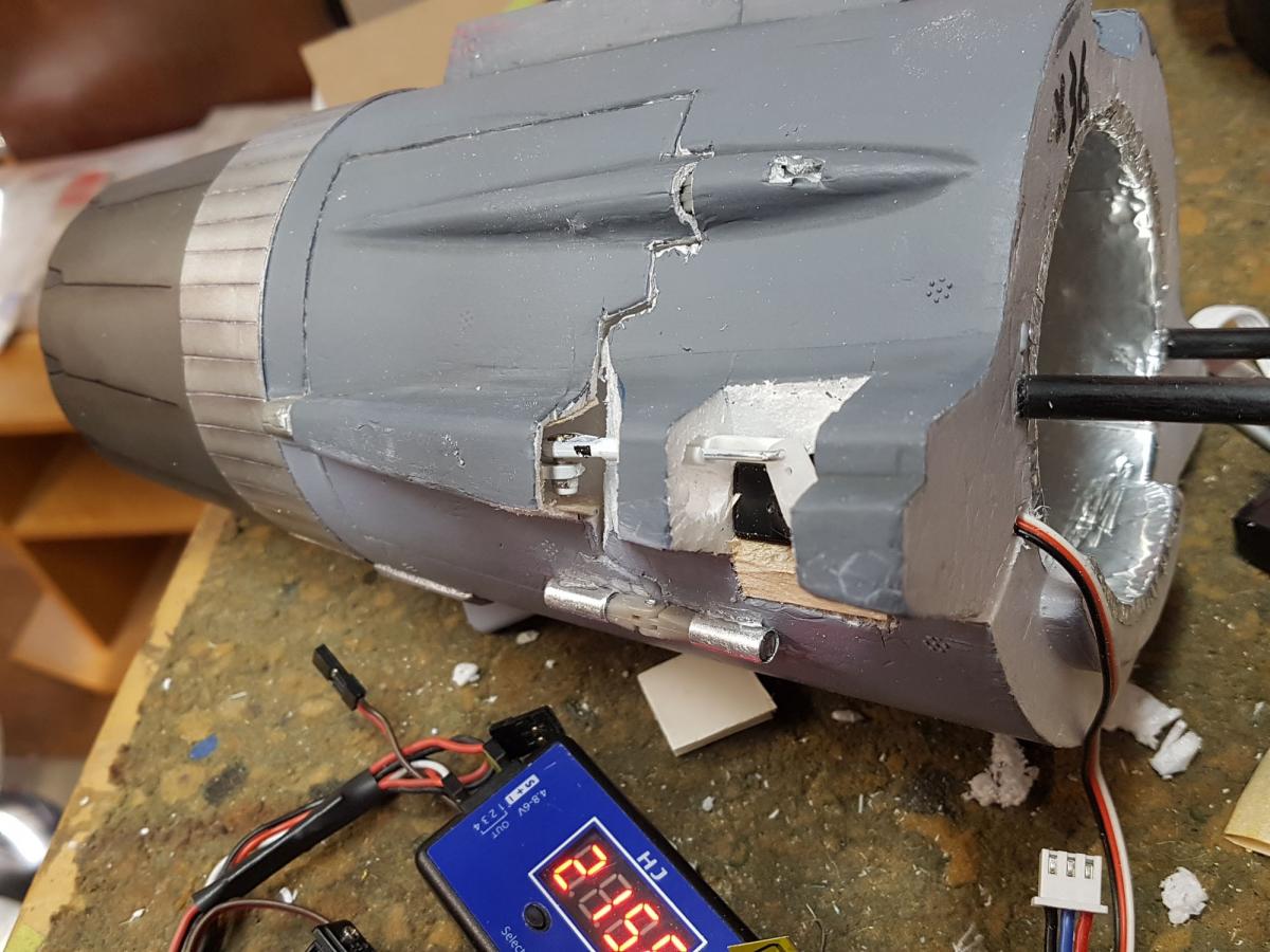

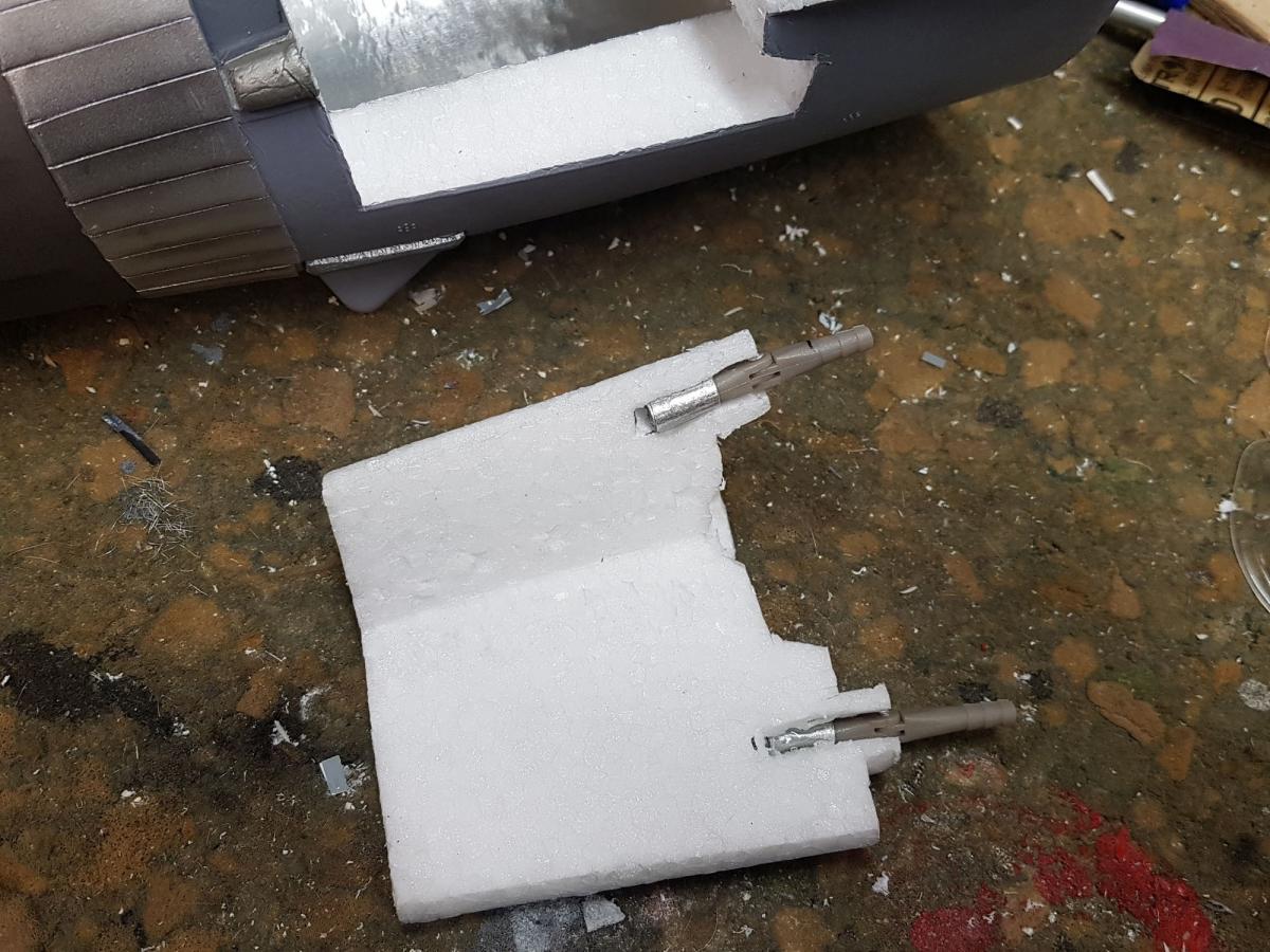

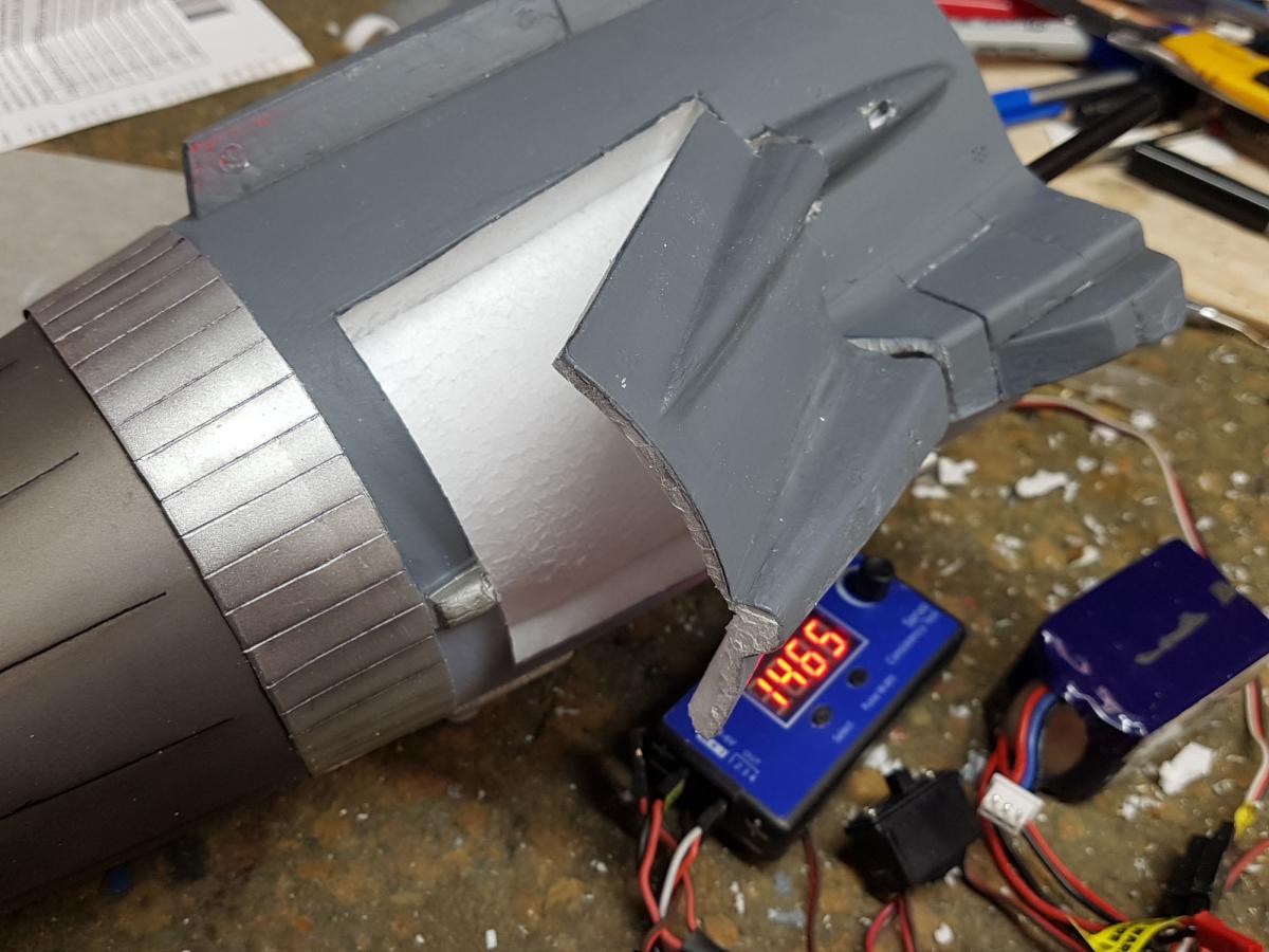

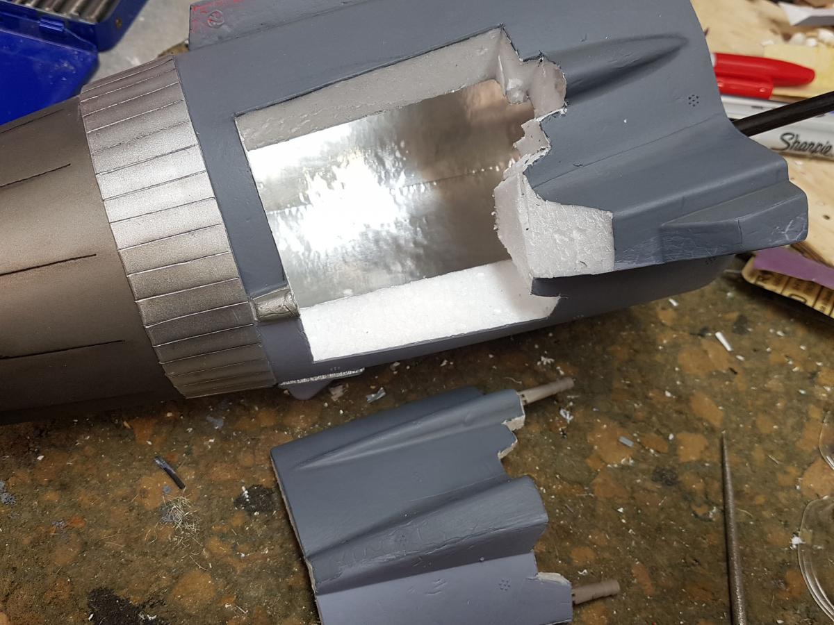

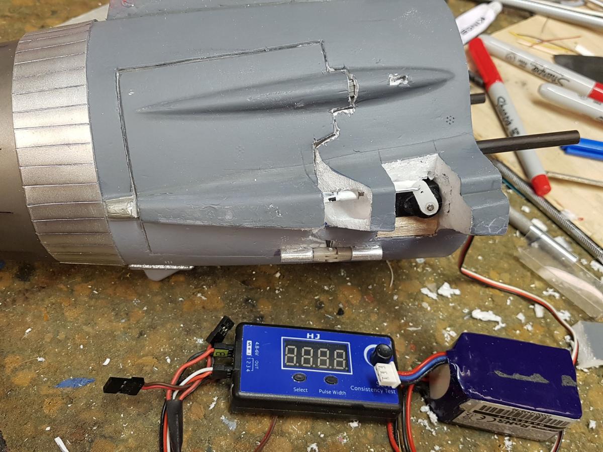

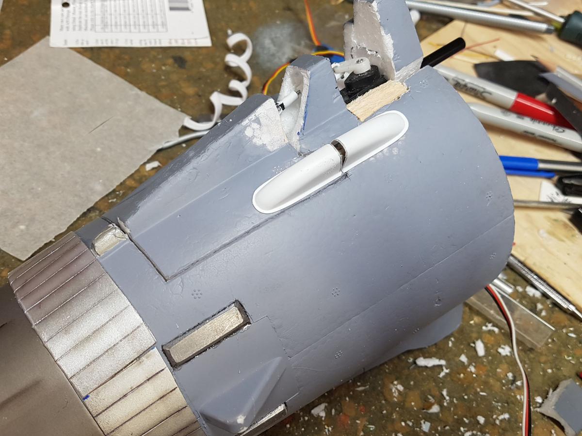

                  Due to the extra weight of the cockpit the model still needed lead in the tail so I decided to attempt making the air (or speed) brakes functional and add useful weight. This looks pretty rough but some filler, paint, and covers will help- but at least it works!
                  I fooled around with the hinging and eventually put the bottom one outside the skin- not scale but it's the only way the panel would open. I don't think SAAB got it right...
                  Tom

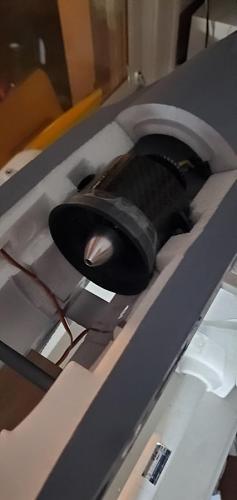

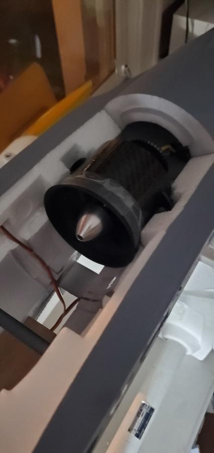

ID:	298363This is how I fixed the weight distribution issue.... Moved the motor back. 8S no counterweight.
