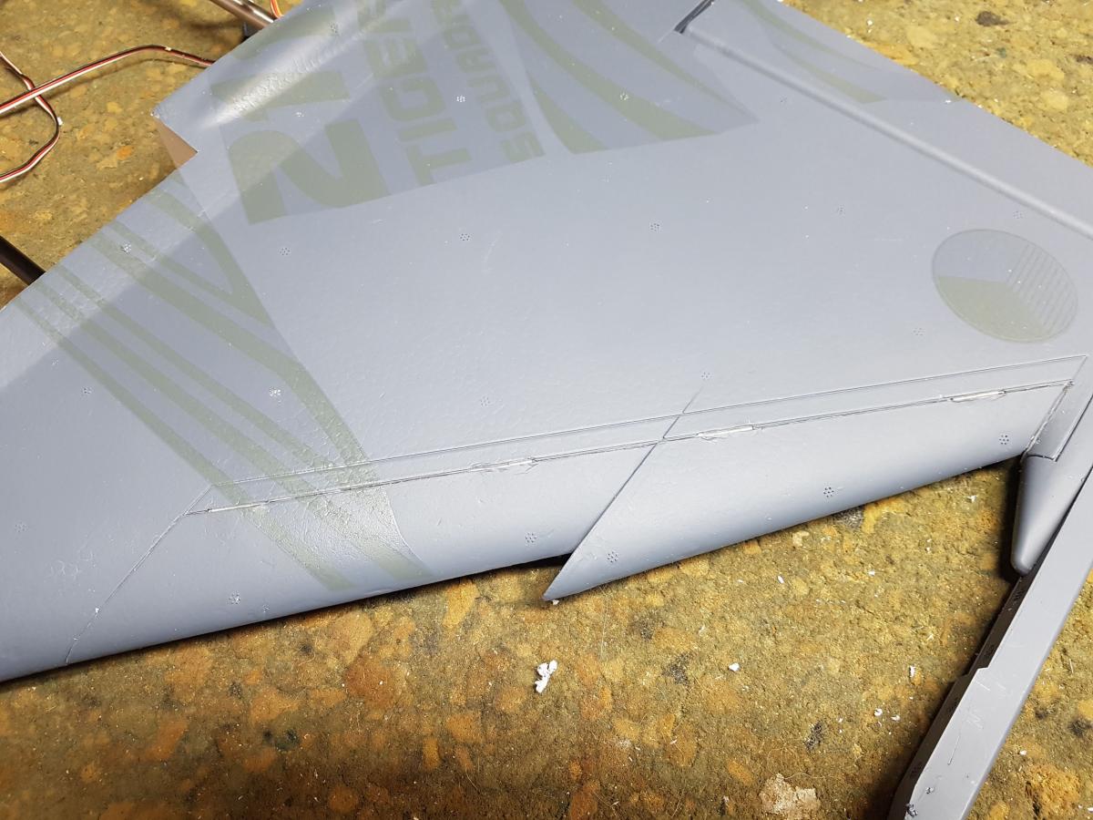

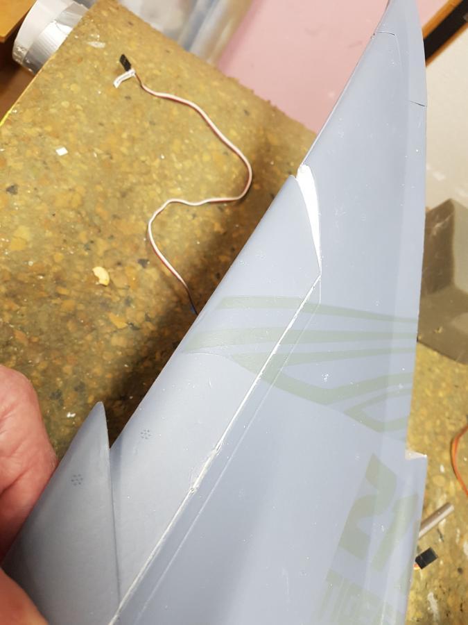

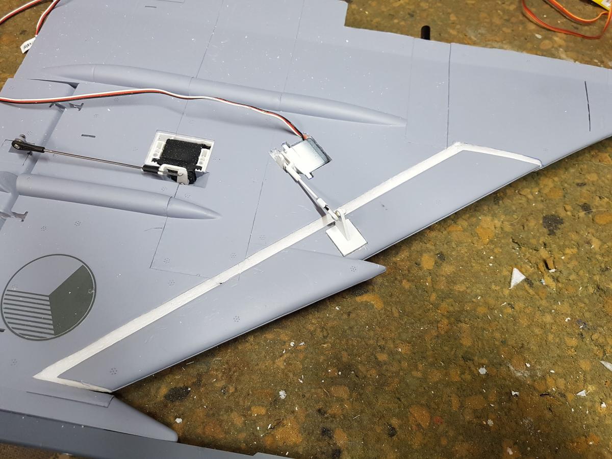

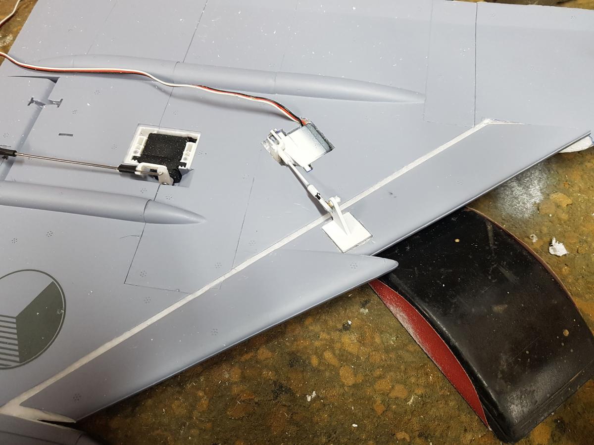

I decided to go ahead with the LE flap modification I've been considering and got a good start on one wing, cutting out the shape and installing hinges, the servo etc. Nothing is finalized (glued) and it's very much a WIP but looking pretty good so far, I think. The LE drops about 25 degrees right now, which doesn't look like much, but as it's such a large surface span-wise, and on the front of the wing, I'm thinking it may be enough travel, but of course don't know. At the moment I'm trying to figure out a good way to cover the gap on the underside of the hinge line when the flap isn't deployed. Comments and ideas are more than welcome.
Christmas vacation started today so I'll be able to get some quality time in the aerospace facility uninterrupted by work.
TomComment
