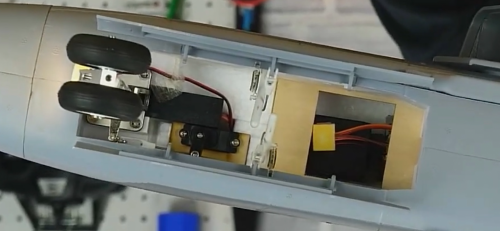

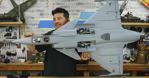

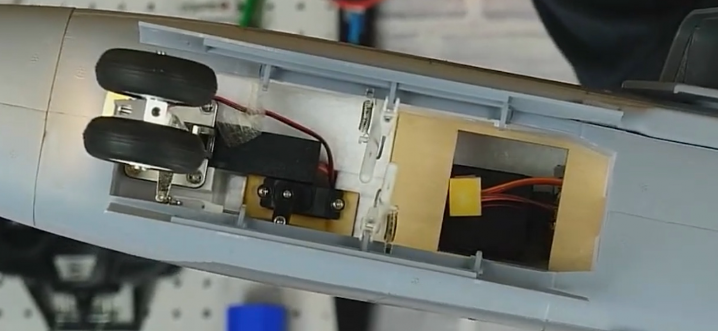

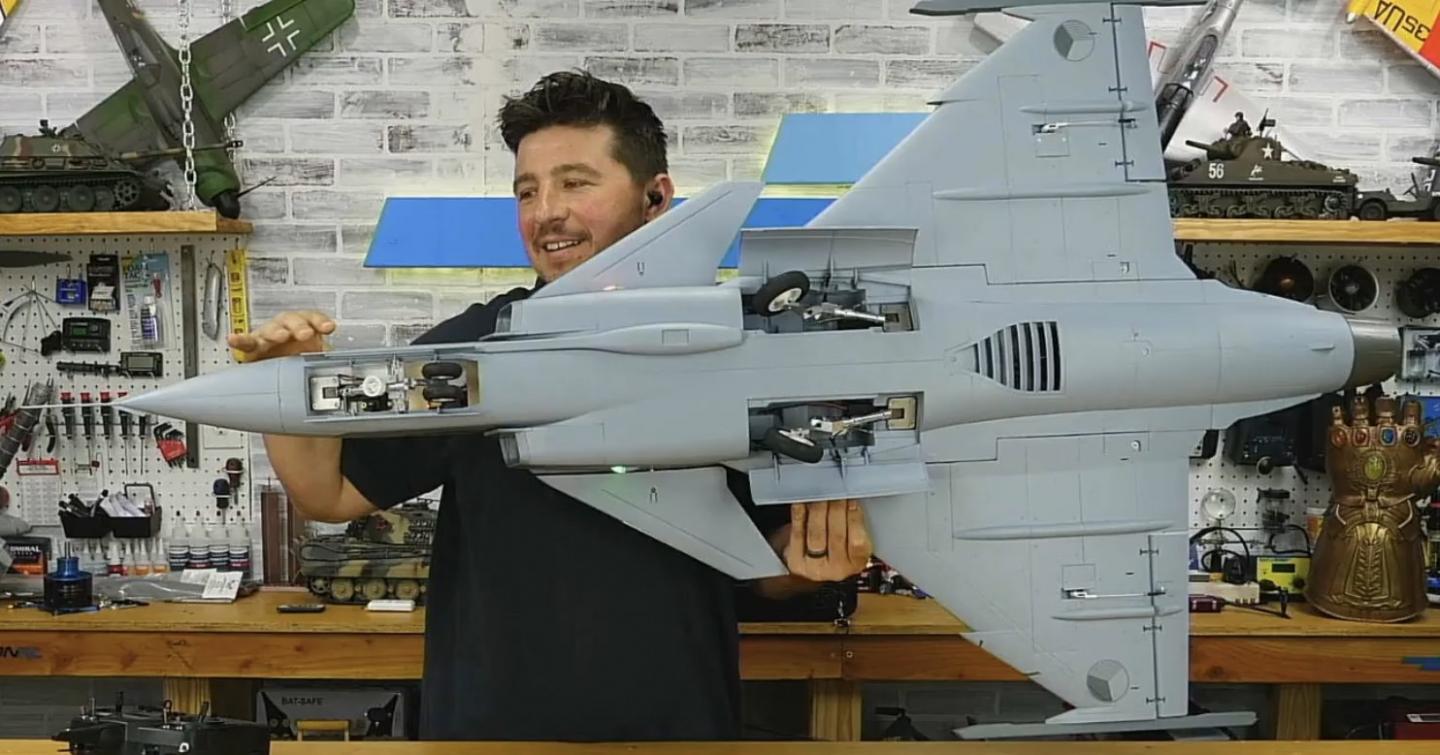

          Originally posted by RRHandy View Post
          You want battery room or nose gear in the scale position, Can't have both, shame .
          I believe you can have it in the scale location it will just have to retract forward. I’m sure Alpha will speak to this at some point.
          From my observation grass field ops is one of the biggest reasons.
          The jet at the scale location would also be much easier to wing tip while taxing at high speeds.
          I plan on modifying mine as I fly from nice asphalt runways.
          Literally just pull out the mounting block and remount with a support plate at the back of the bay. Put in a longer steering arm. Reverse the strut on the retract peg.
          Stock gear door closures may even work in their current place.
          If it worked well in the scale location it would have been put there, so it obviously doesn’t.
          That is the great thing about this community though is all of the modifications that people are able to achieve!

              Good points, Justin. Yeah, knowing Alpha, I'd imagine he had many reasons in designing the nose gear the way he did. He always does.
              I too enjoy the more scale location of the nose gear, and I'm always more inclined to like the look of a model more when it is closer to the full scale. However, I always understand that they design with tradeoffs in mind, just as Alpha mentions in this Twitch streams (plug......plug.....watch Alpha's Twitch streams on Tuesdays and Fridays at 9pm Eastern. AlphaMakesA is the name of the Twitch channel).
              The same thing happened with the Freewing F-22 90mm, which has a really large nose wheel from the Avanti, noticeably far forward positioned nose strut, and massive nose doors, none of which resemble the full scale. To me, it looks better flying than it does on the ground because it hides all of that when the gear is retracted . The scale geek in me died a little when I saw it, LOL. I get it though, design tradeoffs, and Freewing and Motion are aware of it, all of it. I fly off pavement, so grass concerns aren't something I care to think about. As people know, these models aren't meant to be insanely scale Top-Gun award winners. I'm sure they can make it like that, but it's not always for the masses.

                    You're right, I do always have a sensible reason for sensible design, don't I?
                    The stock location of the Gripen's landing gear made the model incredibly prone to tipping over, which was significantly reduced once we adjusted the nose to its current position. Fun fact: We relocate the position of almost all scale aircraft so they are easier to handle on the ground. Most people don't notice its diversion from scale. For those that do, consider it a fair challenge: We made the airplane itself, so you're 99% of the way there, and now you get to tweak the landing gear to your own satisfaction.
                    Beware, though, the ground landing of the airplane will change. Relocating the F-4's mains back to their scale position will result in a very nasty "pop" off the ground instead of a smooth rotation, and the same for the A-4. Using a scale gear layout for the F-22 and T-33 will reduce its capabilities on grass, and same for the F-15. The F7F and OV-10's struts are optimized for mass-producability even though they weren't strictly scale. The F-18 and F-14.... most people were enjoying flying the airplane to not fret too much about their gear's non-scale configuration.
                    While we're at it, none of our wheels are ever scale sized, either. *gasp*
                    Sensible changes and a balanced feature set that make a flying model available to the masses at a sensible price. That's my target.
                    Mizer67 I think you'll find that the Gripen's door setup is very different from what we did on the Mirage over five years ago. The Gripen's door hinges, control arms, geometry, and spring tension are all optimized to keep the doors closed only when you want them closed, and open only when you want them open.

                        I imagine the retraction direction played a part too, so while you may be able to mount the nose gear further back, you either reverse retraction direction (which ain't scale either) or totally mess up the battery compartment space and end up with something like FMS/E-Flite's Su-30, where the battery has to go so far forward in the nose that the jet becomes essentially a joke. I didn't get that Su-30 despite being a heavy Flanker guru, and instead jumped straight in into this one despite nose gear position so... ;)
                        For my part, I'd rather have the nose gear being placed like this if the alternative is to totally mess battery placement (which affects CG range, battery selection and parameters that are much more relevant to actual flying qualities).
                        That said, I may risk getting the tip-overs and reposition gear all the same. Should be easy enough! (Hopefully!)

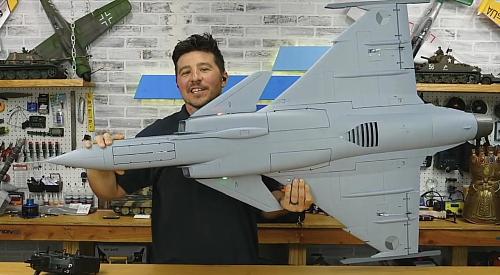

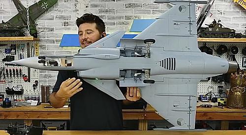

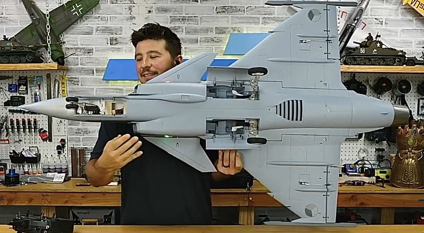

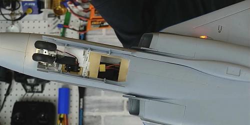

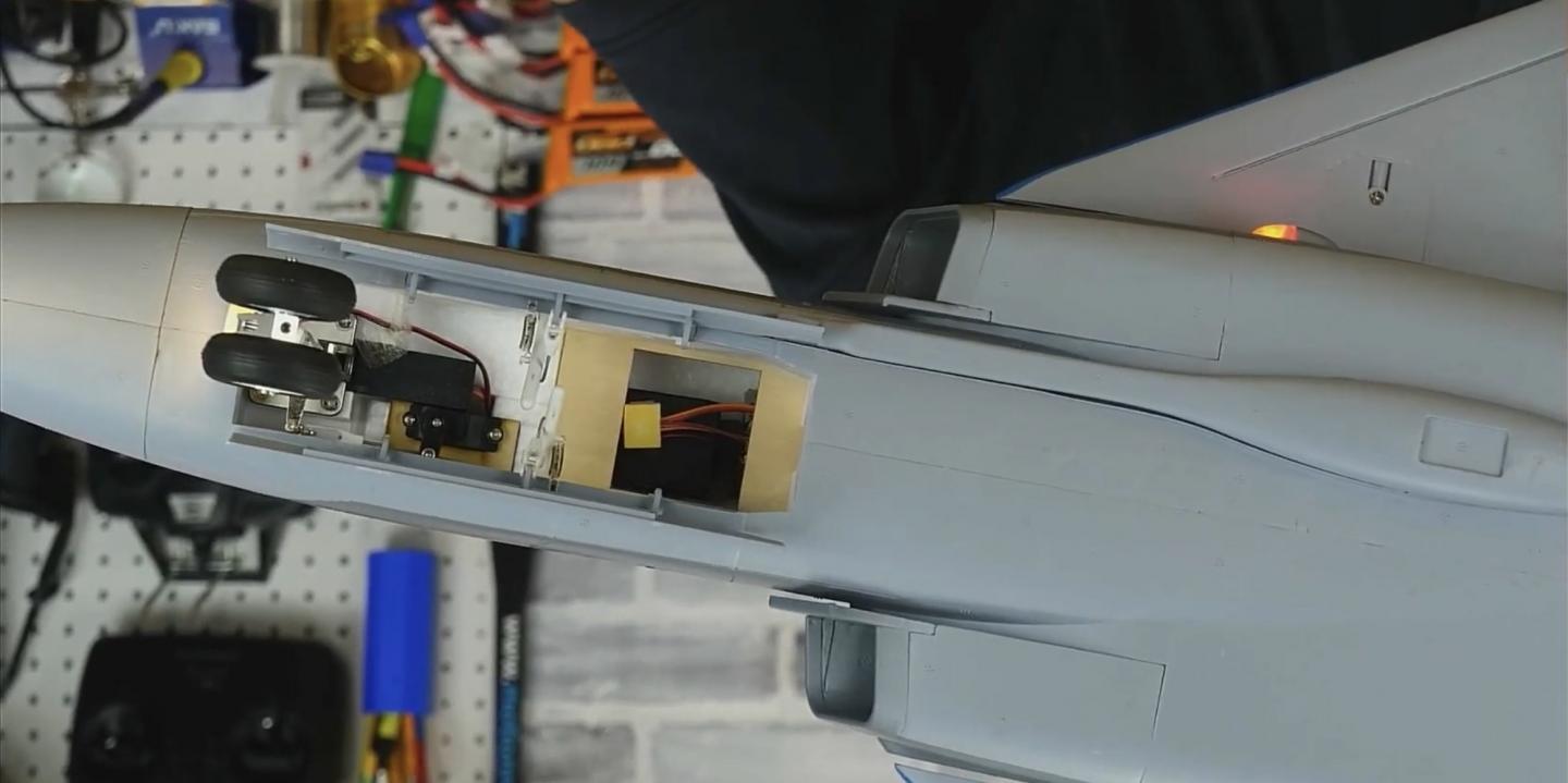

ID:	271398 Love the outline on this. Can’t wait to knife edge with it!
