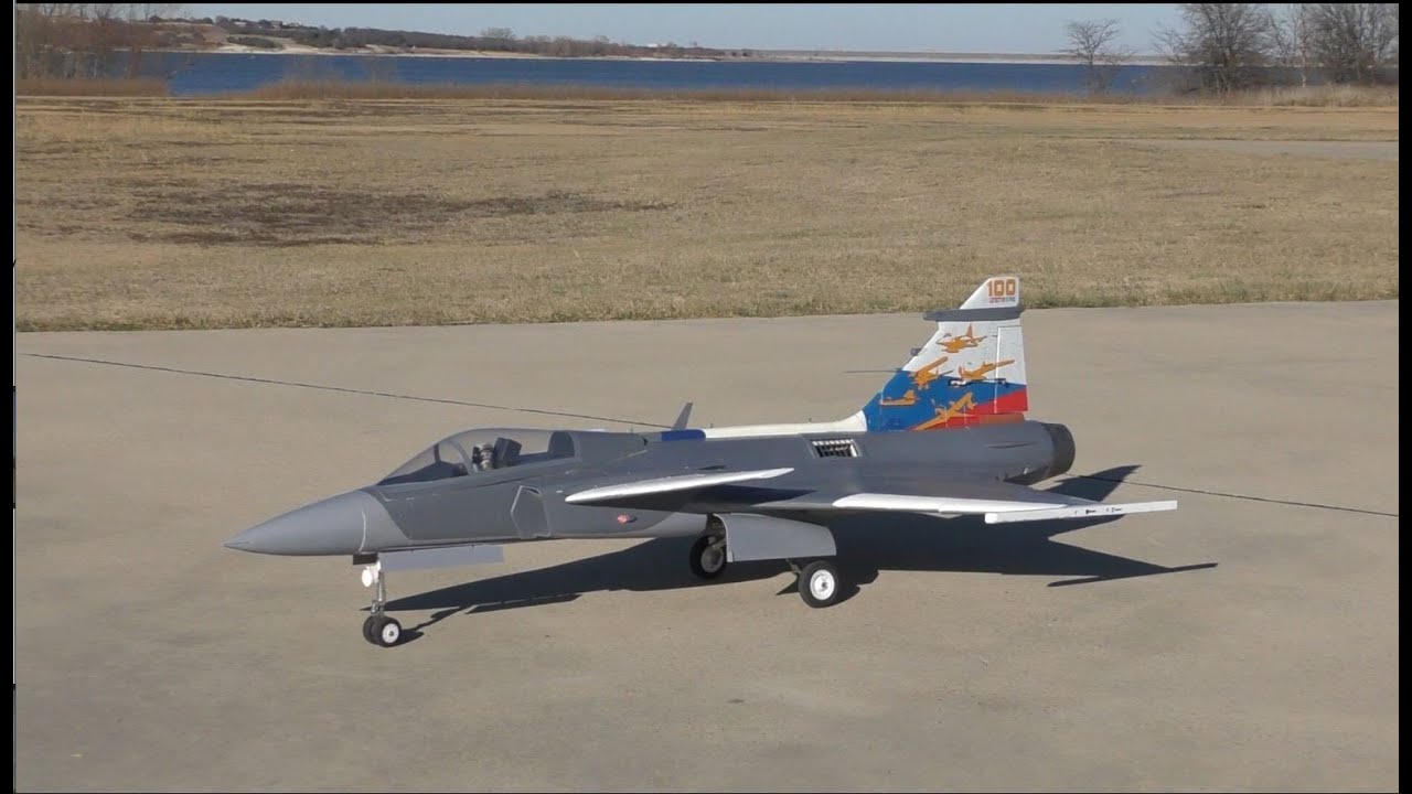

    My Gripen has had a great life and was already highly modded. So I was switching all my TX RX over to FrSky X20s and....well I decided to go from 80mm 8s to 10s 90mm. (lots more modding) Just had my first 6 test flights and decided to do as speed check because its moving really fast....
