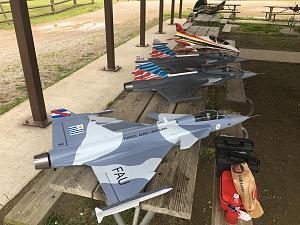

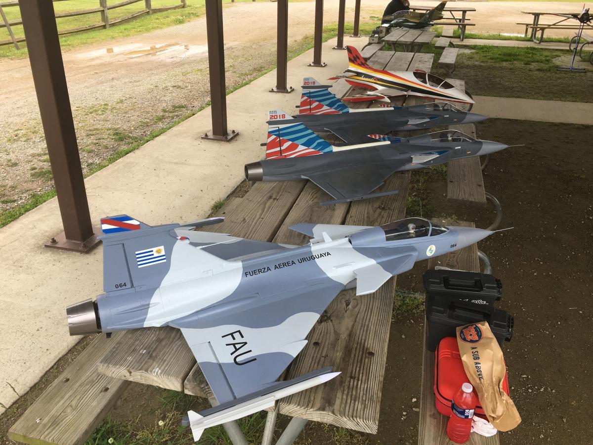

    Very much so. If I had to have only one the stock TV would be the one I would have. I thought it would have significantly less power from the non TV but it doesn't. I flew the two 6S with Power Hobby 5000 100C that weigh 555-575g and fly for 4:30 on the non-TV and 4:10 for the TV so I am on the throttle a little more. The 8S one uses the same battery plus a 250g 2S and flys for 4:10.
    Both the non TV and 8S TV needed quite a bit of weight in the tail to get the balance I like of about 25mm behind the marks. The 6S TV balanced easily at 25mm with no extra weight. That said I added about 25g in the tail cone to allow me to go to about 35mm OR use a slightly heavier 5200 (at 25mm) that I may use at some point.
  • SanExup
    You're part way there! Are tou pleased with the stock TV performance in comparison to the Uruguayan setup?
    Yes and both. The Urugauyan has TV and a Jetfan/HET 8S set up. The next is stock non TV 6S and the rear is the spare I've had and decided to put together and is stock 6S with TV. I was asked just how many do I need. I said I think five
  • SanExup
    TV and non TV? Stock fans or upgrades?
    It was Gripen day today for me. I took out my three and flew them all back to back. Great day.
    I need to buy a couple more.​ Click image for larger version
