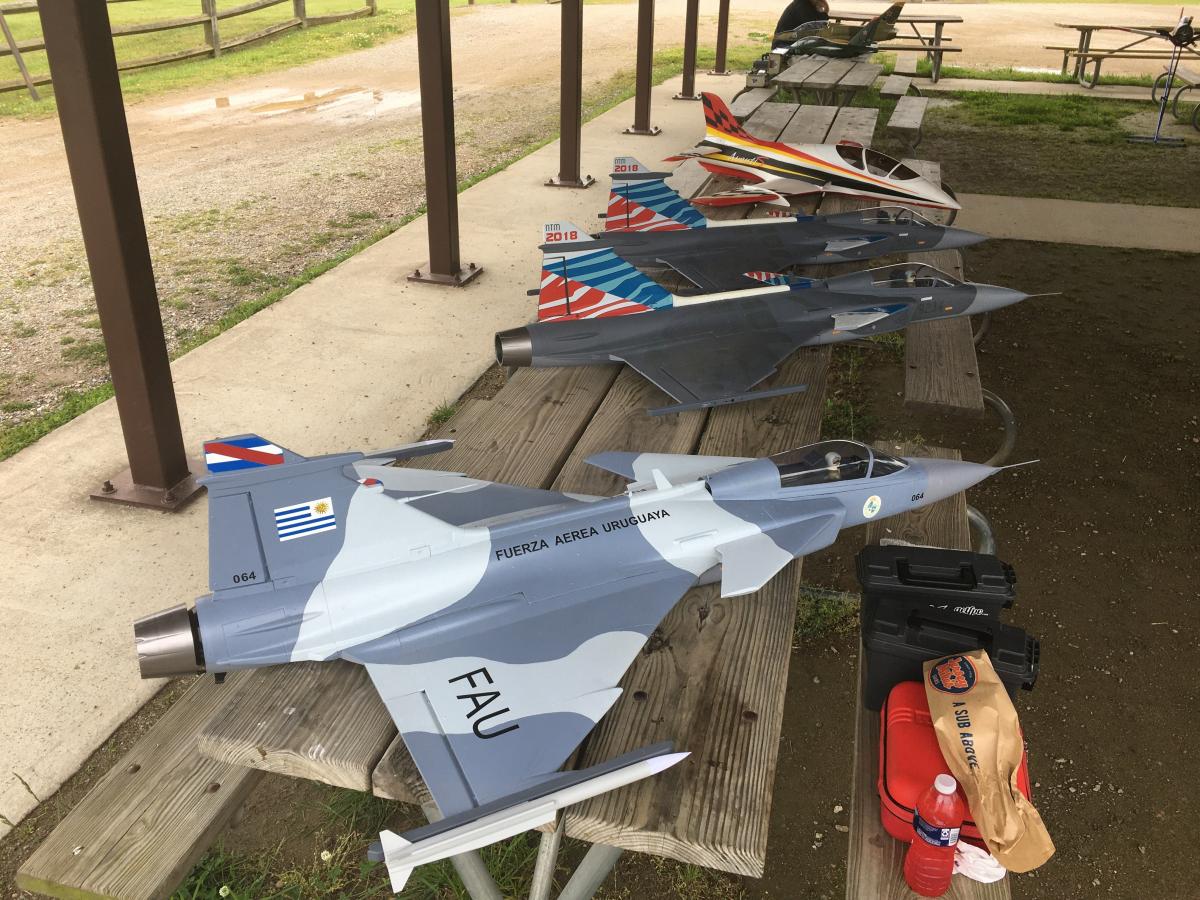

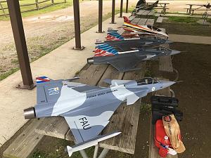

    I had three Gripens I was flying. The first was a repaint and had the stock 9b and TV. I pulled the fan and ESC and put in a Turnigy 120HV ESC and Jet Fan 8S EDF. Fantastic. Motion put them on sale so I bought a spare (9b and non reversing ESC) and stashed it away as a spare. A friend put his non TV 9b one up for sale and I bought it. I then had one 8S with TV and one 6S without TV.
    I got bored one day and built the spare and added TV to it. I had the repainted 8S TV, stock 6S TV and stock 6S non TV. Life is good!
    Then the 2150 came out plus reversing 100A ESC. I bought 3 sets and also two of the FW afterburners. Swapped all over to the 2150 and reversing and put the AB on the two that were TV. The 2150 is a huge upgrade in power. I would say it is equal to the JF 8S set up I had. Adding the reversing ESC was also great. I have the canards set up as air brakes in them too.
    We had a jet fly in last month and I was offered a good price for my no TV Gripen but pulled the 2150 and ESC out before selling it. I may just need to get another Gripen!
