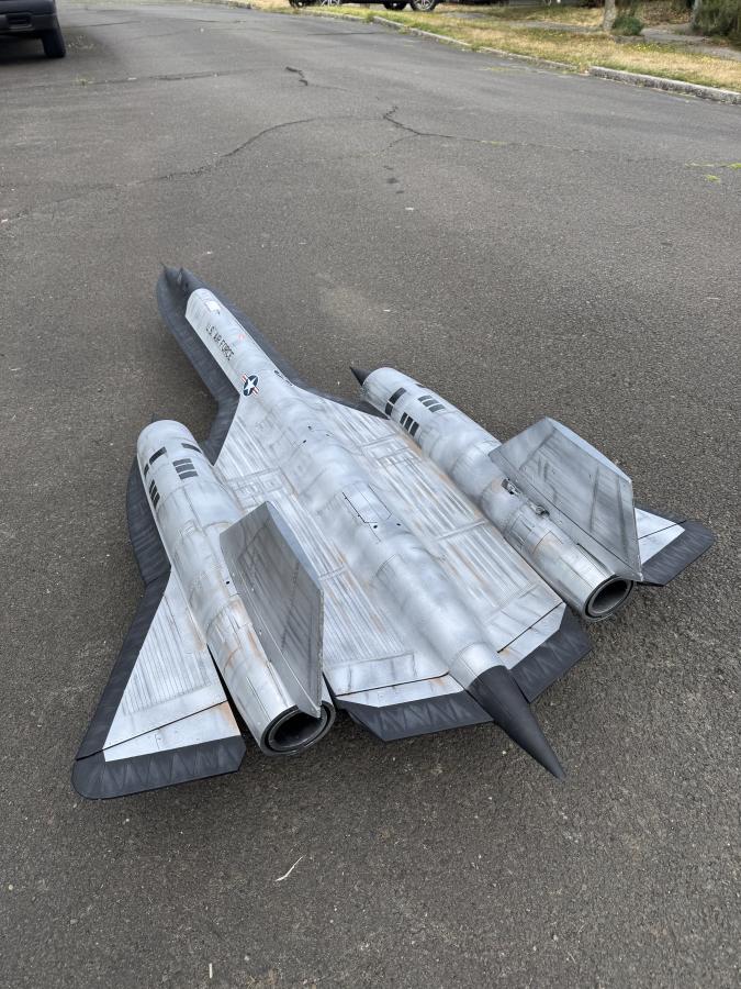

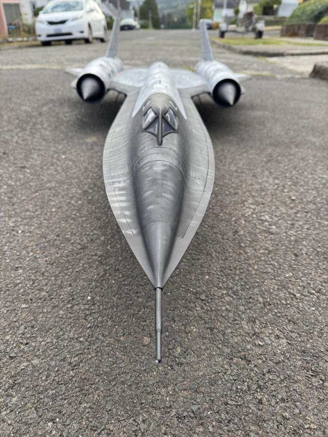

                  I just bought my new one. Had it pro-level painted...Looks sick! Unfortunately, the nose gear is traveling the opposite direction of the rudders. Grrrrr....
                  There's no easy fix that I can tell. The wiring is a rats nest and I can't find any actual NOSE GEAR STEERING specified servo lead in that mess. Any ideas? Appreciate any help. I really don't want to have to buy a servo reverser and figure that out. Life!
                    #309
                    In all her glory…

                      Aros,
                      Are you able to move the servo arm to the other side of the servo, i.e., flip it 180?
                      Great looking repaint, Bravo Zulu, Sir.
