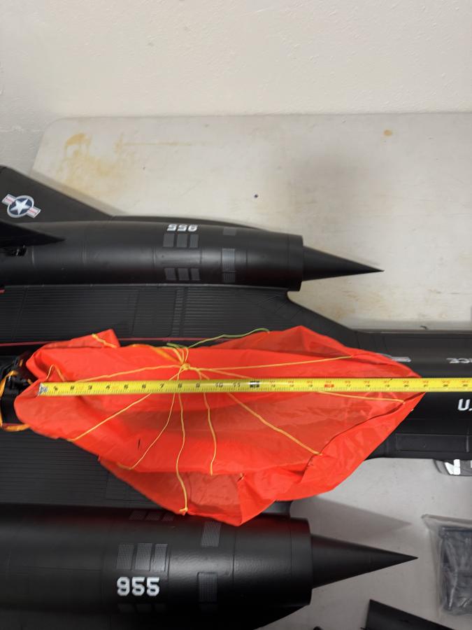

    Here’s how I measured, unscientific perhaps. Now it says 21”. Diameter, circumference? Same thing? I sucked at math and measuring lol.

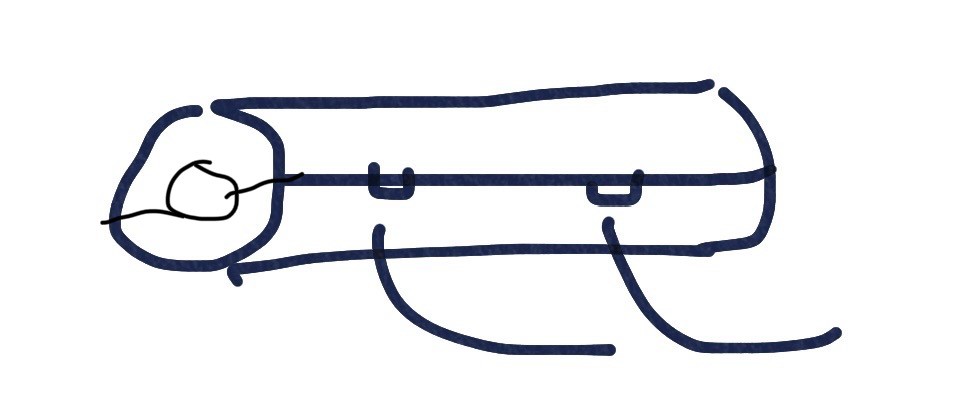

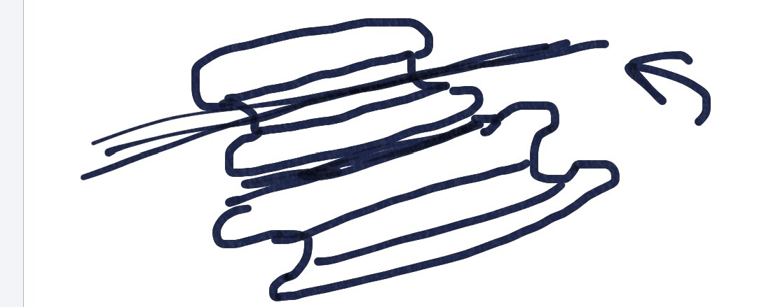

      Also, I got those clips you mentioned to help reduce power loss. How in the heck do you open them?!
        That is diameter. Thanks.

          #264
          Good…
          Note: The clip-on RF chokes reduce RF noise…not power loss.
          Look on one side of the RF choke. You will see 2 small latches. The 2 curved lines in the sketch below show where the clasps are. Use something thin to lift the latch clasps. Once installed…add a zip tie to ensure the choke stays closed. CAUTION….Take care not to mash or crush the wires between the two halves when you close and latch the RF choke.
          Once you unlatch the small clasps, unfold the choke and place it so the wires run down the center channel. Then clasp closed. The arrow shows the wires.
          -GG

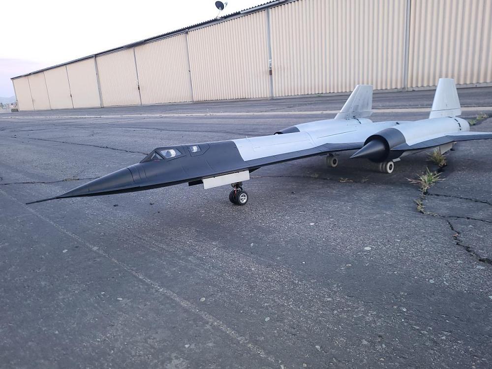

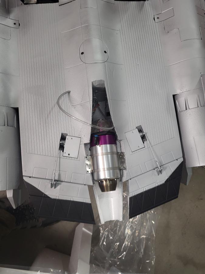

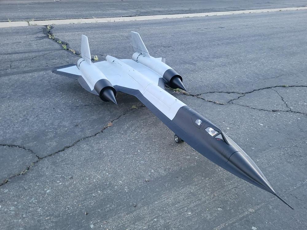

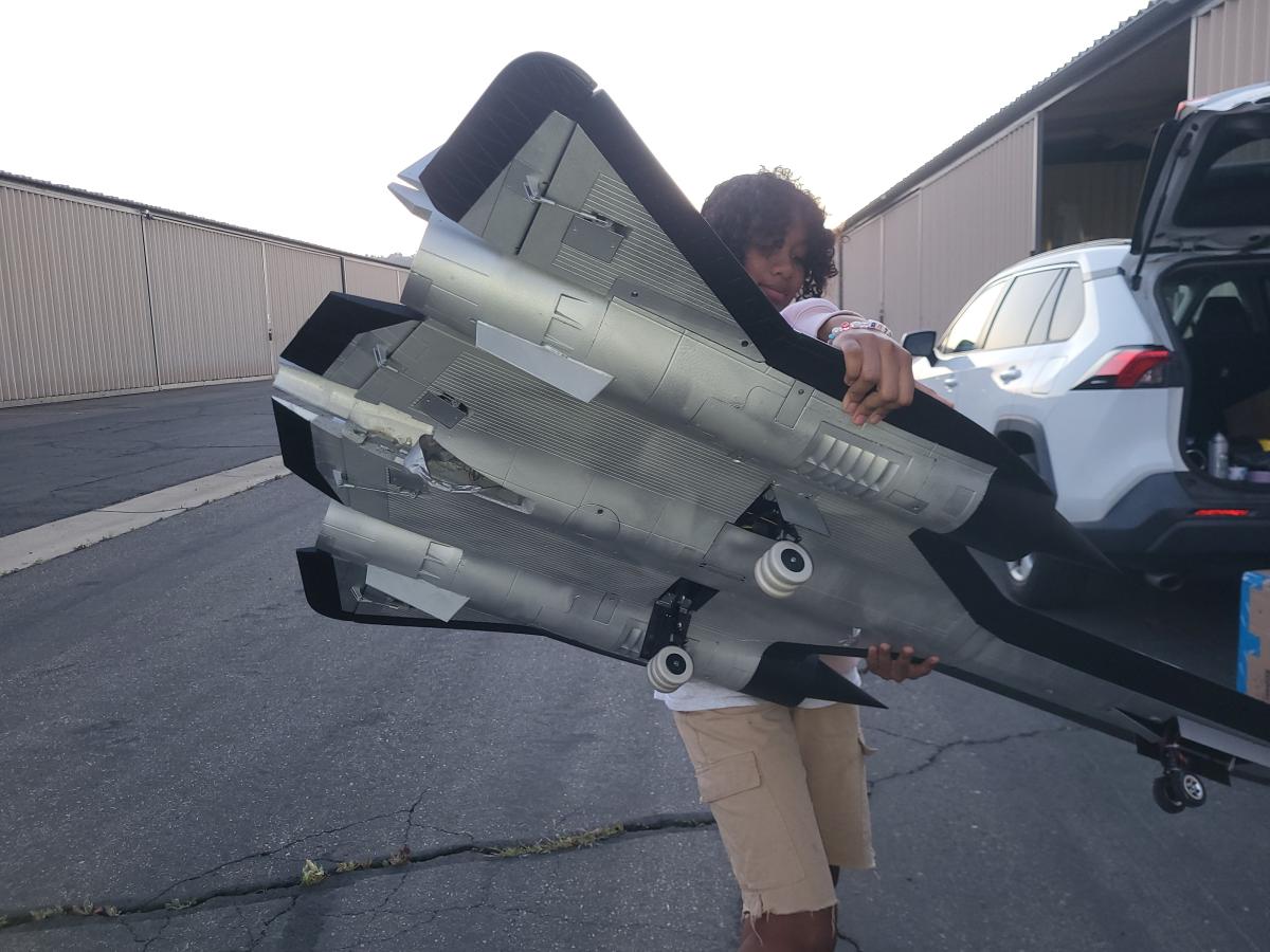

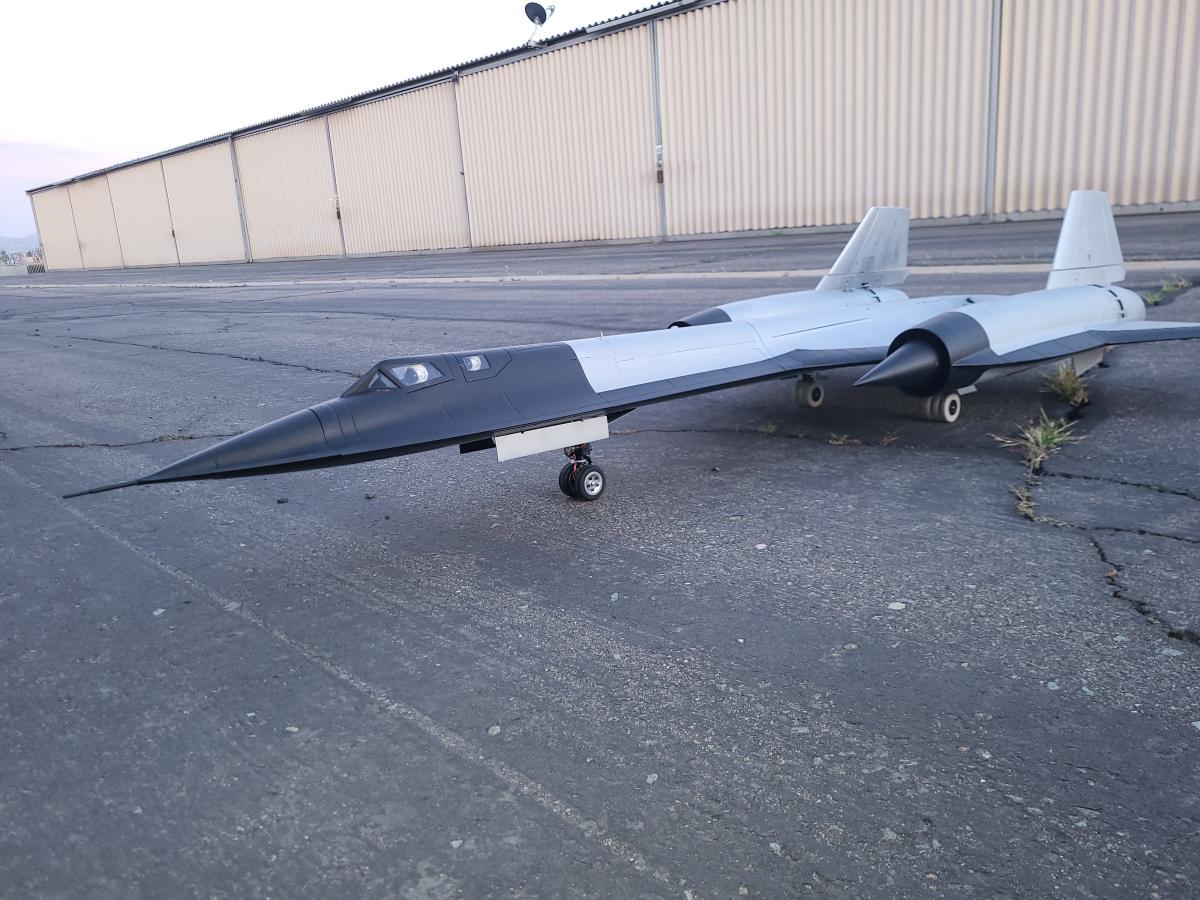

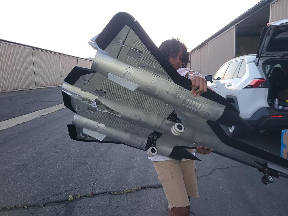

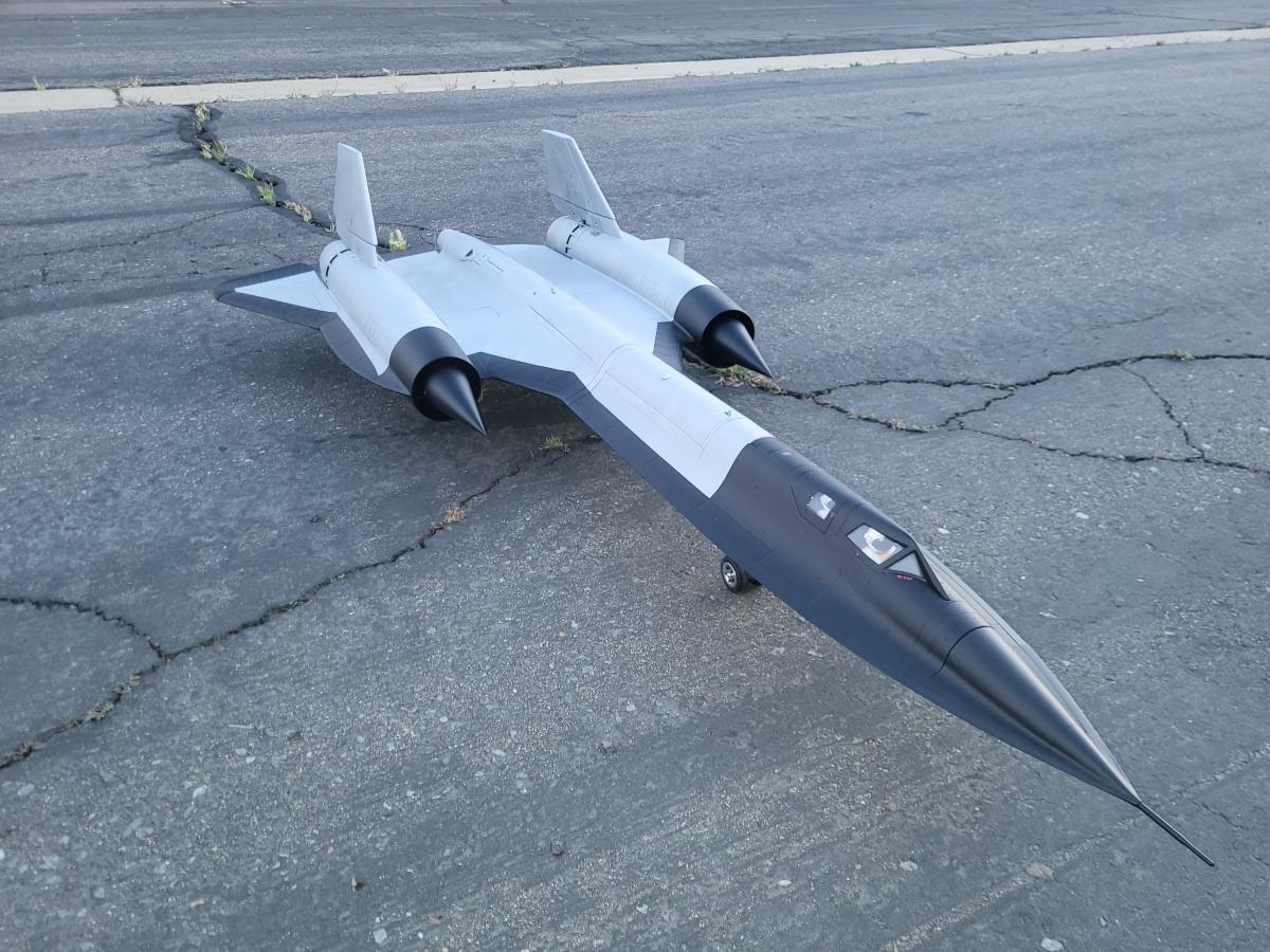

ID:	423951 Blackbird to Single Turbine A-12 conversion done. Click image for larger version  Name:	20250412_192238.jpg Views:	0 Size:	119.5 KB ID:	423952 Click image for larger version  Name:	20250412_191955.jpg Views:	0 Size:	158.9 KB ID:	423953 ​ Click image for larger version  Name:	20250412_191932.jpg Views:	0 Size:	178.9 KB ID:	423955

                Ooooooh, yeeeeeaaaaaaah.

                  #268
                  Am I the first one to convert this?
                    #269
                    As far as I know? Video?
