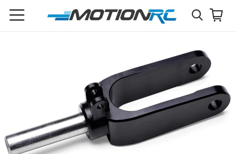

                                Click image for larger version  Name:	IMG_3145.jpg Views:	0 Size:	44.2 KB ID:	422969
                                Yes…good luck! The Windy app shows light wind opportunities for your area this weekend.
                                I noticed longer take-off runs and short landing roll-outs the last few flights. Wheel lubrication issue? It’s more complex than that.
                                1) The center “U” fork on the mains can spread putting pressure on the outer (inner and outside) axle head and C clip = braking action.
                                2) The inner tire material can “spread/flatten out” on the outside part of the tire. This rubs against the inside of the “U” fork = braking action.
                                Solutions:
                                1) With pliers, gently compress the “U” fork tips towards each other. Not too much, or you won’t be able to mount the center wheel back on…or cause the inner wheel to bind. The tolerance is minimal. Not much leeway either way. Gotta get the fork spacing correct.
                                2) With a razor knife or Dremel, reshape the inner tire so it no longer rubs against the insides of the “U” fork.
                                3) Lubricate well!
                                The main gear’s fork tip spacing will require regular checking and adjusting.
