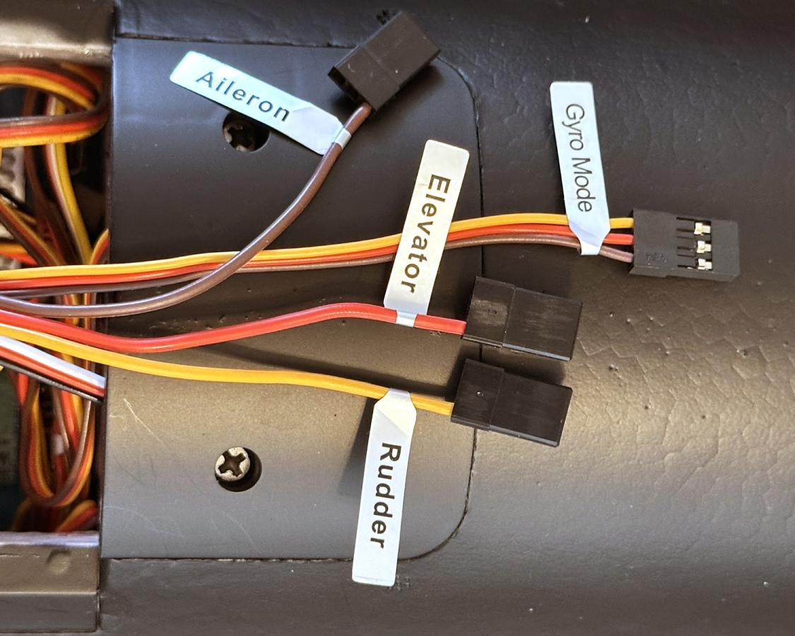

                Speaking of the included SR-71 GYRO, I'm a little unsure of how to plug the gyro leads into my receiver. The manual doesn't address the connections other than showing a schematic. The AER leads are all single wires split out from a standard 3-wire lead. I'm assuming that I plug these leads into the Signal ports of the corresponding control surface (top pin for Spektrum receivers) and the 3-wire Gyro Mode lead into the Flight Mode port. Yes?

                  It does seem weird, but it works. The B-2 is the same.
                  Each of the single wires is a SIGNAL wire. So rotate/install every single wire connector onto the SIGNAL pin of your RX. In other words, all single wires will line up.
                  The color of the wire can be ignored.
                  -GG

                      If you don't plug in the gyro mode it does default to basic gyro (same as your B2). If you plug in the mode you can have auto level (SAFE) and off (again same as your B2).
