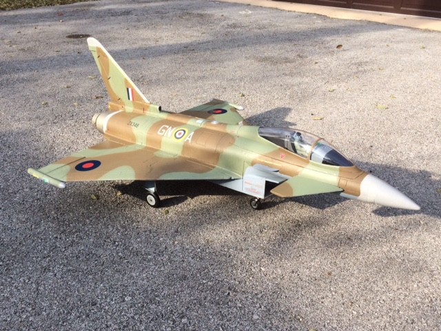

                      #30
                      Do you not have any foam planes that have gatored???
                      My "Blackjack" Eurofighter is coming up to 2 years and has no gatoring on the black (or anywhere else). I do keep it under the trees when at the field and not in the air.

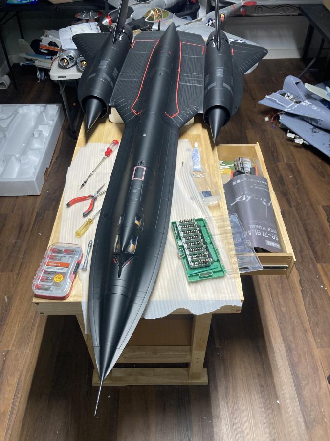

                            Got her assembled! Easy build / beautiful finish. Now to check out the gyro function for correctness and adjust servo connectors for centered position. Mount the RX, etc.
                            Then check the CG.

                              Click image for larger version  Name:	IMG_3016.jpg Views:	0 Size:	116.4 KB ID:	419592 All done except for the decals.
                              Post build impressions…drum roll please…and I am not affiliated with MRC LOL…here goes…
                              The quality of this PNP plane is excellent. I did not run into any snags getting her ready. The Admiral 6000 needed to be slid to the aft of the front battery bay to get the CG spot on (gear down). If one were to go with 2 batteries, some tail weight would be needed.
                              The range check was great. All quadrants. I have yet to taxi her, so I cannot comment on how well the nose gear is centered straight.
                              I added RF Chokes right at both ESCs on the lines that head back into the fuselage and an additional RF Choke between the UBEC and the RX. There is a green toroid ferrite choke already installed. I added another. RF Chokes are SOOO important to help prevent RF noise from the ESCs from disrupting your receiver.
                              A majority of the screws are Torx. I liked that! The inner main doors came default to “not scale”. They close after gear extension. I liked that that, too. It gets them out of harms way.
                              All the factory-installed screws were tight! The gyro was default “normal” (steady green light), and test “flying” in my hands proved that the gyro configuration is correct. There is an App you can download to configure the gyro, should you need to.
                              With the magnetic nose off, there is ample room in the bed of my Titan. Her right main fit into the tie down for the B-2…nice.
                              There is a seam line in the tail cone. I lined up the inner control surface with this seam. Then I lined the outer control’s trailing edge to the inner control’s trailing edge. I’m gonna start with about 3-5 mm of “trailing edge up”. Most of my birds require up elevator in cruise.
                              Rain for the next several days. Ugh.
                              Overall, I am VERY well pleased with the quality and design features. I’m ready to see how she holds up to her first 1,000 landings.
                              Next up…pilot flight reports as soon as the weather permits. Not going with any EXPO and will maiden on low rate. 6 ch gear, so no chute, no gyro settings changes, and no reverse thrust. I do plan to upgrade radios, so these other “neat’ features will be enabled soon. Timer is set for 3 minutes, and I will maiden at 50% throttle cruise. I anticipate 4-5 minutes at 50% throttle plus some full power acro (loops) and fast low passes…leaving 3.8V is my goal.
                              -GG
