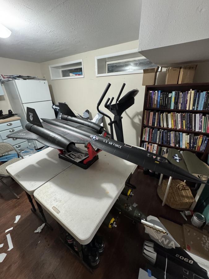

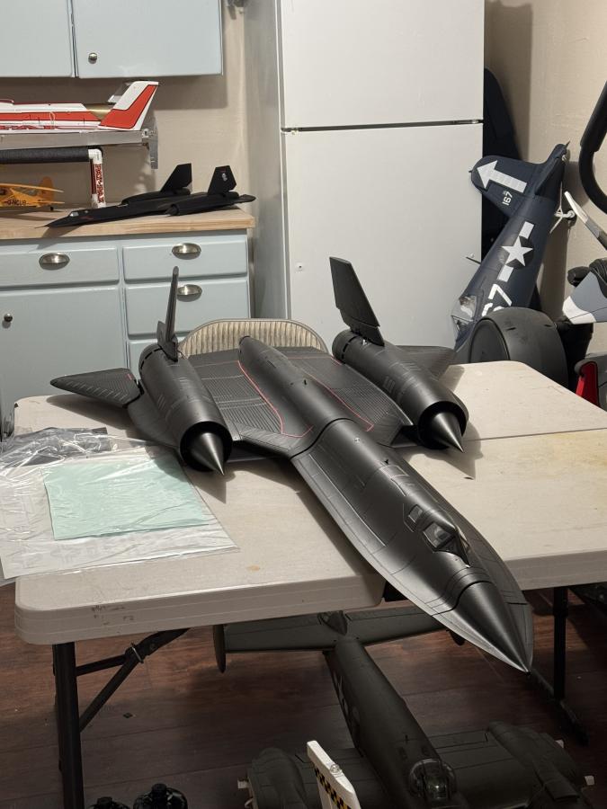

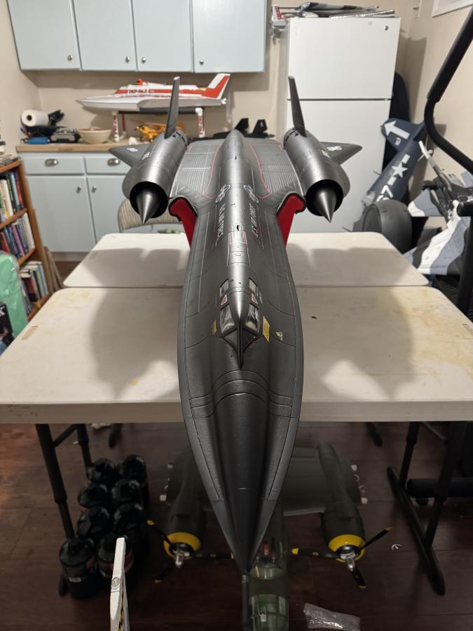

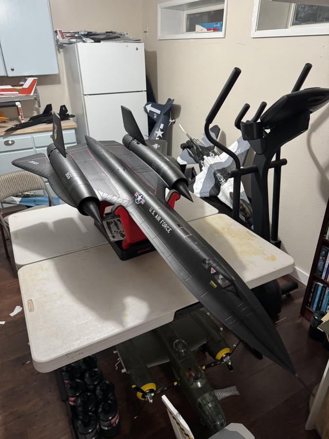

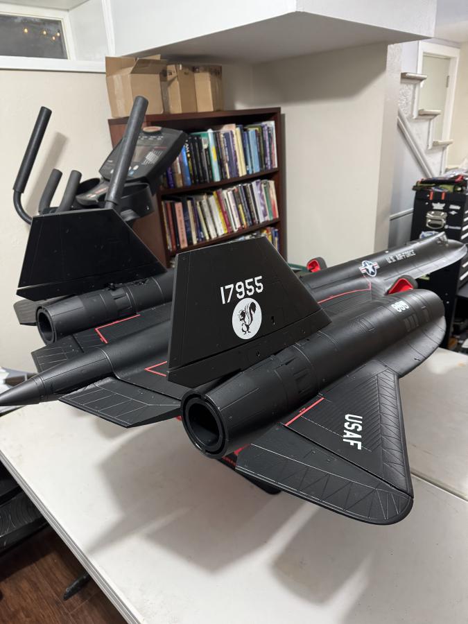

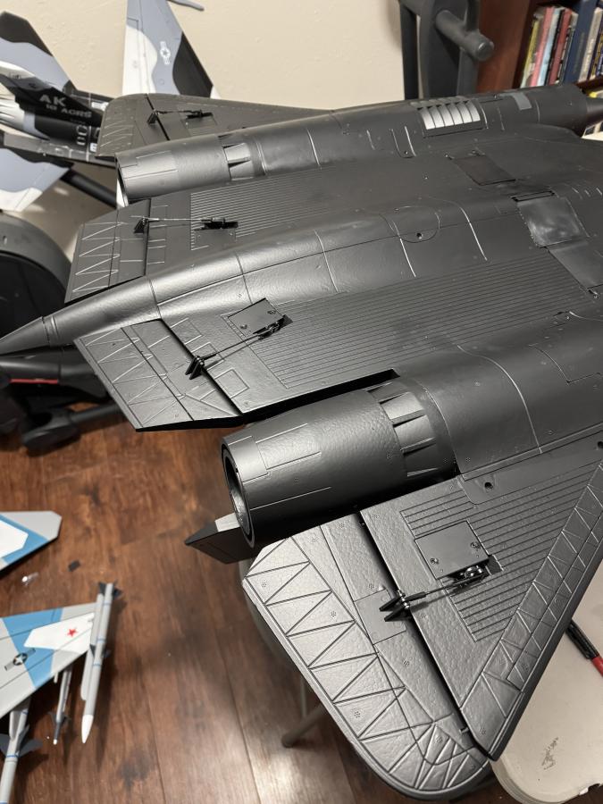

      Got mine late tonight. Too tired to build her completely but what a presence. What a size. What attention to detail. Freewing nailed it. Can’t wait to build her completely soon.

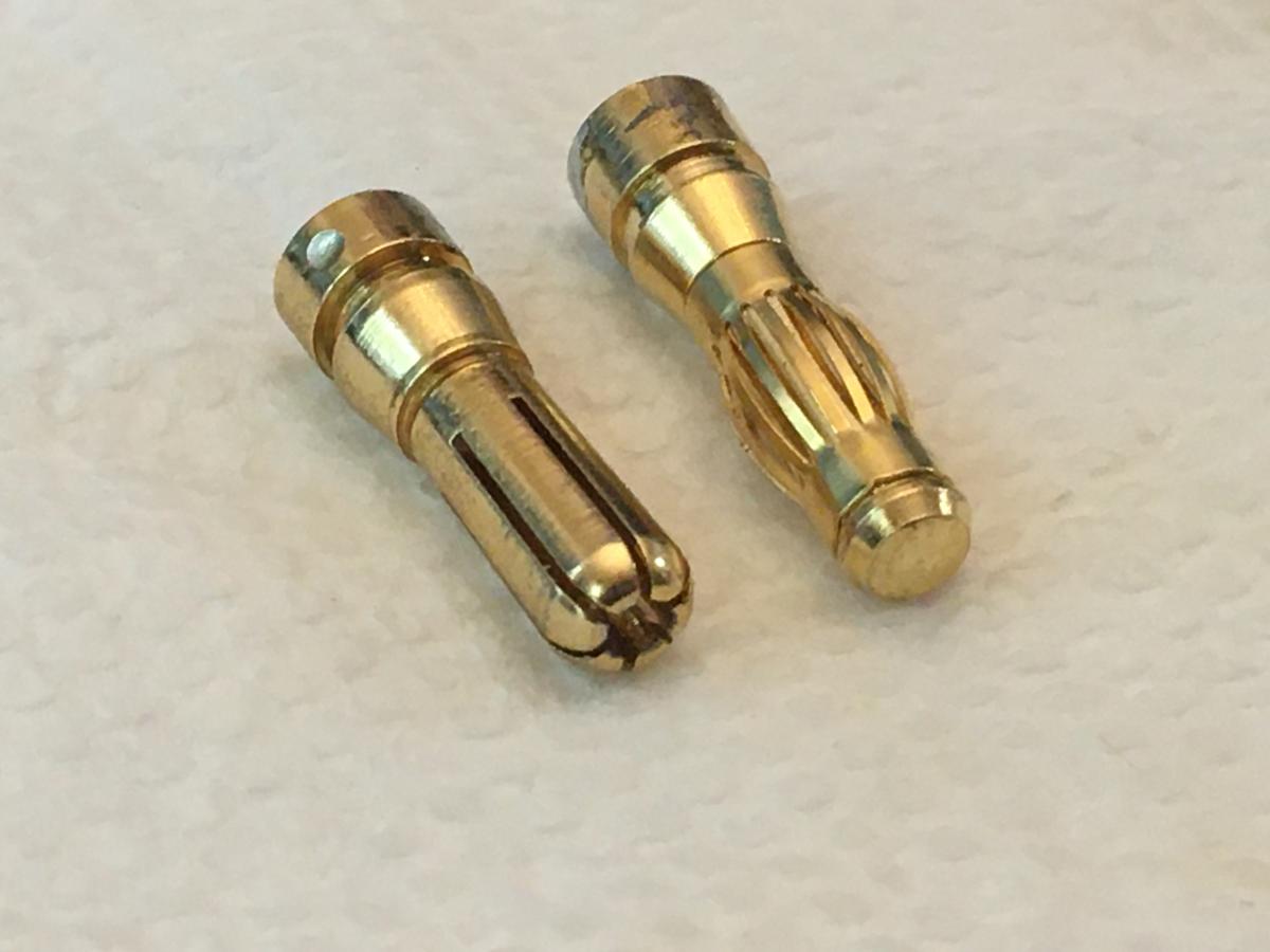

                                        The issue of over heated/ melted EC5's has happened a few times over the years and as far as I can tell is caused by one type of male pin on the connectors. There are two types of EC5 pins, see the picture attached. The left is what I call split type and the right "banjo". The split as GG notes is a much more robust type.
                                        There has been ONE reported case of the issue with the SR71 and in my opinion it is caused by the amount of power, Amps, drawn by two fairly powerful fans running off a single battery through a single connector. Each fan is capable of pulling 80+Amps so a freshly charge battery may supply 150+Amps (there would be some dragging down of the battery at this level of current). This is more that even a 8S 90mm EDF would draw so we are seeing this for the first time on FreeWing planes.
                                        So what can we do? Well first, it is going to be rare and probably when someone has a good battery, more than likely a high C or HV battery that can supply the amps to do the damage. And probably when someone flies long periods of full throttle. And as GG notes repeated connecting of the connectors is deteriorating the springy thin banjo part of the pins so after time you may develop the issue.
                                        What to do?
                                        First, if you ever feel your connector, any connector, is hot find out why, it means there is electrical resistance in the connection and that will only get worse.
                                        Also again, this may never be a problem on your plane. Just reducing timing or limiting full throttle usage to a few short fast passes may prevent it from happening. Going to better connectors would be a better way. If you are happily using EC5s and have a lot of batteries with them changing the male pins in the ESC connector with the split type pin should also work. And of course going to larger connectors like AS150's would solve the issue though I think that is over kill, especially if you have a lot of batteries and planes with EC5's.
                                        Another thing is the spark when connecting the battery, that will wear out your connector and adding an anti-spark in line could also help, I would say not prevent but help.​​
                                        Another choice would be to run two batteries in the SR, one to each ESC so each would see the 80A instead of the full 150A and this may be a great choice for some that have a supply of 6S 3300mAh but would require splitting the battery leads from the two ESCs and soldering connectors and some extensions to the wires. This could have the side benefit of larger battery over all for longer flight times and as the SR has two bays I think some may already be thinking of doing this.

                                          GG, on the "banjo" type ones I have the springy banjo part is not soldered to the pin part and can roll on it. Maybe you have some where a little solder got on soldering the pin on the wire or something?

                                          Now to go see what type connector design the SR-71 has. It has the spring/screen type connector.
                                          Added note: Even early on, the solder or braze between the inner shaft and the spring/screen could fail making for a high-resistance connection = heat and melt early in its life.
