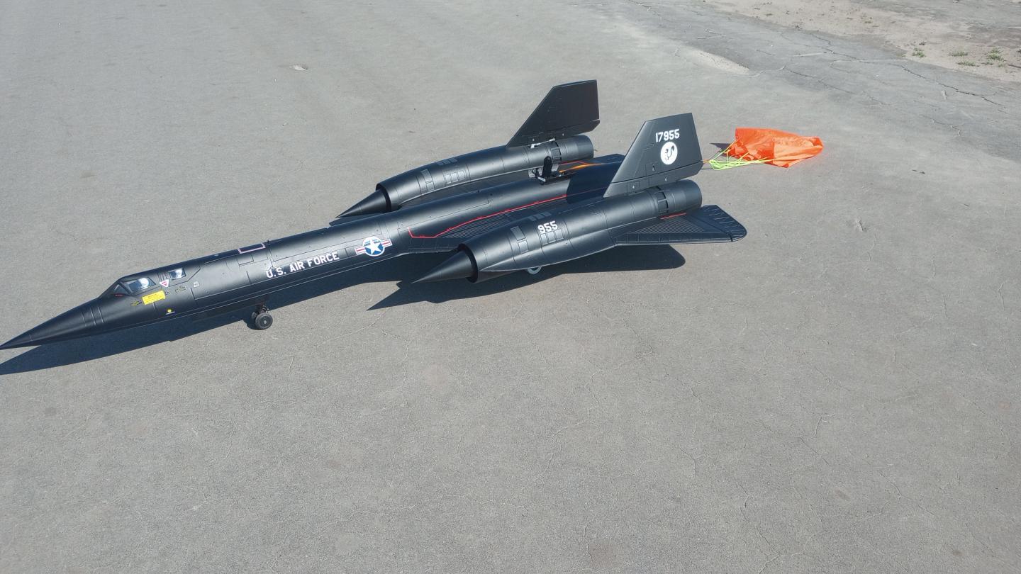

                  Mine is flying good, 12 flights so far and set up per the instructions, no changes other than reduced control throws. The chute works flawless and looks awesome when deployed at the right time on landing...

                        Made 4 more flights this morning.
                        STOCK gyro does fine. New “discoveries”:
                        1) 5-7 mph direct cross wind = she did well
                        2) Gotta REALLY keep in your head what you are doing. I was yacking to a bystander and turned downwind. I lost orientation due to the distraction. Only experience saved it. IF YOUR ARE DOING SOMETIHING TO CORRECT THE SIGHT PICTURE AND THINGS GET WORSE….DO THE OPPOSITE FAST!
                        Doing the opposite fixed my sight picture as the plane leveled out. A novice would have plowed her into the ground. It happened so fast.
                        Don’t let yourself get distracted. This bird demands focus. Even to the point of talking to yourself like,”Going right, so left will shallow!”
                        3) She flies well at 1/2 throttle. Will allow for a bit more extended flights.
                        Loving this bird!
                        -GG

                            Yeah she will get away quick, like you said, just talk to yourself as your flying this one. I did fly mine in a slight crosswind yesterday and it handles it no problem and the rudders work great, I also did some slow flight approaches with gear down the whole time, looks awesome doing those, I think people thought this one was going to be just a go fast jet, nope.

                                I totally agree! I made 6 more in dead calm. Without the chute or reverse, best have some pavement to roll out on.
                                Total flights = 17
                                -GG
