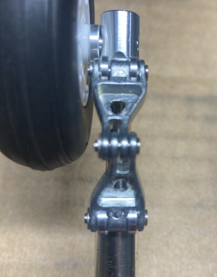

    Correction…14 landings on NEW and beefed-up anti-torsion arms. Not repaired as stated in my prior post.
    The strengthening process is:
    -Remove the arm BEFORE it breaks
    -Remove paint carefully with a Dremel tool
    -Wash with isopropyl alcohol
    ​​​​​​-Fill all cavities with JB weld epoxy
    -Thin coat non-hinge areas with JB weld
    -Wrap with 0.6 mm steel aircraft safety wire
    -Coat all steel wire wrapped area with JB weld
    -Reinstall arm to landing gear
    -Dremel away any small areas of epoxy which cause any restriction to compressive spring movement.

    My repair/beef-up of the anti-torsion arms has now lasted 14 take-offs and landings on the gravel that originally broke them. There’s more room at this gravel surface place. So, I thought I’d experiment with the beef-up and see how it worked. So far, so good. But my goal is to move to a “smaller” place with smooth asphalt.
