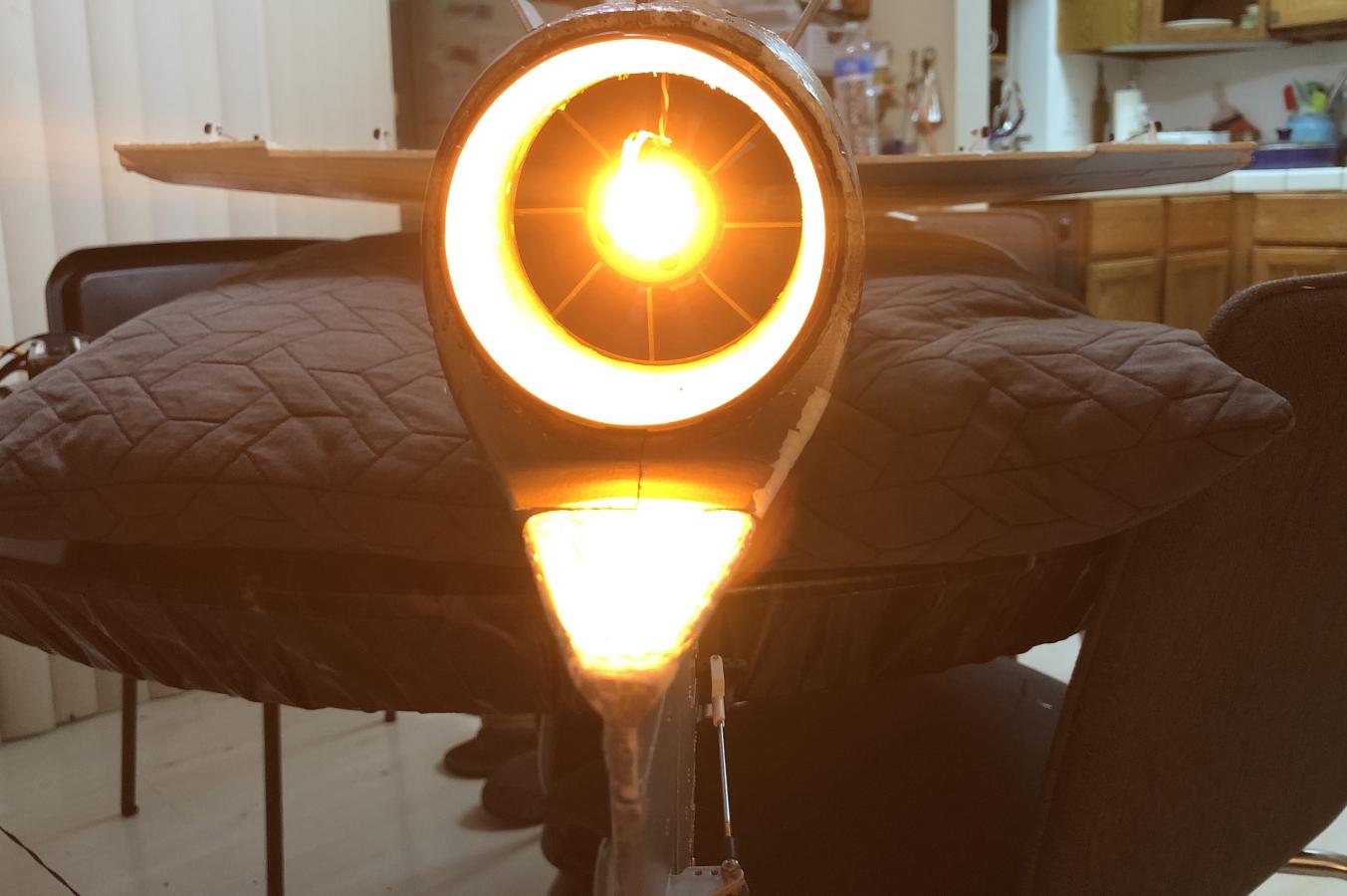

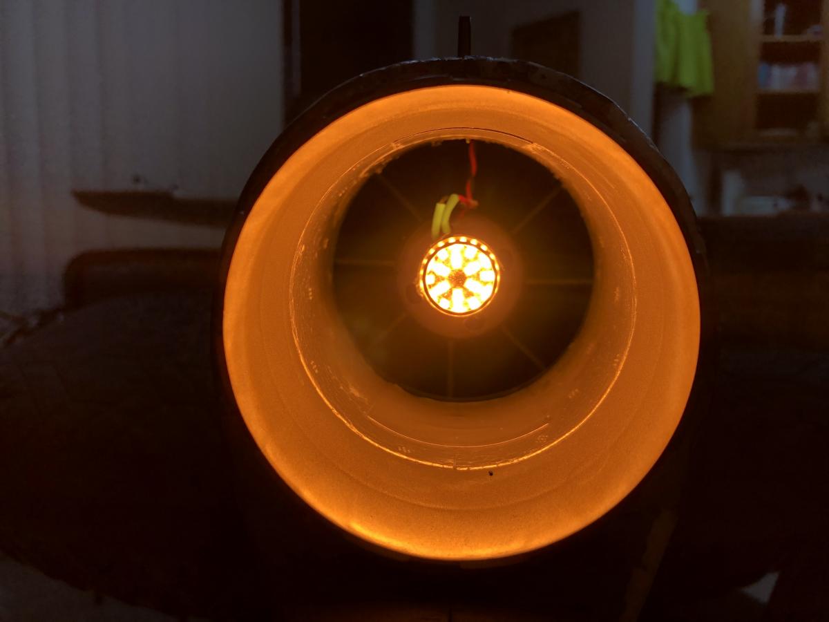

    Will have my new burner up and running this evening.Here are some pix of it as it is now...

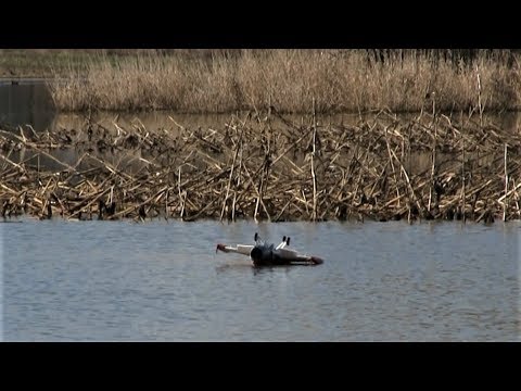

    Wow that vid was very entertaining, very cool. Great job! What happened to your wingman? Shot down by AA? :Scared::Scared:
    We were experiencing input overload and neglected bingo fuel. The splashed 104 flew successfully again yesterday. The other has foam damage only, but a cosmetic fuse replacement may be in order. The intake area would be time consuming to recreate.
