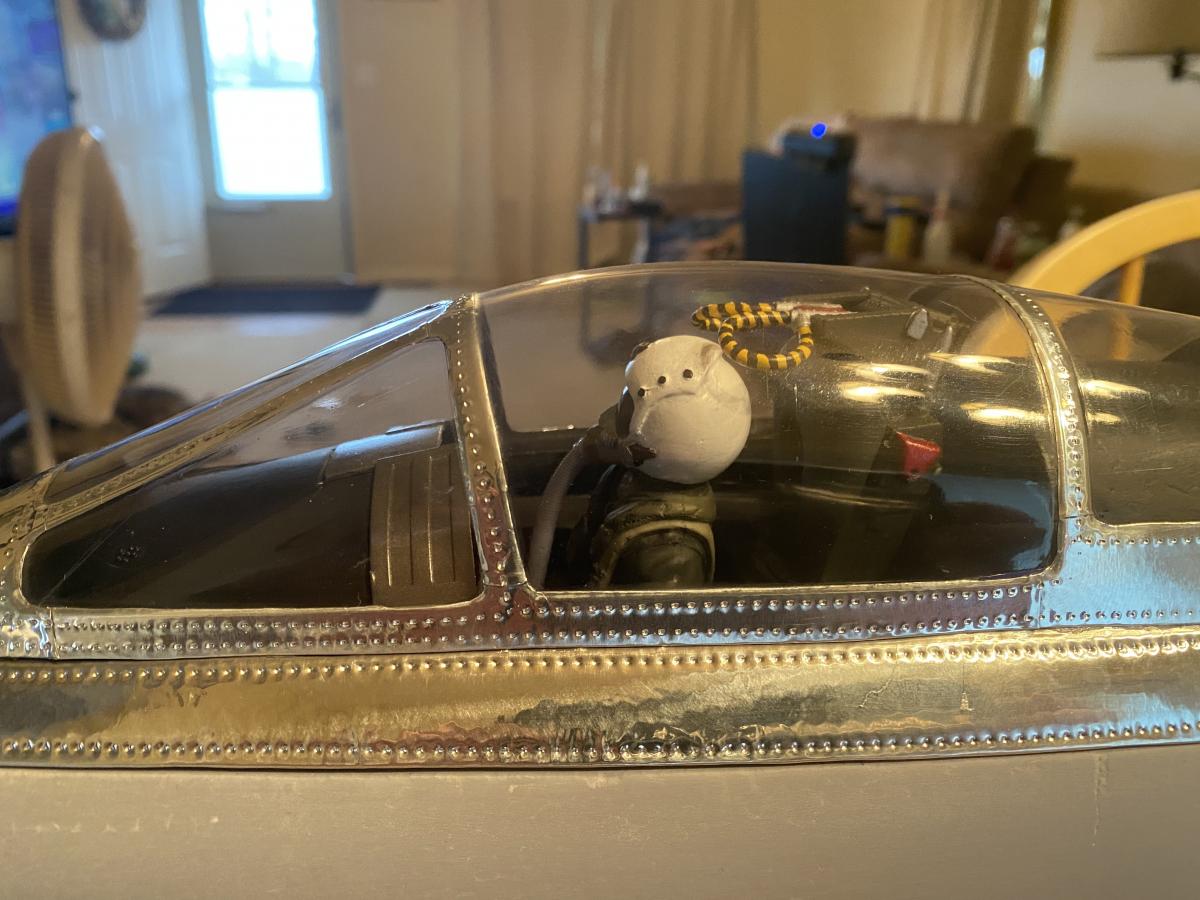

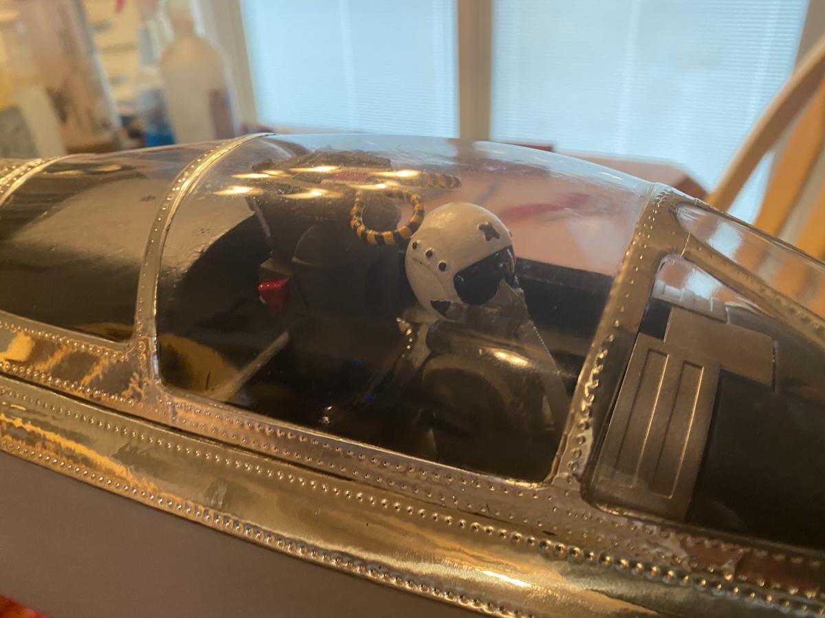

    I worked on finishing up the JHH pilot and 3D printed ejection seat. I used the remaining flite metal I had to finish the canopy and hatch. I am pretty much on hold until my order of flite metal arrives.
    I have to hand it to you, you have patience that's for sure, that thing is going to look awesome when your finished. Good luck on your maiden flight or have you flown it yet?? I've had two of them so far, both flew great but a handful on landing until you figure it out, this is one jet that you do not come in with a high AOA, keep it kind of flat with maybe just a slight nose up and let her come on in that way and flare at the last minute and add a little power and she will kiss the runway nicely, I think I was the only one around using 80mm of flaps, it loves it but you have to keep on the power with that much flap but it slows it down nicely, I don't recommend it on your first few flights, but after a few flights, give the 80mm of flaps a try.

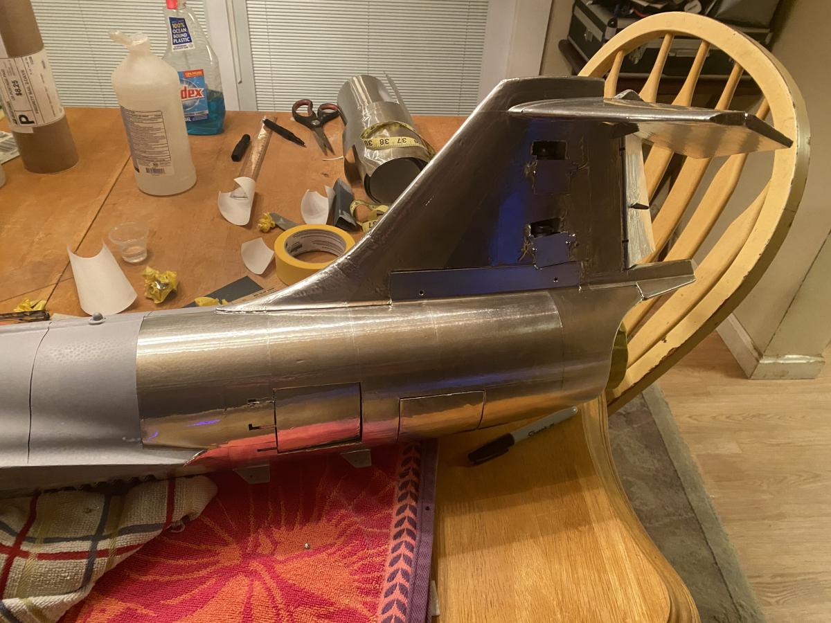

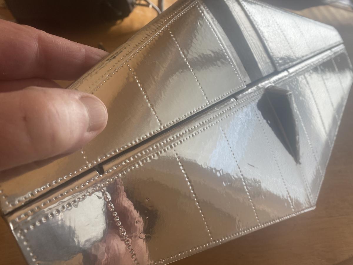

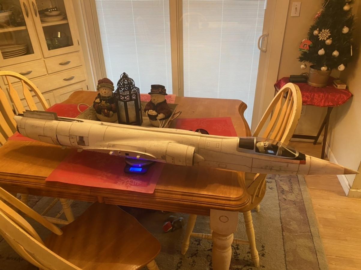

    To break up the monotony I polished the stab and elevator and added the rivet detail. It really made a huge difference.
    Looks nice. Can't wait to see the finished plane.
  • Waconut
    It’s far from perfect but will look good on high speed passes down the runway.

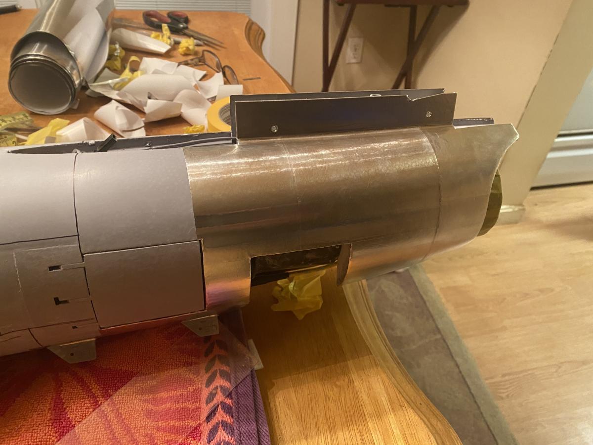

    It is slow going, I placed an order for more Flite-Metal as I will not have enough.

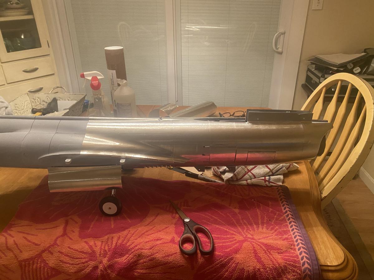

    I started adding Flite-Metal to the fuselage today. It is a very tedious process to say the least. I think I may not have ordered enough to do the job. We shall see.
    Sure looks nice! Should make for a spectacular finish.

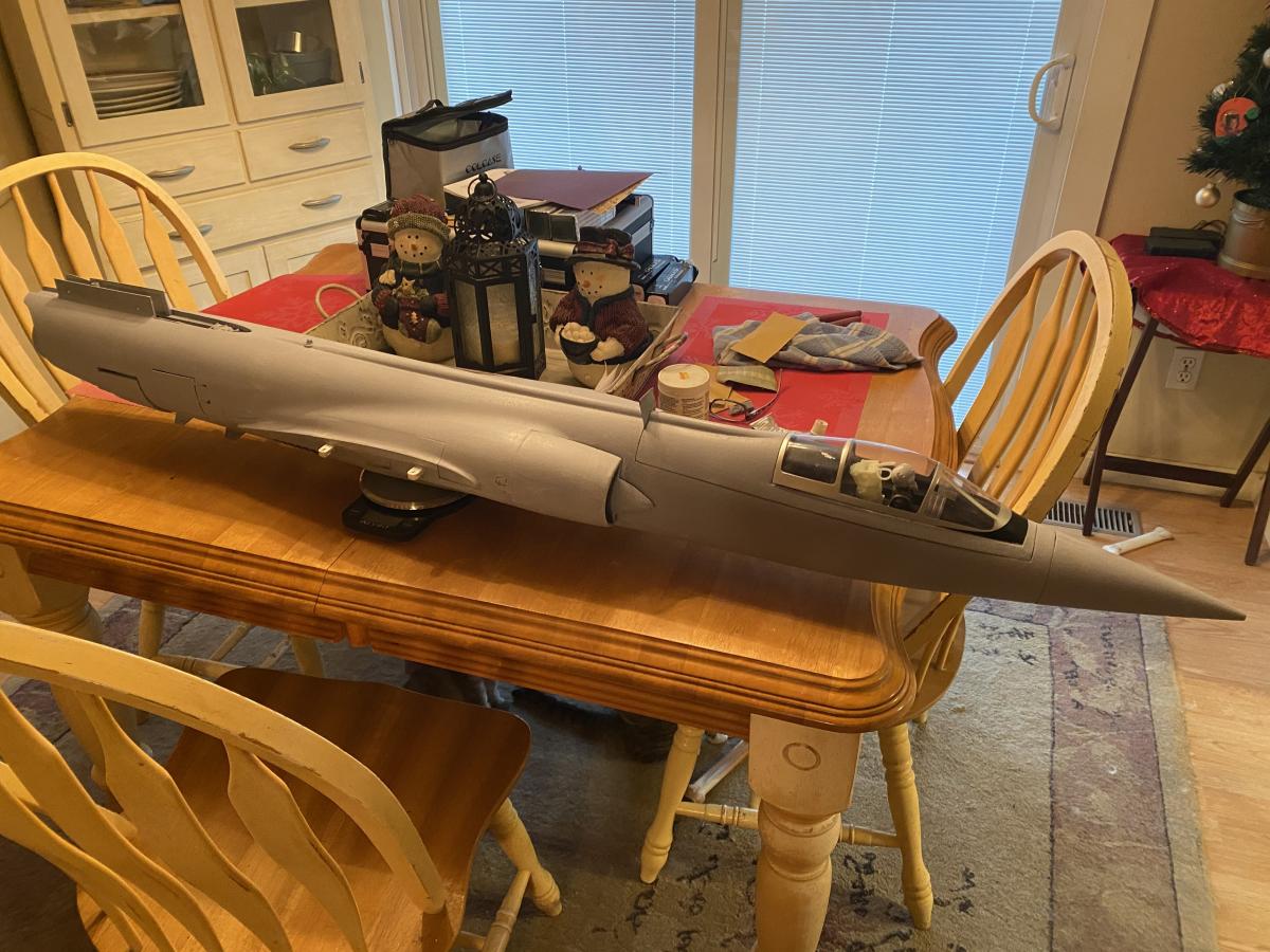

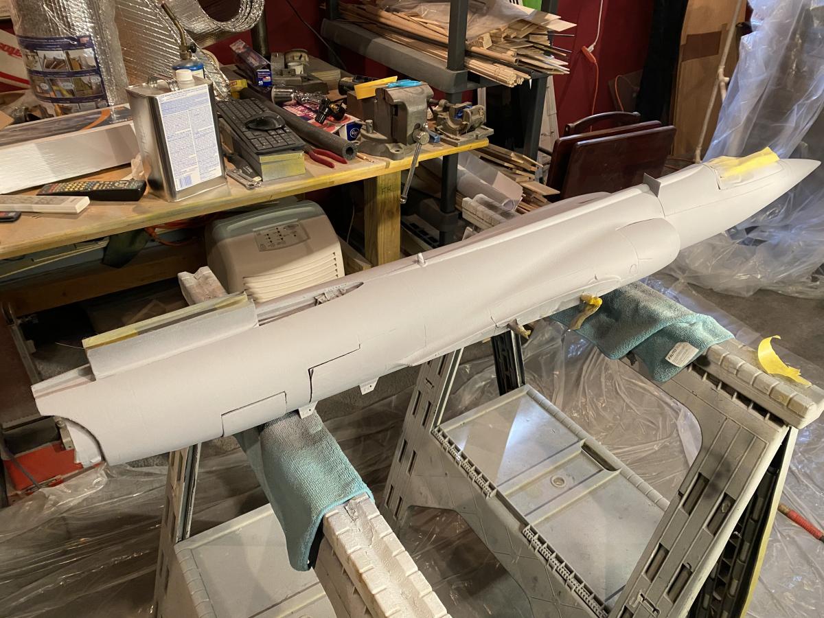

    I have the fuse ready for applying the Flite-Metal. After the final coat of primer I wet sanded with 400 grit. The fuse now has a nice smooth base to apply the Flite-Metal too. I am now working on the tail surfaces.
    All the work I have done to the fuselage has added 85 grams.

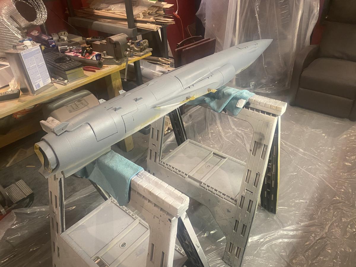

    I sanded the fuse this morning with 220 until I could barely see the top of the foam beads. This plane had some pretty bad gatoring from the factory. About 50% of the fuse sanded out smooth. I have sprayed 2 more coats of primer and will repeat the process tomorrow.
    It sounds like a lot of primer and weight but the majority of it gets sanded back off. It’s already looking better.
