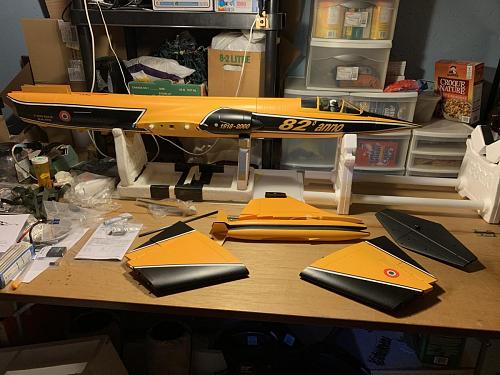

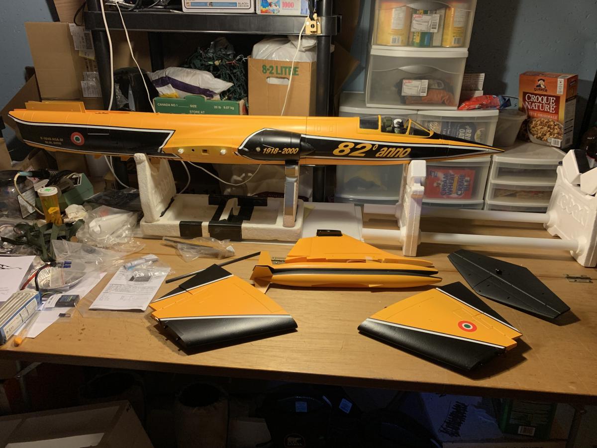

    It's gonna be nice
    Although it was the only livery in stock in the ARF Plus, I think I would have picked it anyway.
    I gotta say I do like that yellow and black
    My F-104 ARF Plus arrived a few days ago and I've just finished installing the EDF unit from the 90mm Eflite Viper. It's actually 100g lighter than the stock Freewing unit meant for the 104. It took some foam carving to make it fit and the 3 motor wires will need to be extended as I'm also using the Avian ESC from the Viper so I can get the thrust reverse. I'll be also using the Spektrum 737T from the Viper so the Freewing gyro will be removed in favor of the AS3X/SAFE in the Spektrum RX. Will also add an Assan steering gyro. To operate the speedbrakes, I'll bind, in tandem, a Lemon 10-ch RX and use Ch. 8 for that function and possibly piggyback them onto the same switch I use for thrust reverse - thrust reverse ON, speedbrakes deploy. As the build progresses, I'm sure that hurdles will be encountered so some of these plans may have to be modified.
