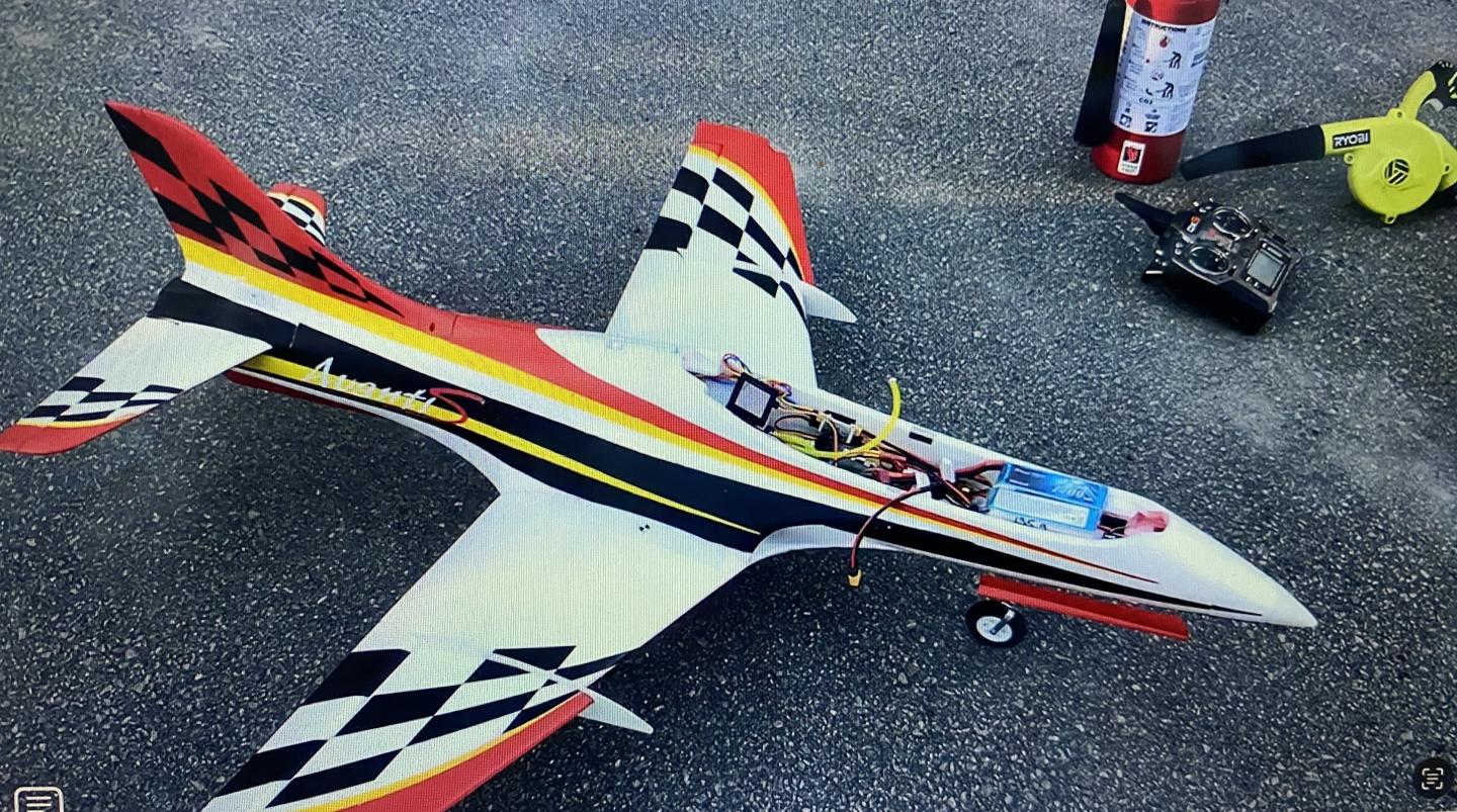

    Do both turbine and EDF! Both huge fun and great flyers! my turbine has an X-45 and was my first conversion. Flys much the same as the EDF except throttle response is a LOT slower and... with the little turbine idling at 60K RPM, getting the model slowed down for a bounce free landing is a lot more of a challenge than with the EDF! Whatever you do, enjoy the model!
    Photos below are my V1 Red Turbine, V2 Yellow EDF and V2 Red/Gray. EDF..luv 'em all!

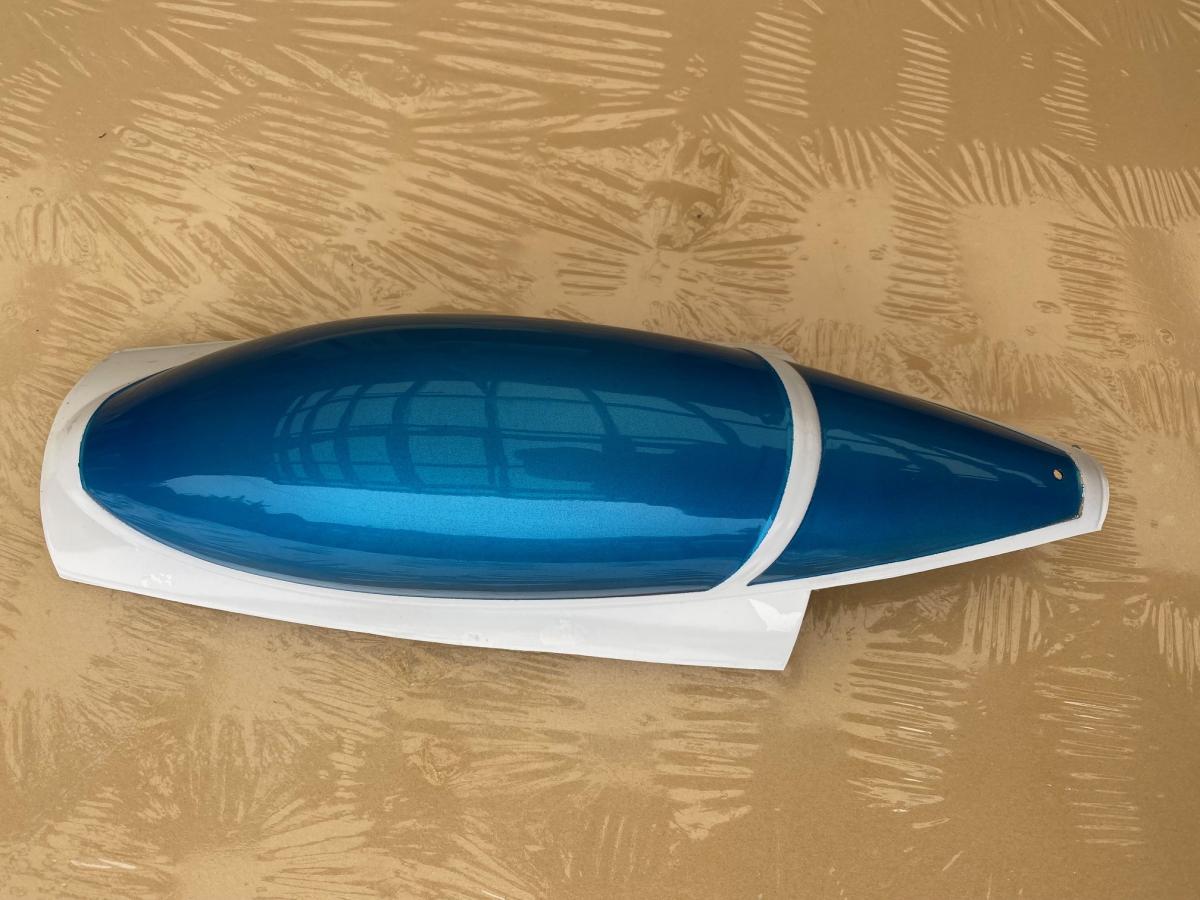

    Clear canopies can look great when painted from the inside. Same process as RC car bodies. Three coats; each on top of the last one 1) transparent base color (eg blue, yellow, etc) 2) chrome/silver 3) gloss black
    My examples are pretty basic, but there are some rather exotic colors out these days.

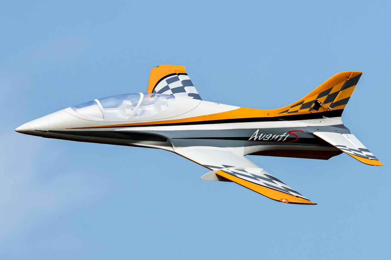

    It's just a bit strange to see a clear canopy without a pilot figure. Easy fix but feels unfinished from factory.
    The original yellow didn't come with pilots but the canopy was tinted. A few wanted clear canopies for FPV, maybe that's why it's clear?
  • Flanker271
    Pilot figure gone?
    New Legacy Yellow V2 now available in PNP and ARF PLUS. (Server may still be synching...Should show in stock shortly)...
