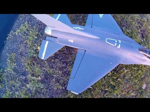

A bit windy for a maiden flight but I decided to risk it.A bit windy or a maiden flight but my passion for flying got the best of me. I think this jet will be a great flier once the aileron EXPO is reduced but I us...Comment

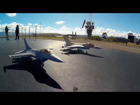

My goal was to work on landings, but ended up just having fun, couldnt help it! I do need to buy more batteries, whats the biggest people are using? And what flight time?
Awesome flying, John. Looks like you've gotten her figured out. Those landings were real nice.

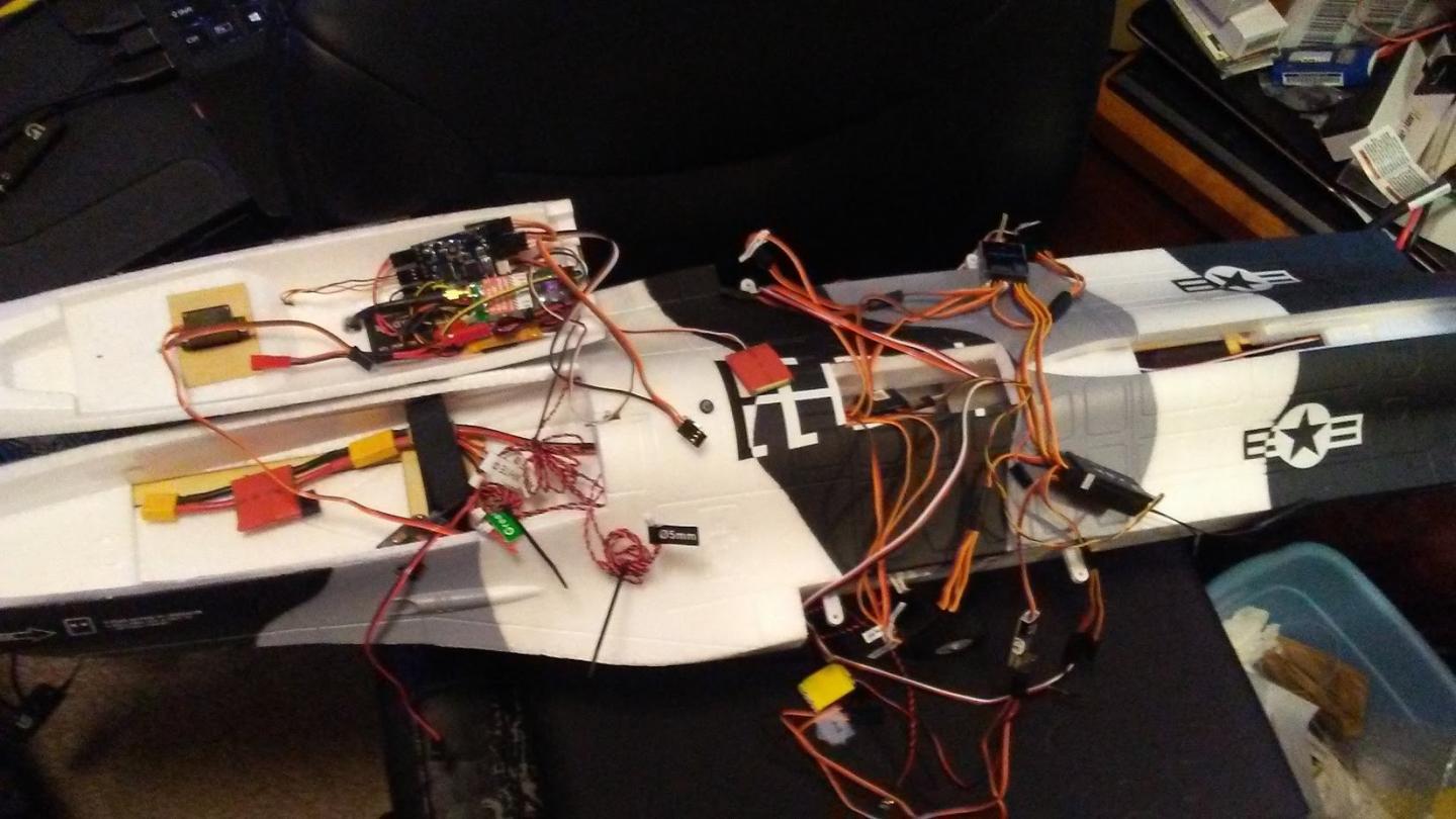

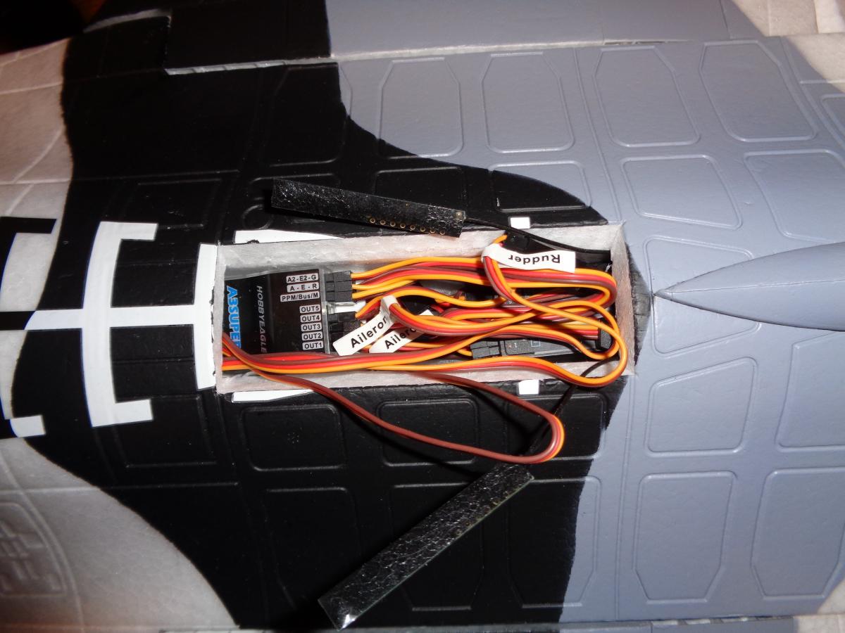

My own F-16 is progressing. I managed to "stuff" all the wires in. :Silly: So I was able to do a full up test tonight. All the flight surfaces are working with the A3S3 gyro. And, I've got her balanced at 3.5" with an Admiral 4000 all the way aft. AUW is sitting at 3.5 lbs empty. She's a bit heavier (4.8 oz) due to the FPV gear in the cockpit area. That's why I had to move the RX and Gyro aft. I can now glue in the tail surfaces. And, fix up the hatch that covers the gyro and RX. Then it's taxi testing and waiting for good weather to shoot for the sky. Gonna be excitin'! :Scared:

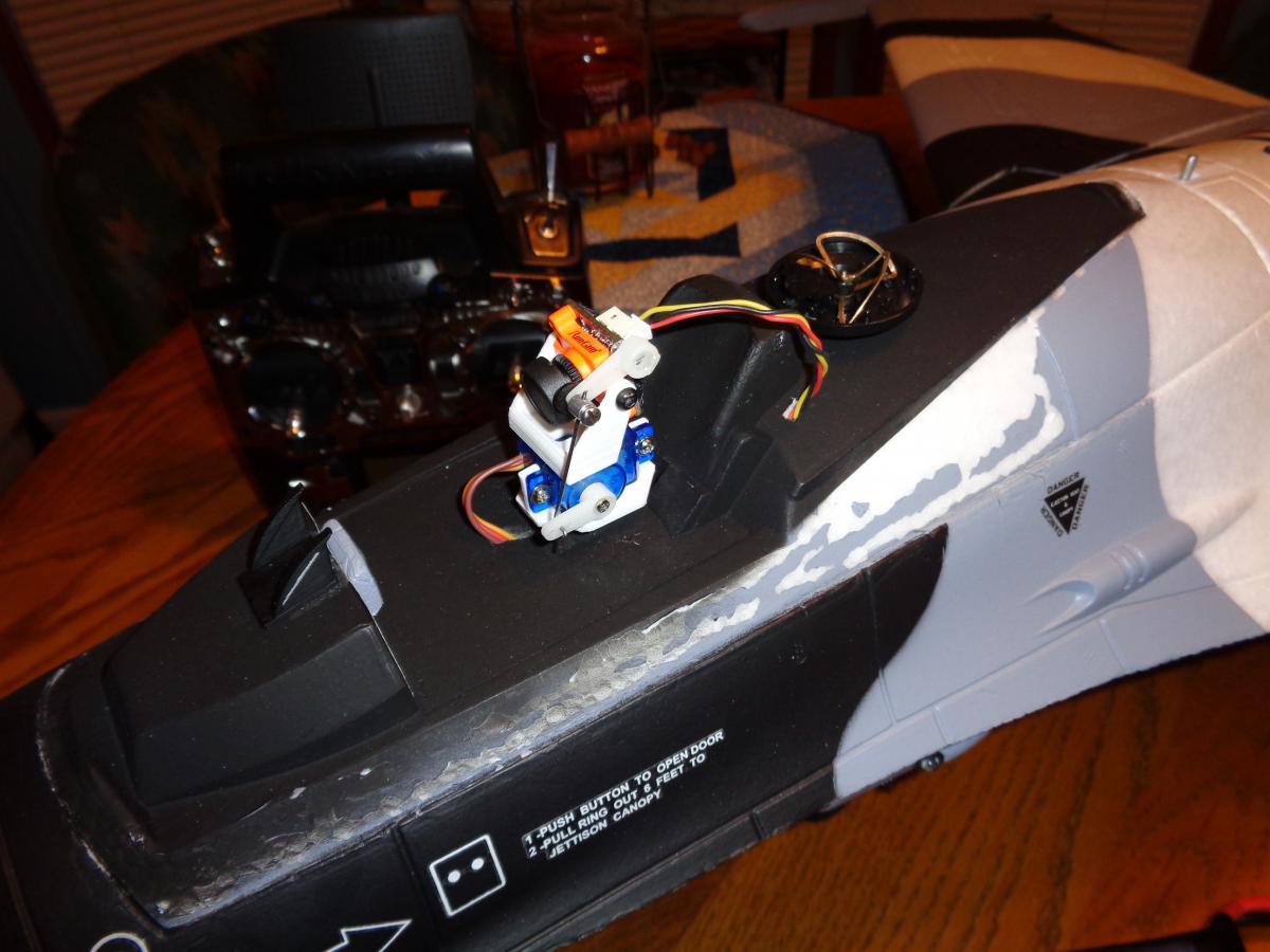

hey prowler, what camera setup is that? I've been wanting to do the exact same thing to my 70mm f16 lolAwesome flying, John. Looks like you've gotten her figured out. Those landings were real nice.

210foo, that is a RunCam Micro Sparrow. I'm running it with an Immersion RC video TX, and a Foxtech Breeze OSD. There's also an onboard DVR from HK. The canopy is surprisingly clear, and even the slight tinting is not noticeable. :)Comment
