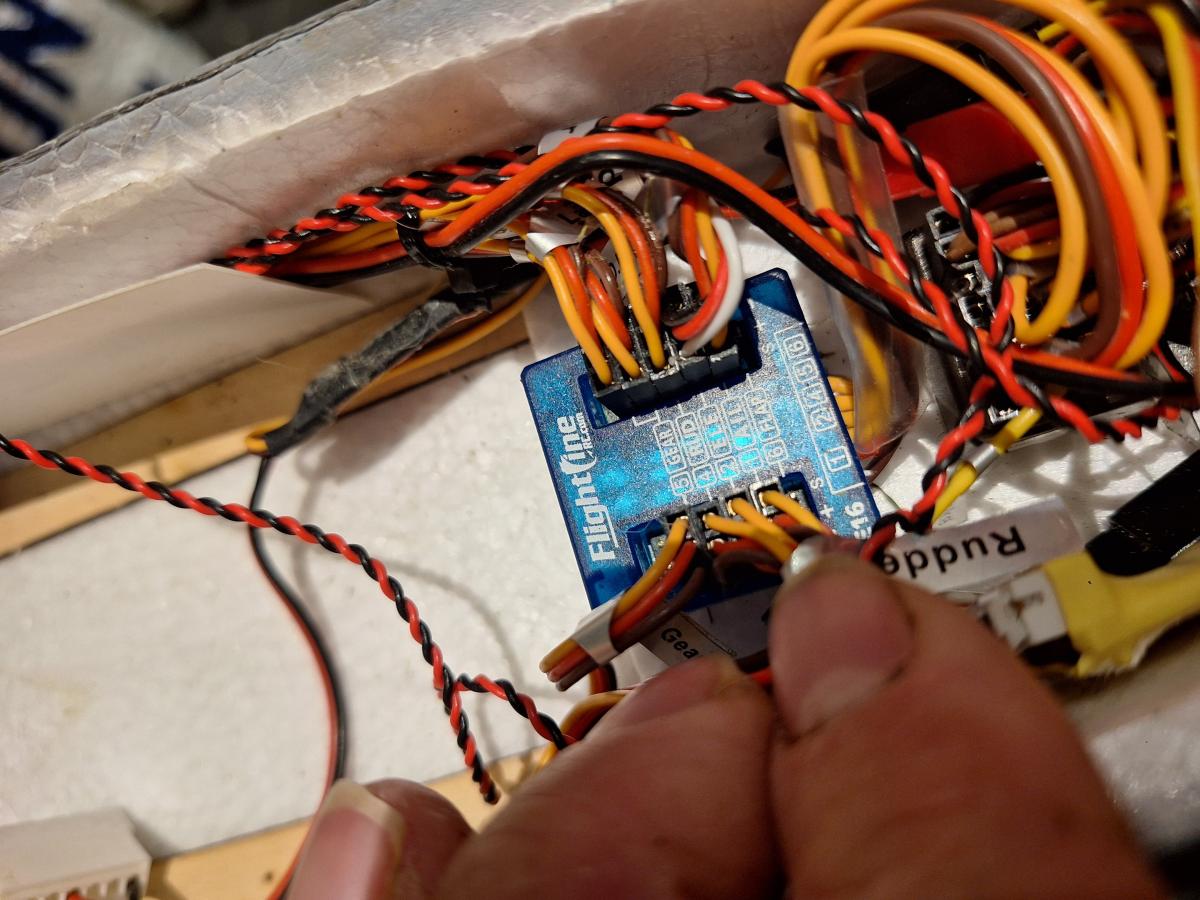

    Originally posted by Reptielenfreak
    So i was thinking about doing the mods that Jon did on his YT channal.
    Flaperons and ailevons. I was looking at the control board but it has for some reason 2 leads going to the rudder, so this would lead me to think its for the nose wheel, but gear also has 3 leads. Can anyone explain?
    I will put the ailerons on seperate channel and the elevators on a seperate channel, the rest will remain in the control board.
    Click image for larger version Name:	20241111_062538.jpg Views:	0 Size:	134.2 KB ID:	413625
    I only run tailerons so yes you will need 2 channels for ailerons ( flaperons ) which I don’t feel is needed your gonna alpha it in anyways and it floats very well. Tailerons again 2 separate channels which changes the flight characteristics to me in a very positive way. On your rudders yes one is for the rear rudder the other for the landing gear steering servo which you can use another channel if your running a Spekrum AR+ receiver for a nose wheel gyro which I personally like. Makes tip overs much harder to do which the F16 does pretty easy with narrow landing gear. One mod I have done on both of mine are to replace the front 3.1mm pin retract to a 4.1 ( I used a Mirage retract and knuckle then drilled the lower strut to accept a 4.1mm pin ) if your on grass you’ll understand why I’m suggesting this on payment most likely at some point you will as well. Either way good luck hope all works out well for ya
    Gear is retracts, you have three..

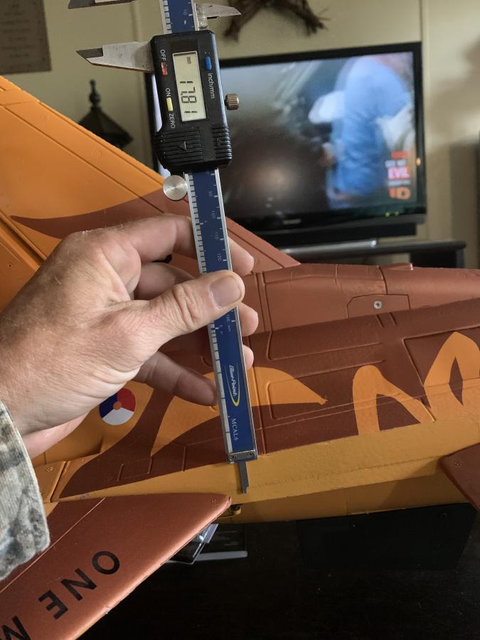

    Hey, my V2 manual that shipped with my V3 70 mm F16 has a sticker on the full-elevator horizontal tail install position of 18.5mm from the top of the fuse edge as neutral or center position...That can't be right...right?

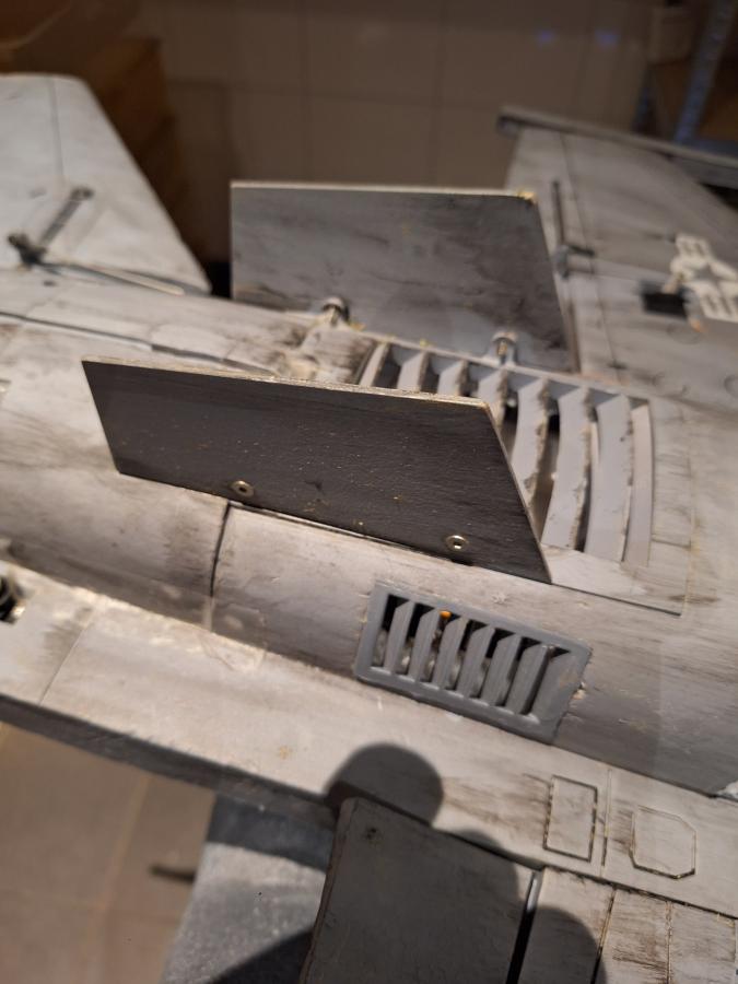

  • shortround91
    Working on the newest 70 F16, spring cheaters installed waiting on a new canopy and horizontal stabs. Old ones have a few spots gone this far might as well finish things right
  • Reptielenfreak
    My extra vents
  • shortround91
    Thank you planning on installing a set on a Mirage too if it sees part of the performance the F16 has should be a amazing mod
