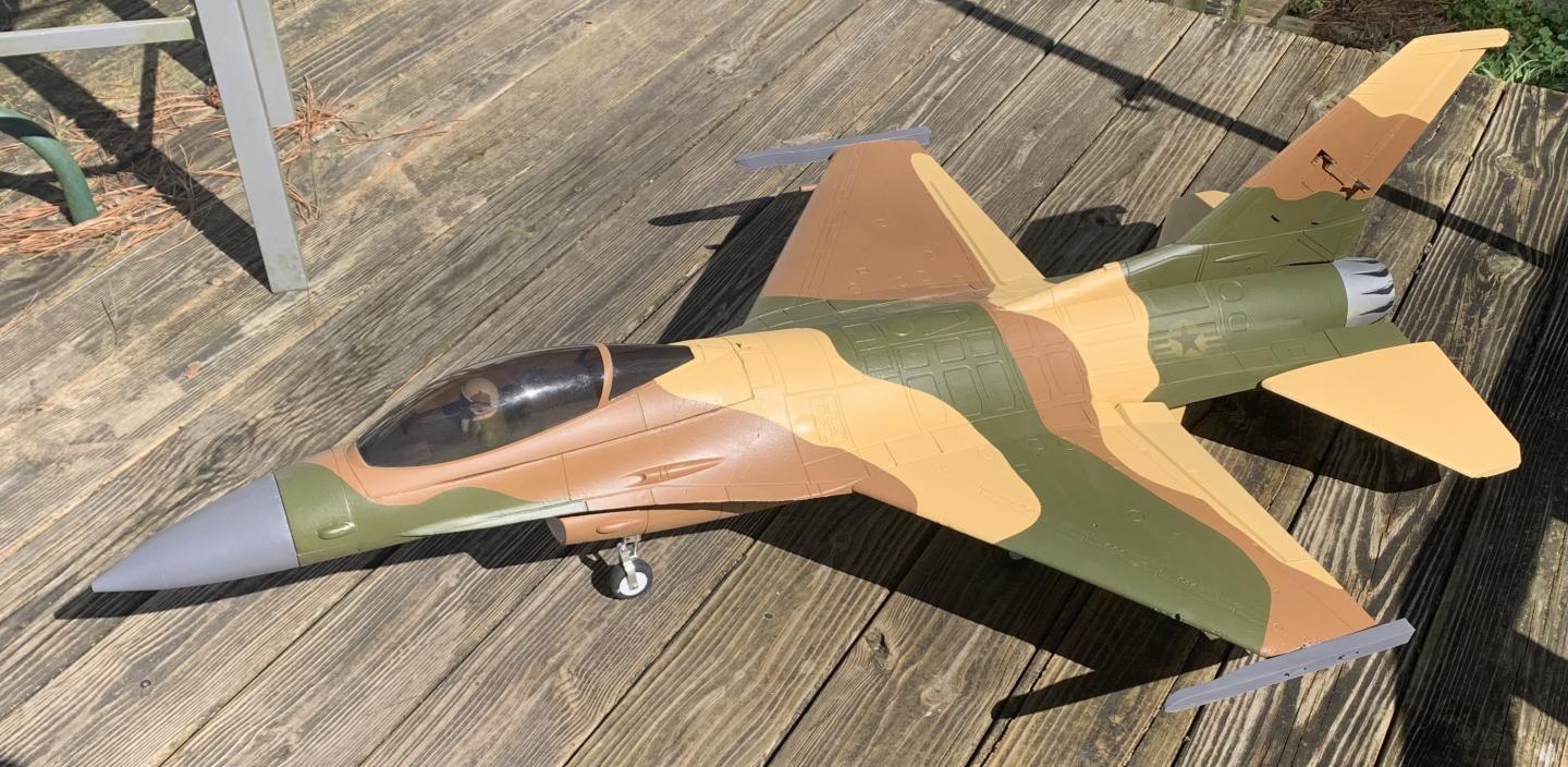

    That’s some great improvements, did a refinish last night I made a short video but won’t allow me to share it here. My take off to rotate has dropped almost in half shocked the hell outta me when I was testing along with a huge performance difference. Verticals are amazing now just straight up and up along with the doors being spring activated not changing the overall look
    looks very clean!

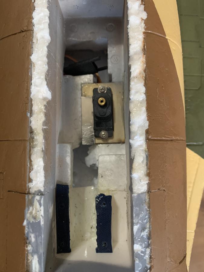

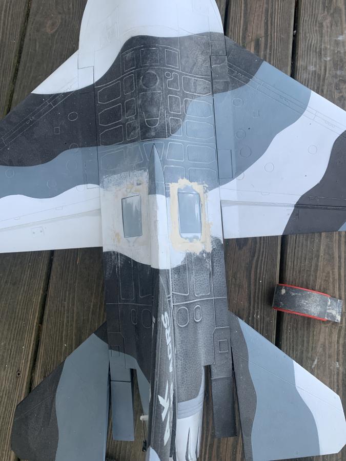

    Finishing up a modification to add a little more performance to the 70 V3 F16, works excellent thought I’d share. You will need to remove the ESC wood bracket and mount the ESC vertical I made some foam supports that have it help in really nice secure. I used a set from the J-10 where I got my idea from
    Also a good option, i added the vents from a fms f16 and put in on both sides like they did on the fms and the eflite f16
  • shortround91

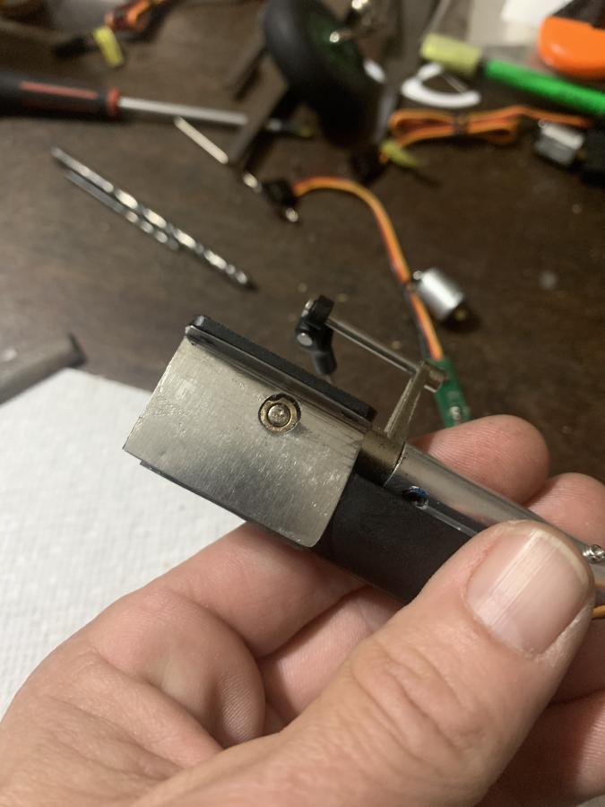

    Has anyone measured the diameter of the FW 70mm F-16 stabilator rotating rod yet? I'm attempting to drill a hole into the fuselage body with an "AE" standard drill bit. Example... if the rod is 5.1mm then the "AE" bit should be 13/64 etc. Please advise?
