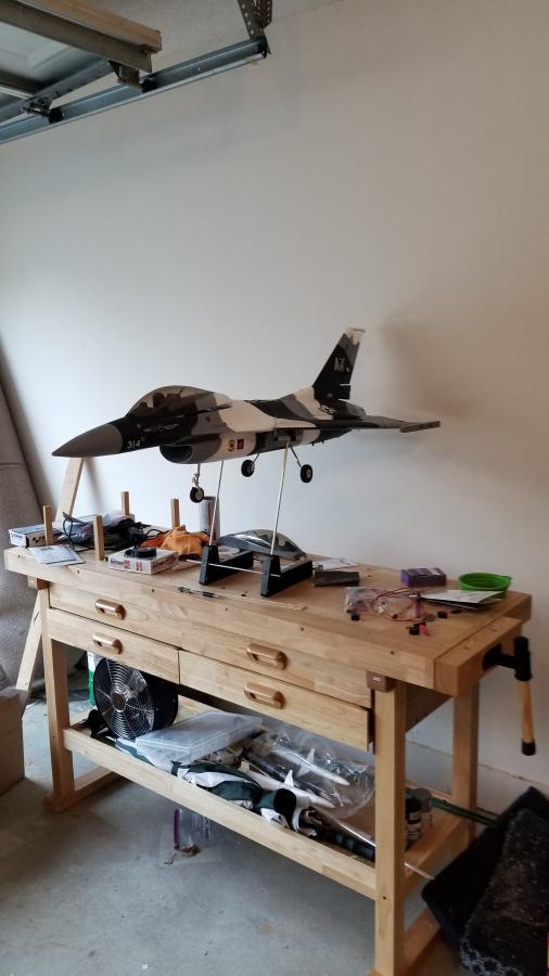

          • Got her put together and on the balancer today. Got it just about right where it should be I think. Can't wait for good weather hopefully this weekend I can get her back up. Just from taxi around it is night and day from the 4s power wise. Should be fun.
            • Originally posted by Hawk4me View Post
              Pretty sure you want to balance with gear up.

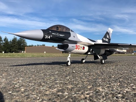

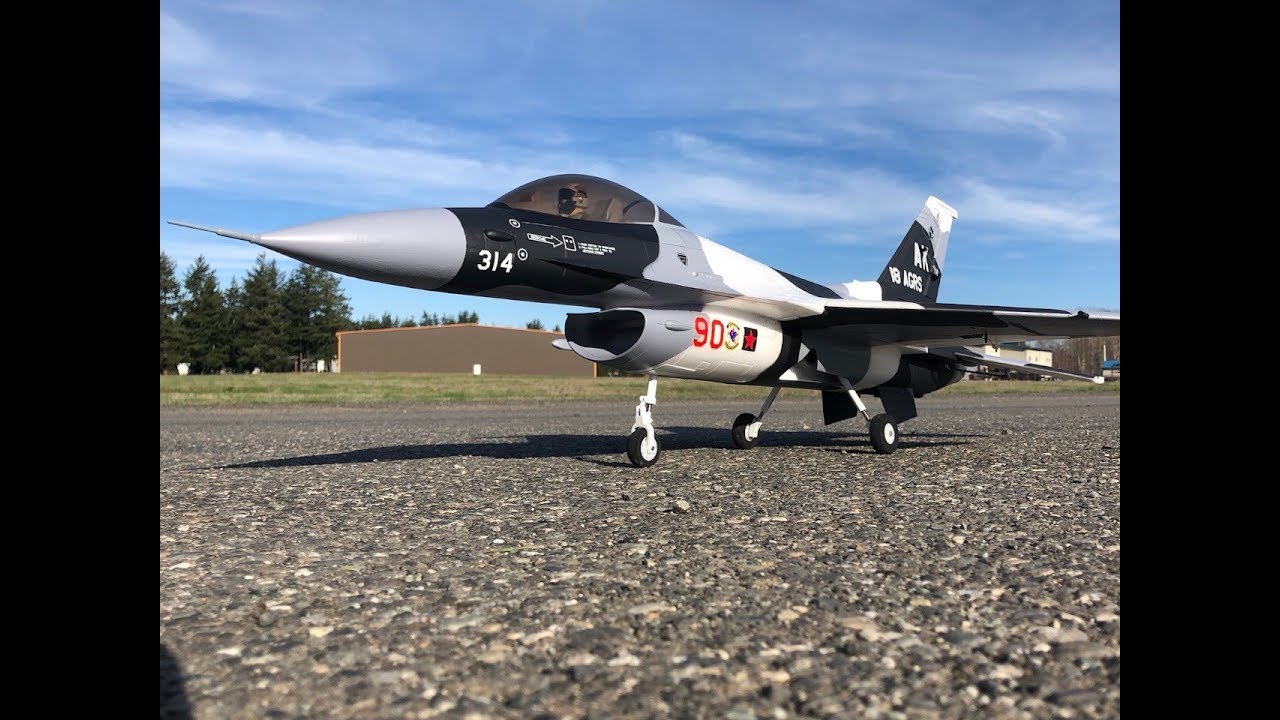

                              • First two flights on the 70mm V2 F16.. That second takeoff though!!!
                                • Awesome flying! Congrats on the successful maiden! :Cool:
                                  • Very nice flying and great camera work!
                                    • Looks great John, and that's the maiden flight!! Looks like some great flight ahead.
                                      • Thanks all! Pretty excited to get it out again soon.
                                        • I already commented on it in the fb edf group, but I had to give props again lol. Agreed, great camera work!
