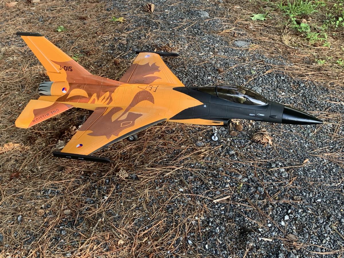

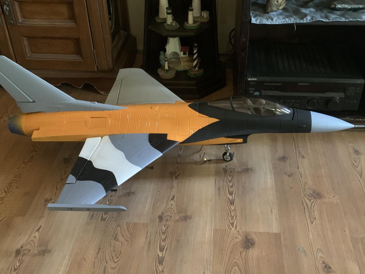

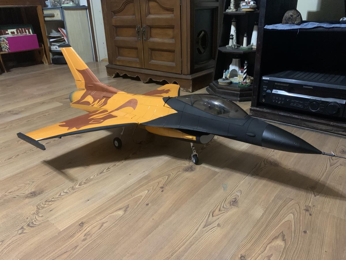

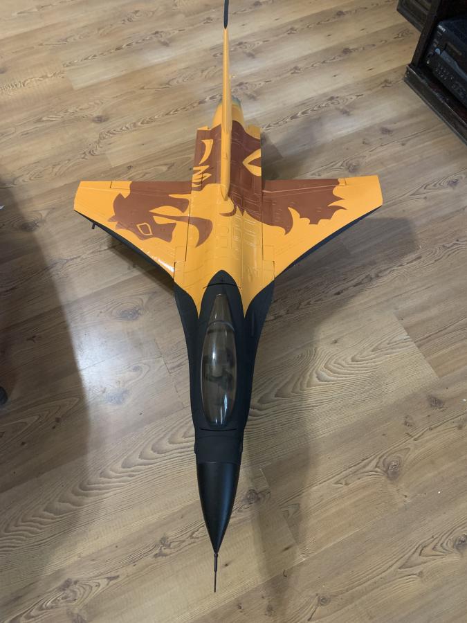

    Working on the newest 70 F16, spring cheaters installed waiting on a new canopy and horizontal stabs. Old ones have a few spots gone this far might as well finish things right

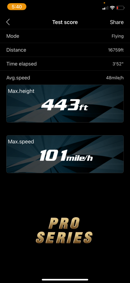

      Installed my cheater vents on the 70 F16 not sure what there usual speed is but I’m pretty happy breaking 100mph with mine
