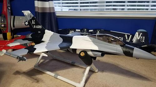

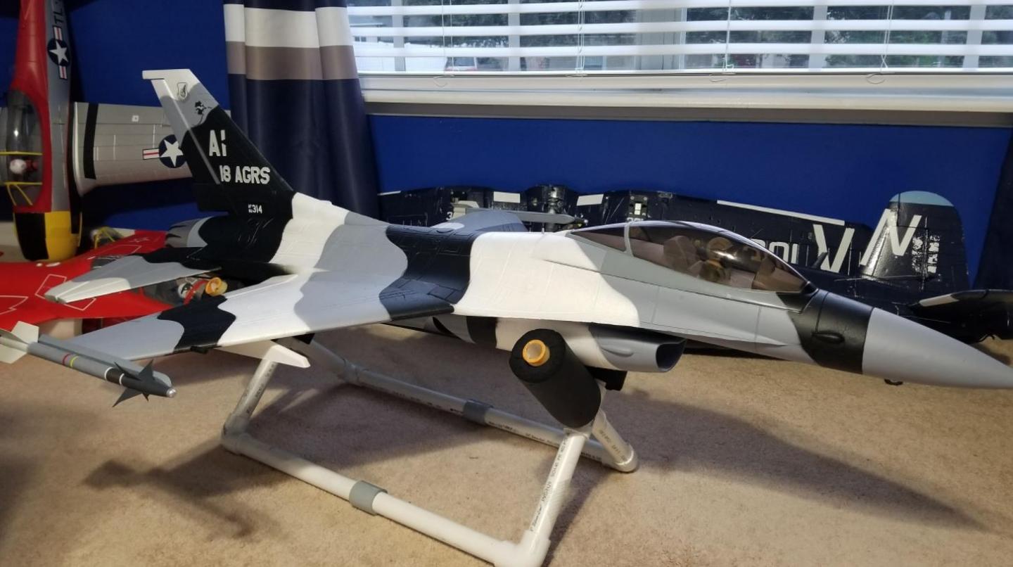

  • Well, I got the chance to maiden my F-16 Arctic Camo, this weekend, it DID NOT go well at all! Preflight checks (including range check) proved all was a go yet. After I cleared the runway on takeoff, I started my turn crosswind on climb out, I immediately noticed I didn't like my low rates (ailerons) and went to mid. Climb out was looking slow so I went ahead and pulled up the gear, as soon as I hear "gear up", she went down. A few guys at the field say it had to be the receiver but I can't prove that. Post crash analysis did show that none that none of my EDF/ESC connections were not taped or still connected for that matter. That would explain the engine loss but I don't know. Who knew that your ESC is moving around during flight!?! New fuse, wing, and nose gear, and nose cone are already been ordered. A3-L Gyro was working fine as she didn't tip a wing, just went down level. I was liking the fact that I went for the 10 channel Admiral, because I had/have my Gyro set up for remote gains and I can still do flaperons in the future...we'll see. I might go to a different receiver. Understandably, I'm little heart-broken at the moment, this was my favorite jet and I hadn't even gotten to fly her yet! I put the Yak up in the air after this to soothe my soul, it helped, but only a little!

                    • I just had a successful re-maiden (this weekend)...what can I say: "Thank you, Sir, May I have another" Wow she really flies. I flew my trusty Yak 1st and then took the plunge, by that time, I had the field all to myself (sorry, no footage). I see now the difference between the way she flies vs. the Viperjet. I'm using 4000mah 60C Zee packs (weight?). Batteries were positioned with the back even with the canopy cut out. I came down at 3:30 with 3.8v/cell. On the second flight, I went a little harder than the 1st. I love the way she loves to high alpha in the hard elevator pulls. I took off with 70% rates and immediately switched to 100% after that, just a few clicks of up elevator trim, and the rest is in the books. I needed this for a confidence boost after my crash two weeks ago. I was able to get 2 full flights in. Thanks again everyone for your help (Kallend, Evan D, anyone else I'm missing).. . I did cut the cheaters in the wheel wells and I ditched the Admiral for a 7ch OrangeRX. At this point, I couldn't be much happier...until I get my AB ring installed. I did still use the BB as I had no reason to blame it last time and all the Y-cables got to be a bit much. It was easier to keep it simple for cable management at this point although I may get rid of it later. Next flights may include sidewinder missiles on the wingtips and 3-D printed rails. I really like the look of the empty wing rails. I find that when we get afternoon storms, afterwards there is almost no wind and the field is empty by the time I can get there from work. Works out very well. Since this went well, I did go ahead and order a decal set, so I can get her looking scale again. Other than that, I'm looking forward to my next chance to get this bird up in the air, again.
