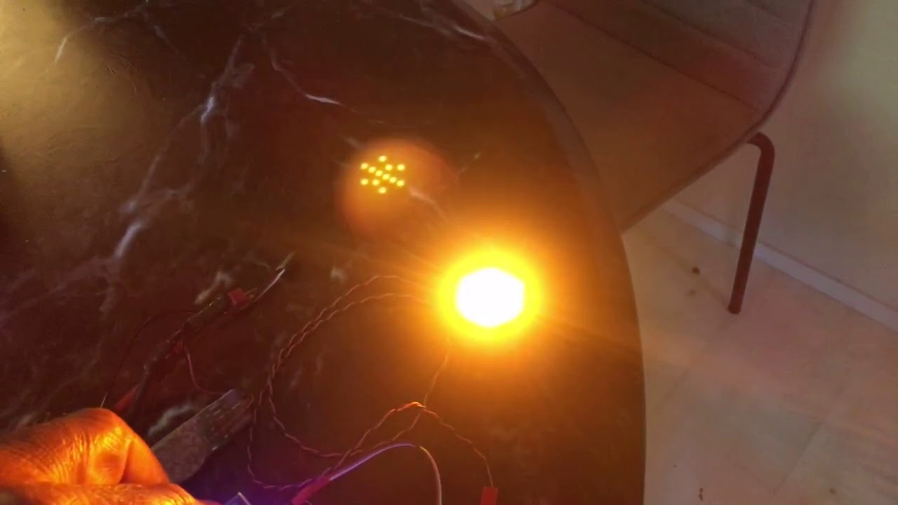

                            • Originally posted by The swede View Post
                              Hi guys!
                              Has someone a link to that afterburner some of you use? I think, I must have one :-)
                              Thanks and happy new year!
                              I have this set up in several of my planes. My F-16 was the second one to use this. PM me fore more details...
