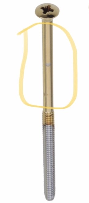

        • I just acquired the arctic camo high performance version from a fellow club member. it has the upgraded landing gear, and on the mains, both strut pins are bent so bad that it is unflyable. Is there anywhere to purchase just the pins, or do you have to buy the whole strut ?
          • Originally posted by scootergenie View Post
            The upgrades aren't that reliable. I had my share of frustrations. I just use anvil and hammer to straighten them out. If you are going to do that, use smooth hammer head so you dont damage the pins.
            Also, your nose gear will jam when the pin is bent... watch out and check your landing gear after rough landing. I already scraped nose twice.
            I didnt see pins in spare parts. Just find out what diameter they are and look for them online. Also can check other models spare parts section, you might find a match.

                    • You can take the pin to the hardware store and make a much stronger one from a machine screw. Just match the length and width of the non threaded part. All you need is a grinder or dremel. Worst case scenario is bolt cutters and sanding...
                      I've done it before, but the retract cases are then the weakest thing and will break first next time.
