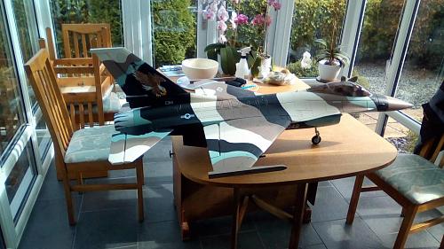

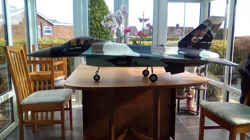

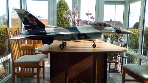

      Timing normally works on low setting, try going back to low, then calibrate the throttle lever/esc again.. I had fun after trashing the fuselage due to brain failure and some blue box channels did not work so I scrapped the blue box and just used Y leads, retracts etc now work fine. fan works fine

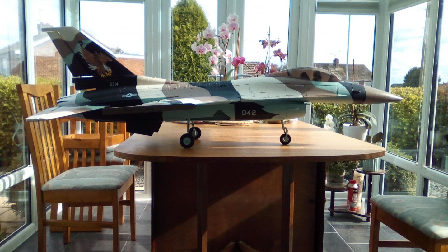

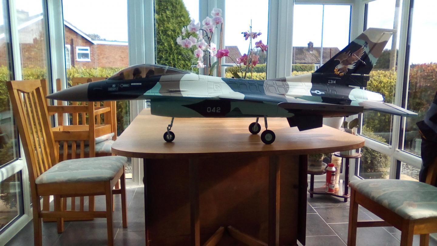

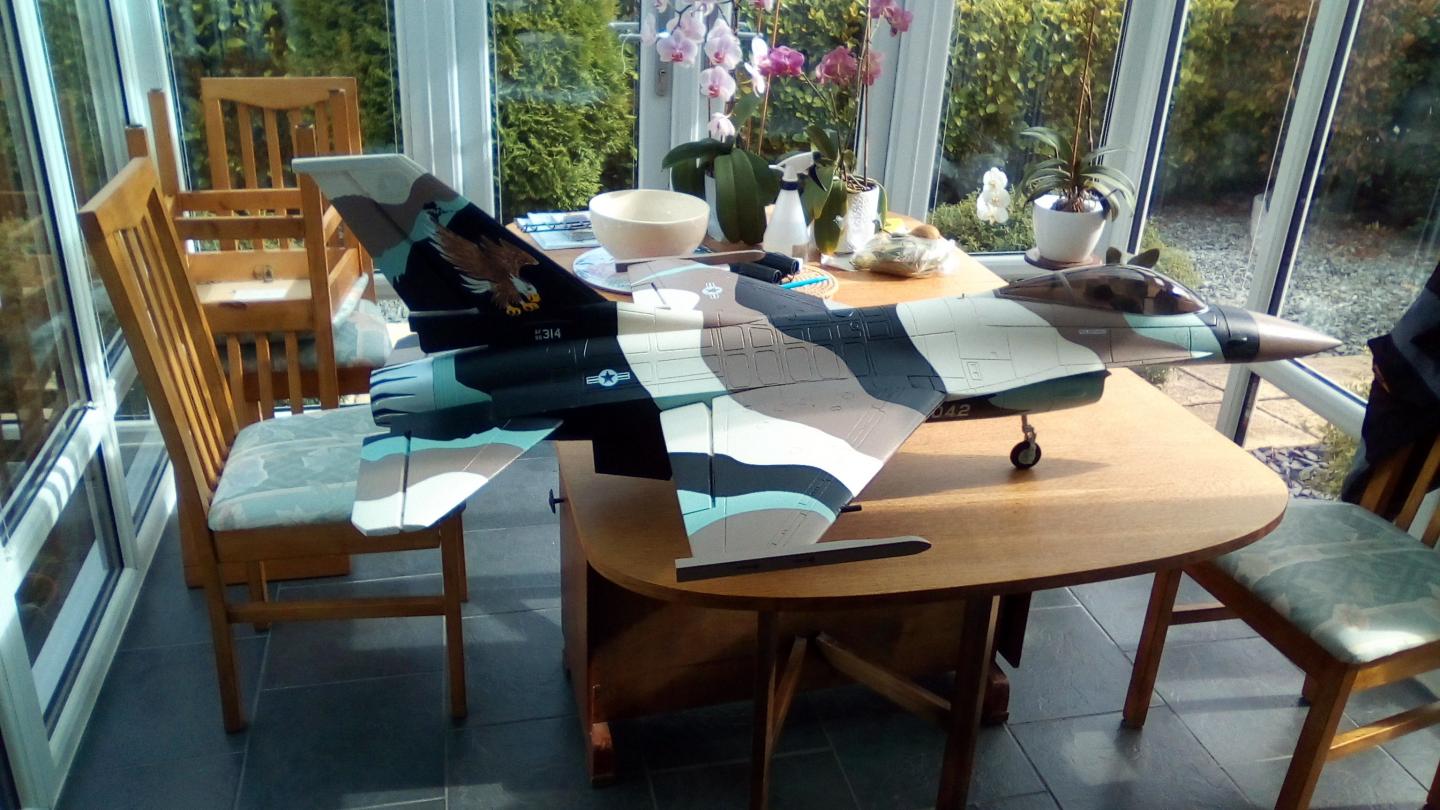

      ( FMS70mm 6s 12 blade pro) I fly off grass and put in a flap /aileron mix, 1/4 inch take off, 1/2 inch landing. I took the opportunity for a bit of a repaint at the same time as per photos attached

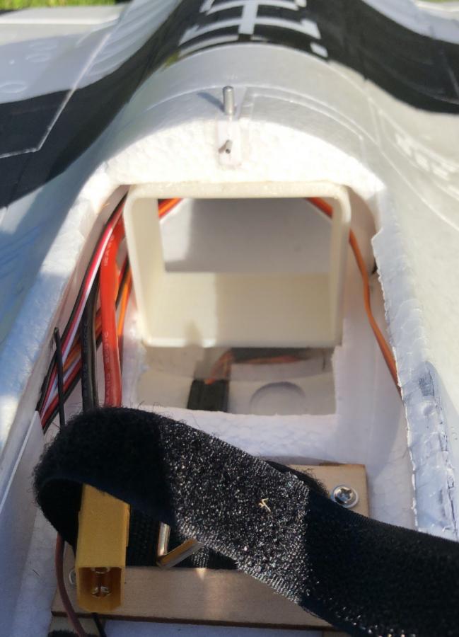

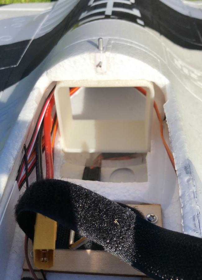

      • Here is a picture of my battery support for my 4000mah batteries. It is glued in the "roof" and I use different depron pieces to get a snug fit depending on the battery. Word of caution: Nothing but the shape of the depron-piece is stopping it from end up in the fan. Realised that just in time

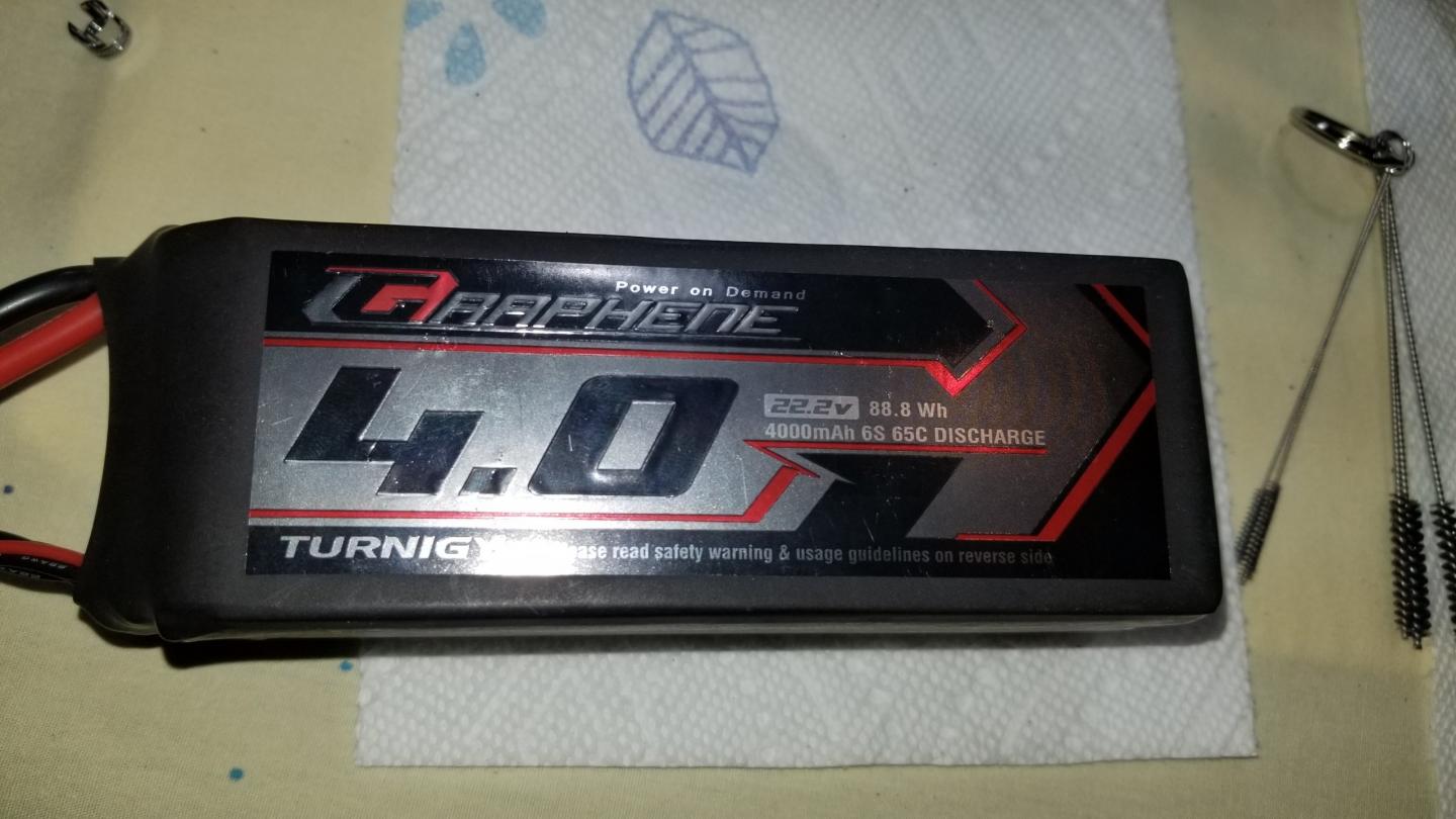

        • So I've read thru this thread and I see that some guys are adding tail weight to get CG correct. What CG are you guys flying at? By the manual 90mm, further forward, further rearward? The batteries I have currently are the Turnigy graphene 4000mah 65C, weighs in at 733g...Pushed all the way back, I'm still nose heavy. I'm trying to not purchase more batteries and really can't afford them right now. Will the extra weight be detrimental to the jet flying? If you added tail weight, where did you put it? Cheers!

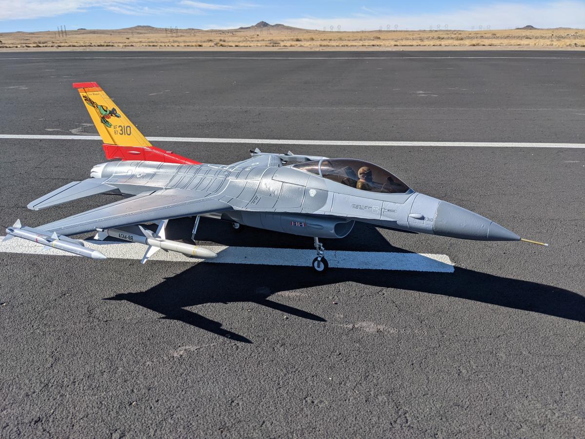

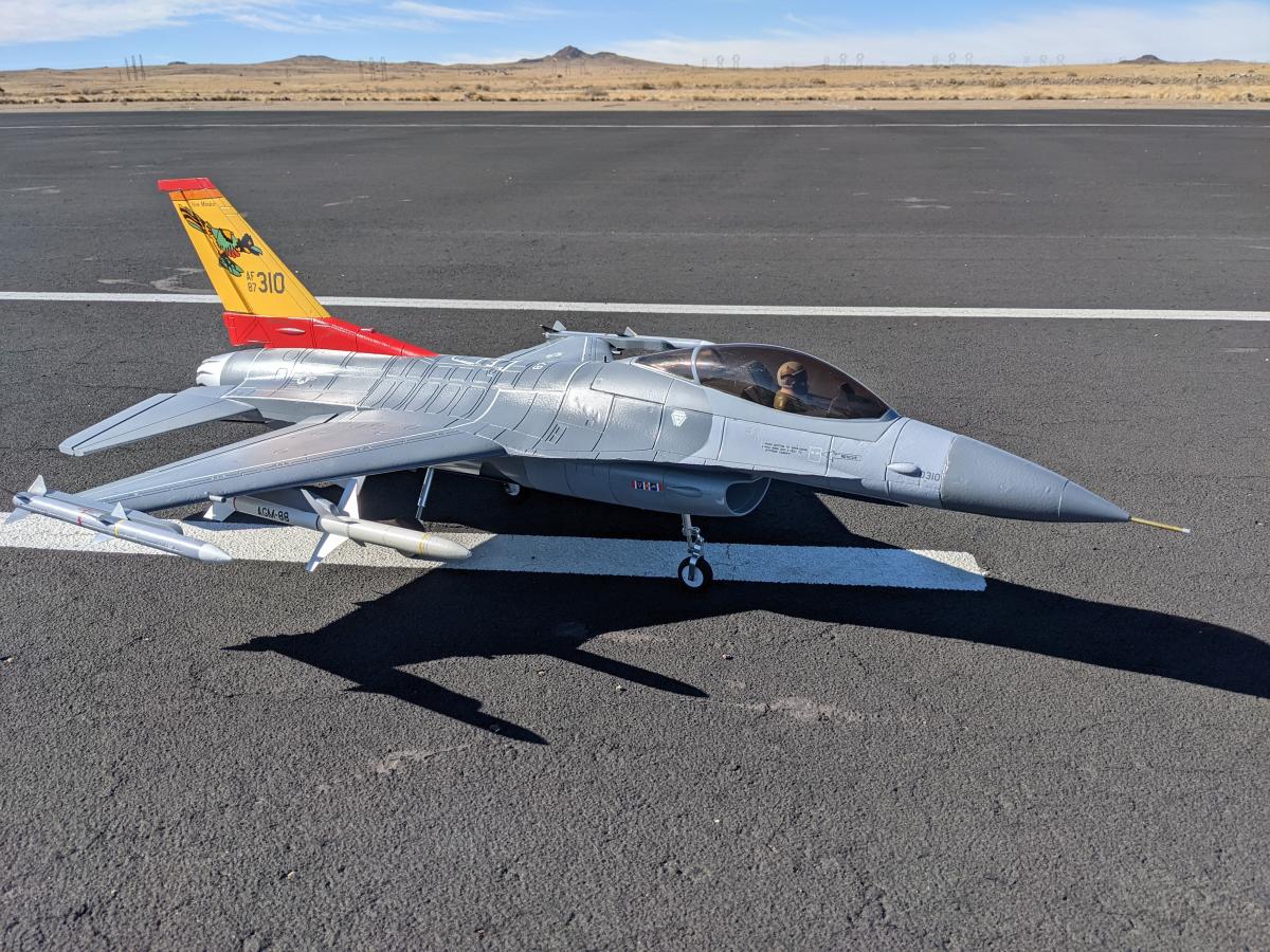

              • Range tested and just needs a few adjustments to nose gear before the maiden.

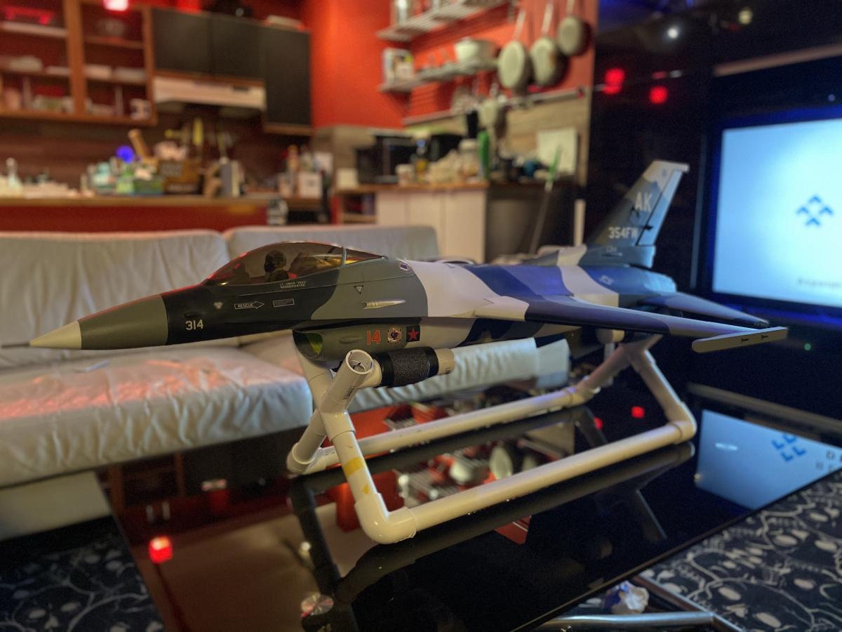

                    Good to see some peeps from the PNW on here! I recently bought the Arctic Camo 6s and am gonna be looking for some places to fly this Spring after ski season ends and I get some flights in on a sim and a trainer. I put some time into glassing and repainting the F16, so gonna take some tone before I take it out for a maiden. Would love to connect for pointers and tips! I’m located in Seattle
                    Cheers! OmeyDaHomey
                    • Yo fellow PacNW'erner! OmeyDaHomey feel free to contact me anytime! I'll be active flying again here when the weather shifts to Spring/Summer...Good luck, this is a fun jet!
                      • OmeyDaHomey Did you glass it with polyurethane?
                        • How much weight did the glassing add?
                          • SanExup and Mizer67,
                            I used Deluxe Materials EZE-Kote and their carbon fiber tissue to “glass” the top of the body and tail/rudder. Used their lightweight FG cloth to do the wings and stabs.
                            I also did a thin layer of their Foam Armor on parts of the the underside.
                            • Thanks OmeyDaHomey It looks smooth!
                              • Thanks SanExup !!
                                I’ll post some more updates/pics moving forward.
                                OmeyDaHomey
                                • Looks great. Still curious about how much weight it added.
