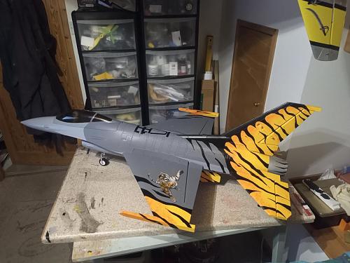

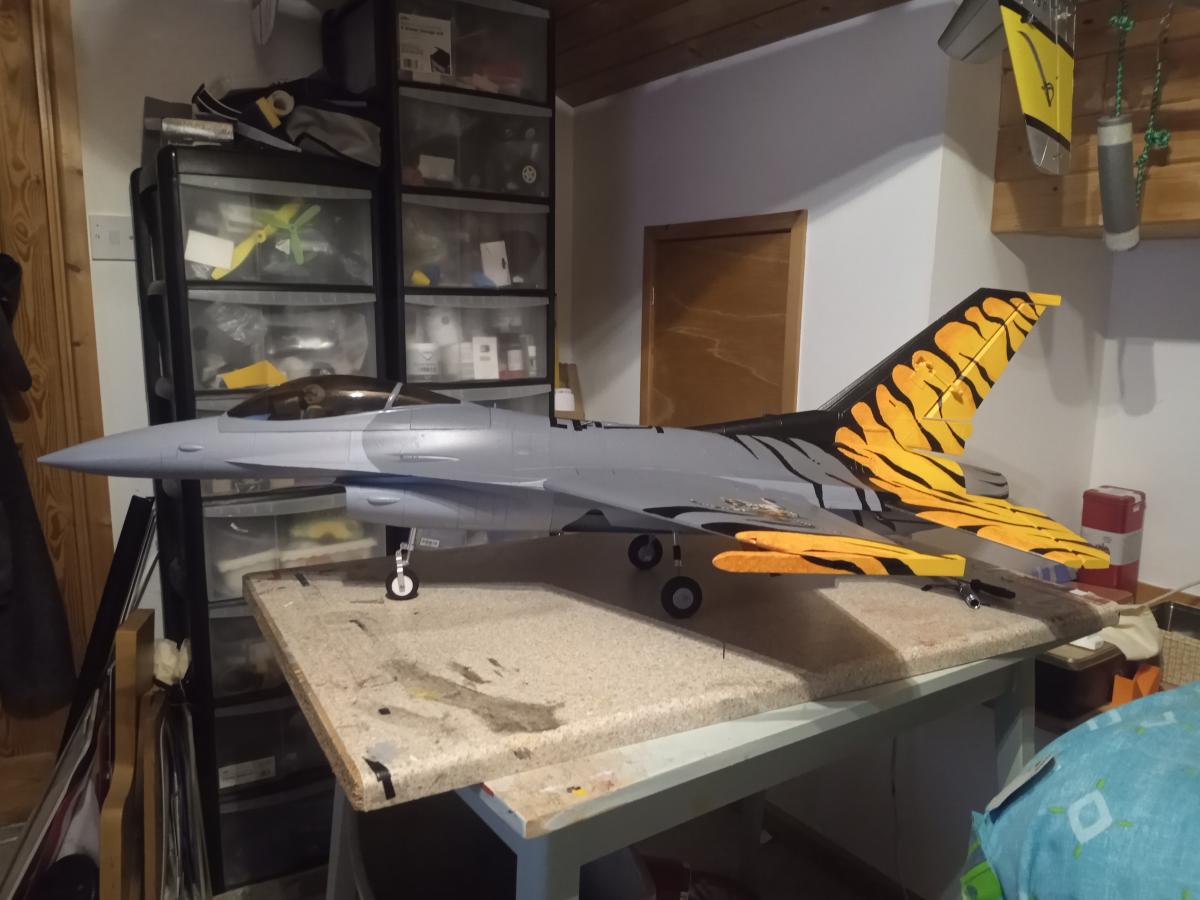

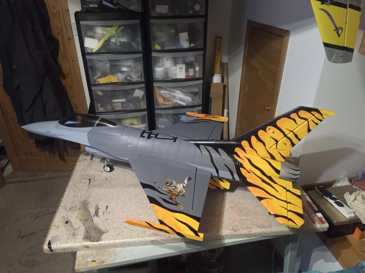

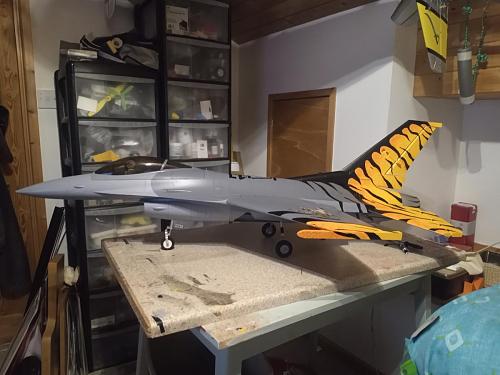

                        Good looking F16 and smooth flying. Earlier this year I put aside my F16 in favour of other models but my uprated suspension arrived yesterday so its now ready for a re maiden on Monday. FMS 70mm 12 blade 3060 1900kv fan and flaperons. I use take off flaps off our grass runway.

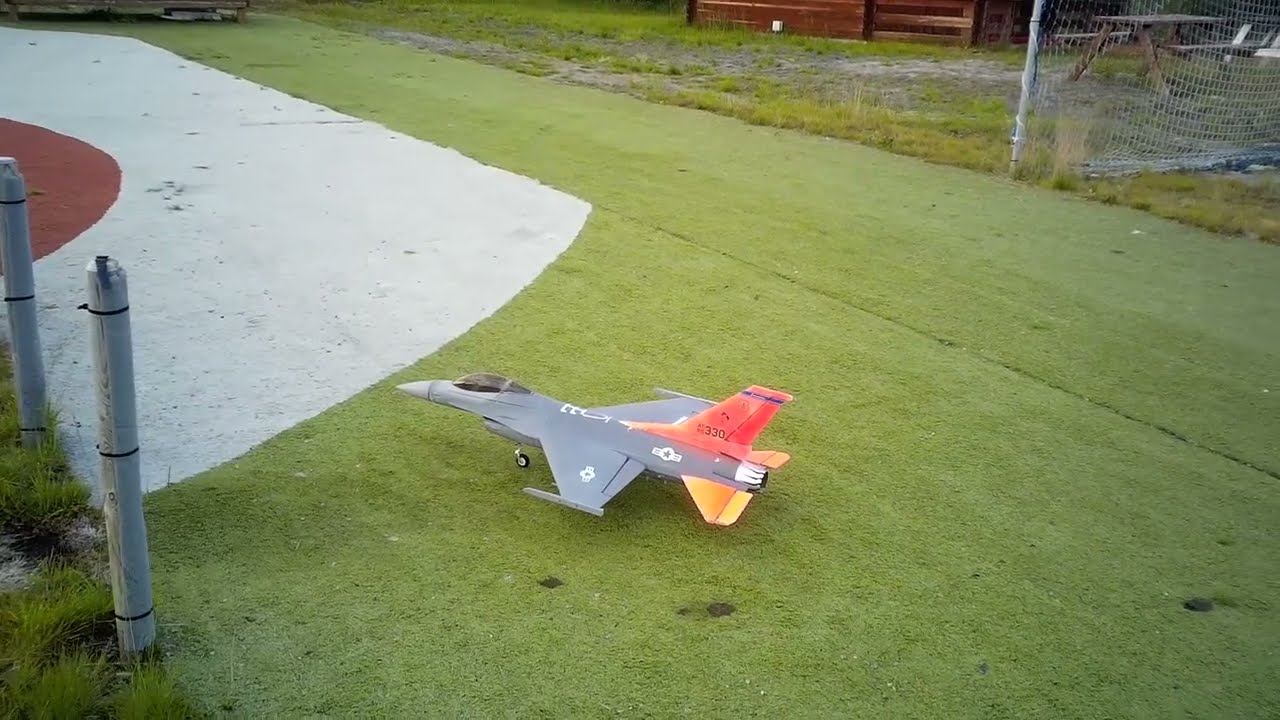

                          • Maiden flight of my F16 70mm today.
                            Freewing F16 Fighting Falcon 70mm edf jet with FMS 3060 1900kv in-runner, 12 blade fan, Turnigy Nanotech 3300mah 35-70c 6s lipo.3mins flight 28% left.Paint...
                            • Unlimited vertical wow.
