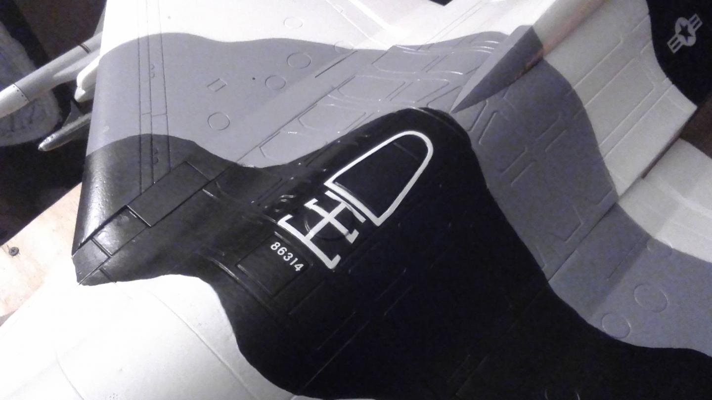

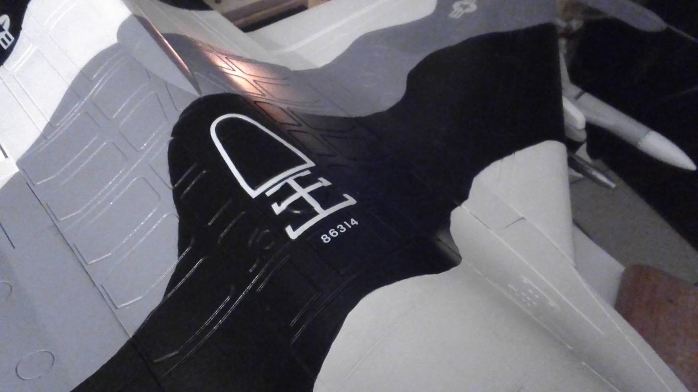

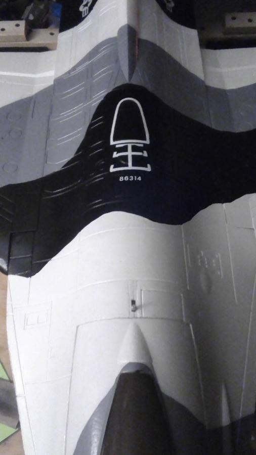

  • Whilst I was patiently awaiting the FlightReports from a few Fellow RCGroupies, I used the time to apply the 'Corrected' Graphics to the Refueling Receptacle on the FW F-16C. Hand painted and Decal'd. FreeWing decided to simply use the same Decal for both the 90mm and 70mm F-16. In my opinion, this was a Gross application of Laziness or a Terrible case of Inattention on their part. It's all better now !!...and, I'm Over it ! Hahahaha.

    • That outta do it ! Click image for larger version

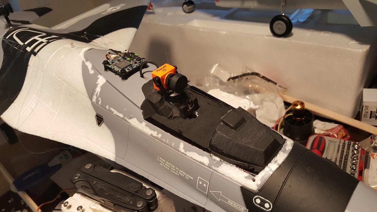

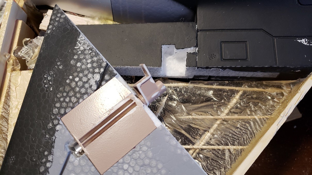

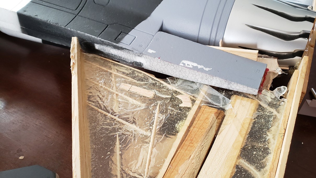

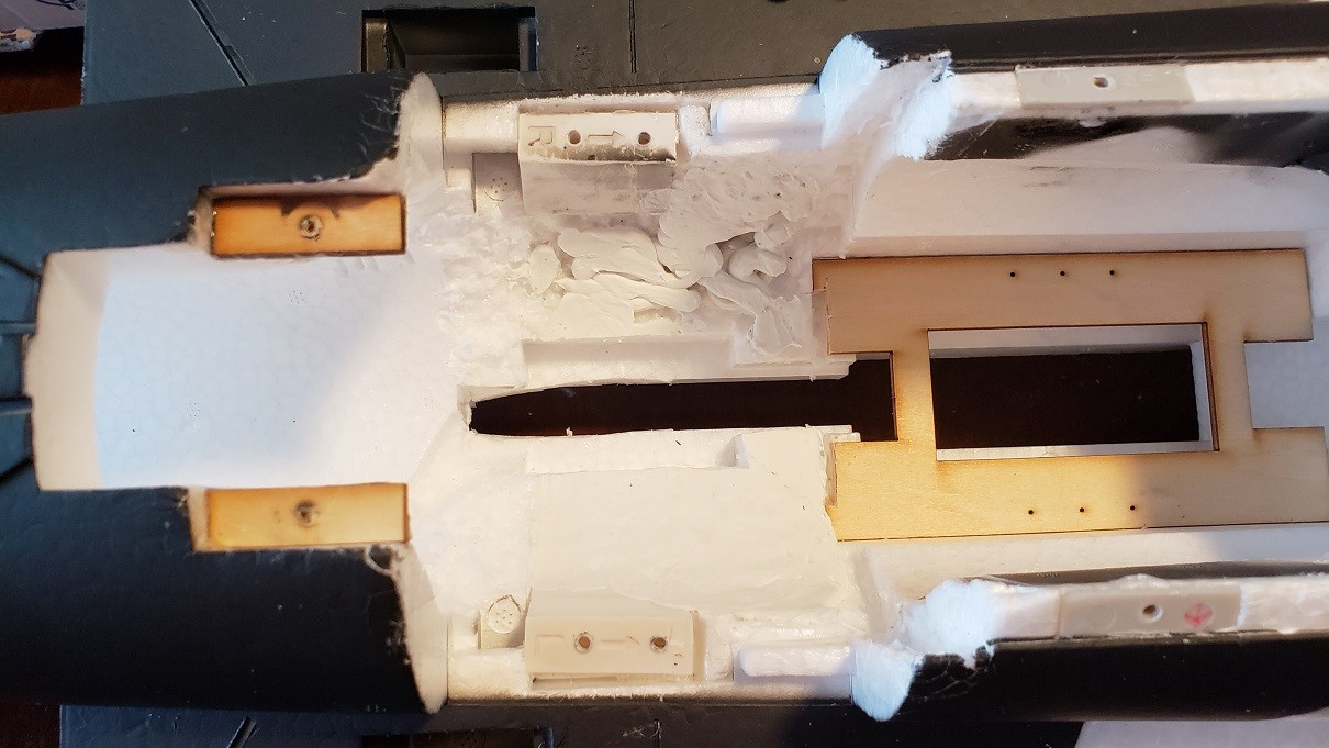

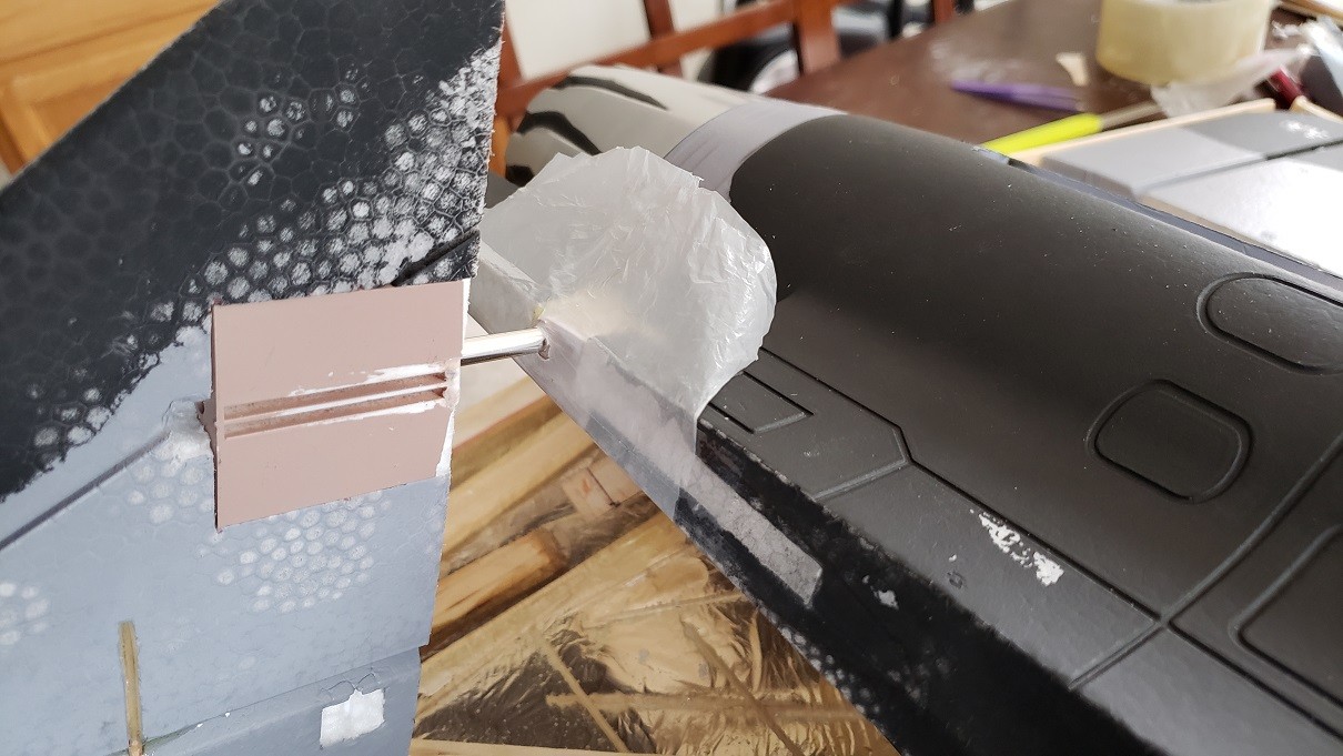

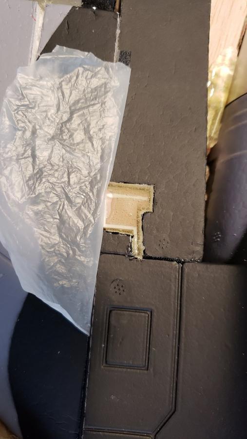

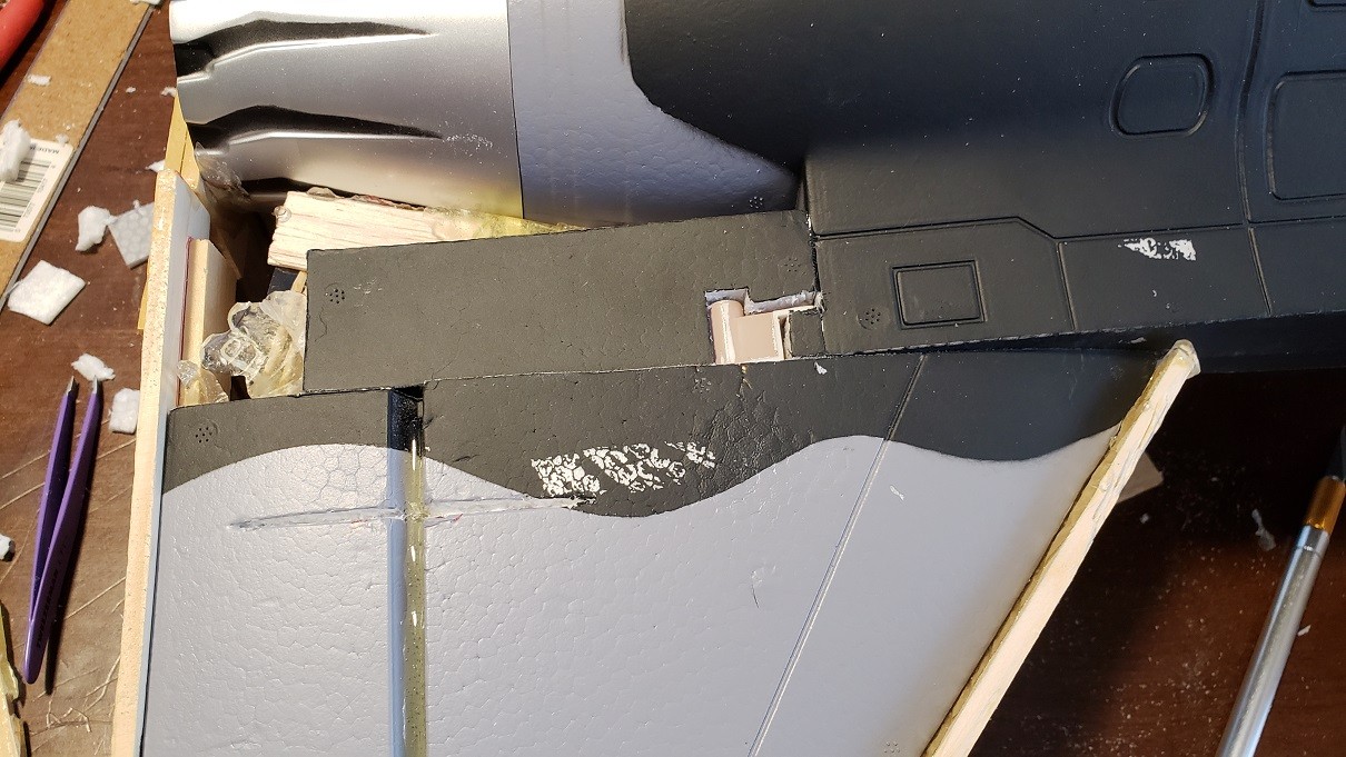

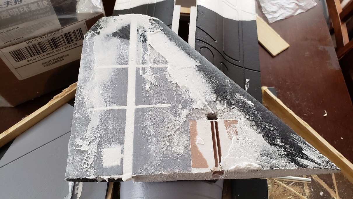

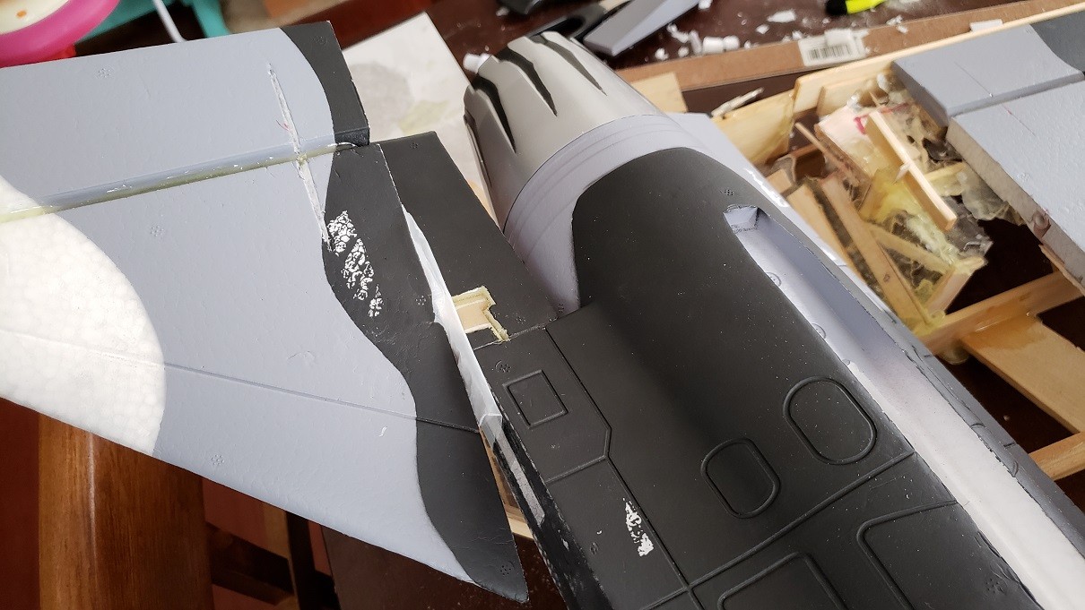

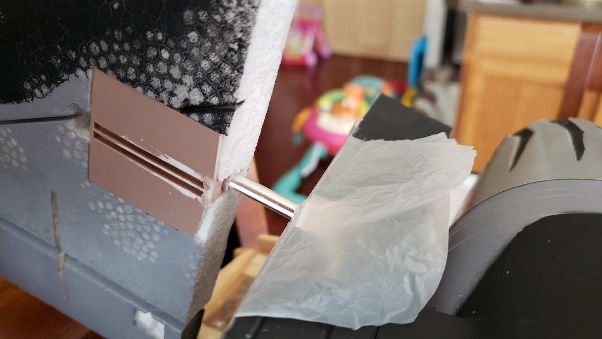

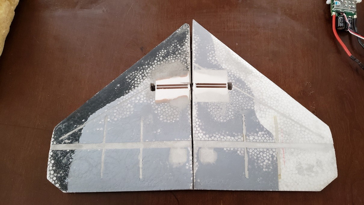

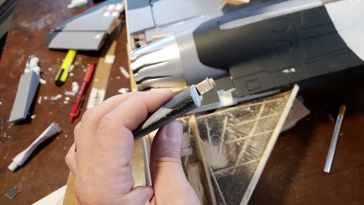

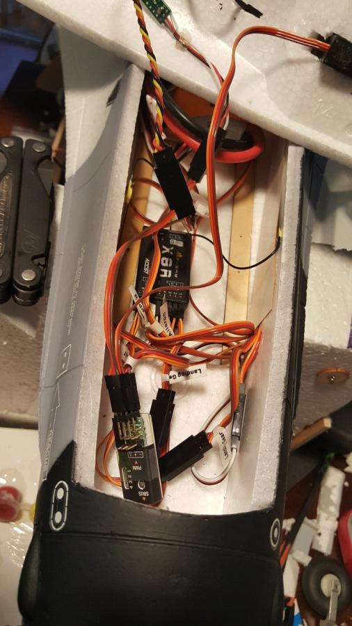

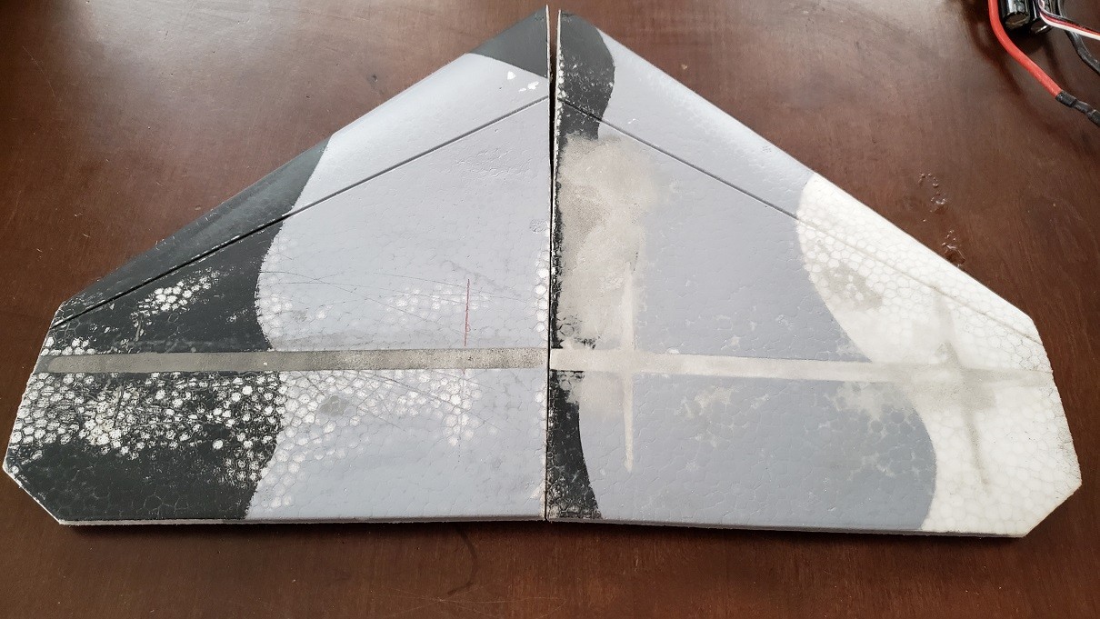

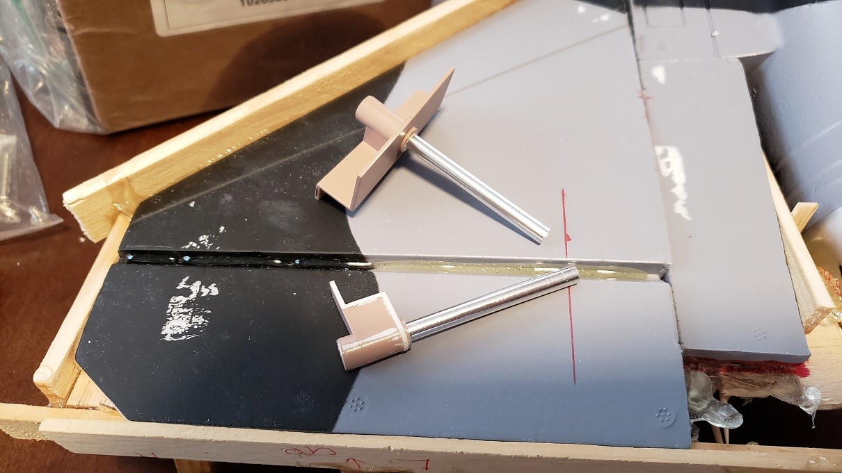

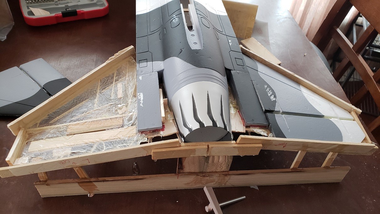

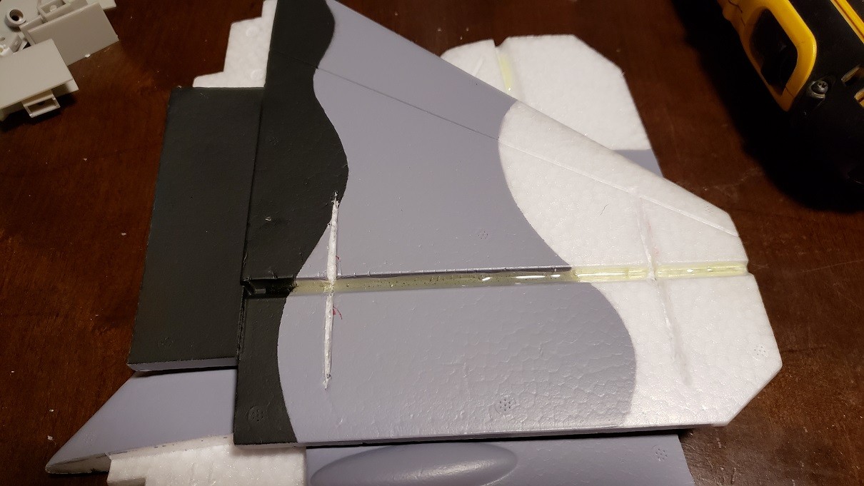

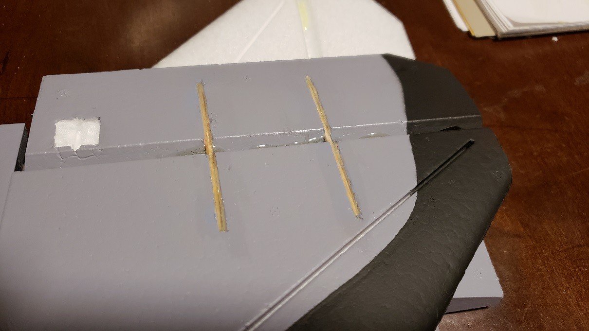

                                    I finished several mods

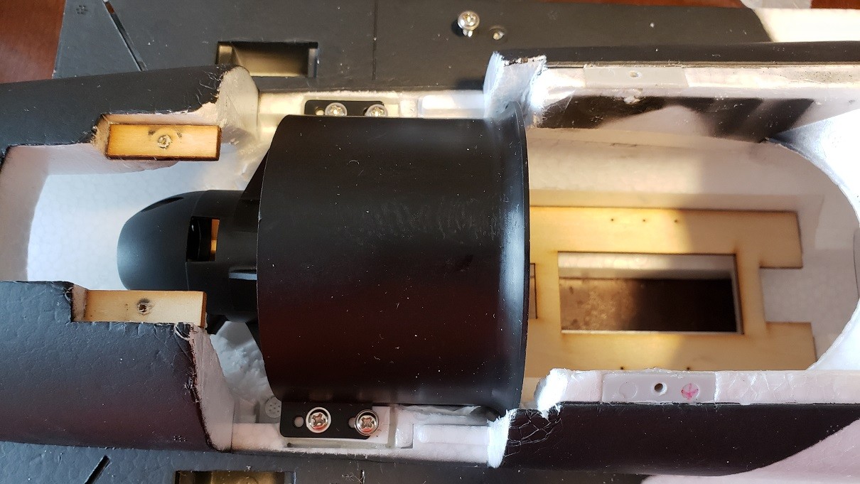

                                    Converted to 80mm 6s
                                    Horizontal Stabilizer (i took a bunch of pictures and short videos during the process to make a quick tutorial on it)
                                    Also did an FPV mod with Head Tracking.
                                    Dry weight: 1630g
                                    Sadly, thrust measured at 1716g
                                    I love how it handles, its a rocket ship for sure. First few flights i got about 6 minutes on 4500 Admiral and about 8min on 5000. I was just cruising around, nothing special. I am sure it's a bit heavy compare to stock 70mm but, with full flaps it comes down nicely, i like it. Landing gear "upgraded" still suck. i got tired of gluing the plastic cover as i have to remove it to tweak the struts.. no more plastic covers lol. I thought about a landing gear mod but you know, maybe i should learn how to properly land the plane ;)
                                    To make the mold of rear section i used epoxy and some scrap wood. I did that before i butchered stabilizers and the fuse. Took about a week between family and work but, it was worth it. After molding was done, working on the stabs was easy and i wasn't worried about screwing around with proper angles and placement of the stabilizers. I also solidified elevator in-place by using a bit of epoxy. Those were brand new and i haven't broke the "factory seal" or i haven't flexed them. Worked out pretty good.
                                    • FreeWing F-16 v2 70mm Converted to 80mm
                                      • Originally posted by Sam CS View Post
                                        i don't think that swapping out the stock fan for the 80mm metal housing 12 blade fan is worth the effort. I do however completely agree with using the 9 blade which I see you did. I had been wondering how it would work in the F-16 airframe and now see that you have done it. It looks to fly pretty good! Good job on the upgrade!
